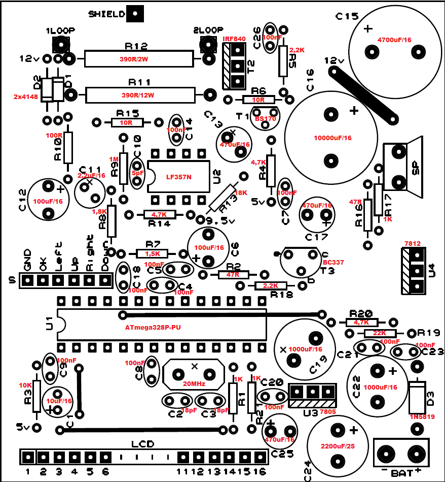

      • Hello Berte,
        i have inserted comp. values in the image from build document. You can use 4700uf for C26 or 10000uf.

                      • i did one pcb yesterday project seems interesting pi with two tone is nice- seems to work
                        • There are multiple sound options in the menu, I still haven't checked them all but some sound really nice.

                            • Hello daverave,
                              i get about 28cm in air for a 1 Euro coin with a 25cm coil. It has a diameter of 25 cm, 362uH and 1.7 ohm instead of the recommended 1 ohm. Yesterday i did a first field test and had problems because of false signals. But at least i found a soup ladle in about 15cm depth. Sorry, i can't give you more information at the moment. I hope to continue testing next weekend.
