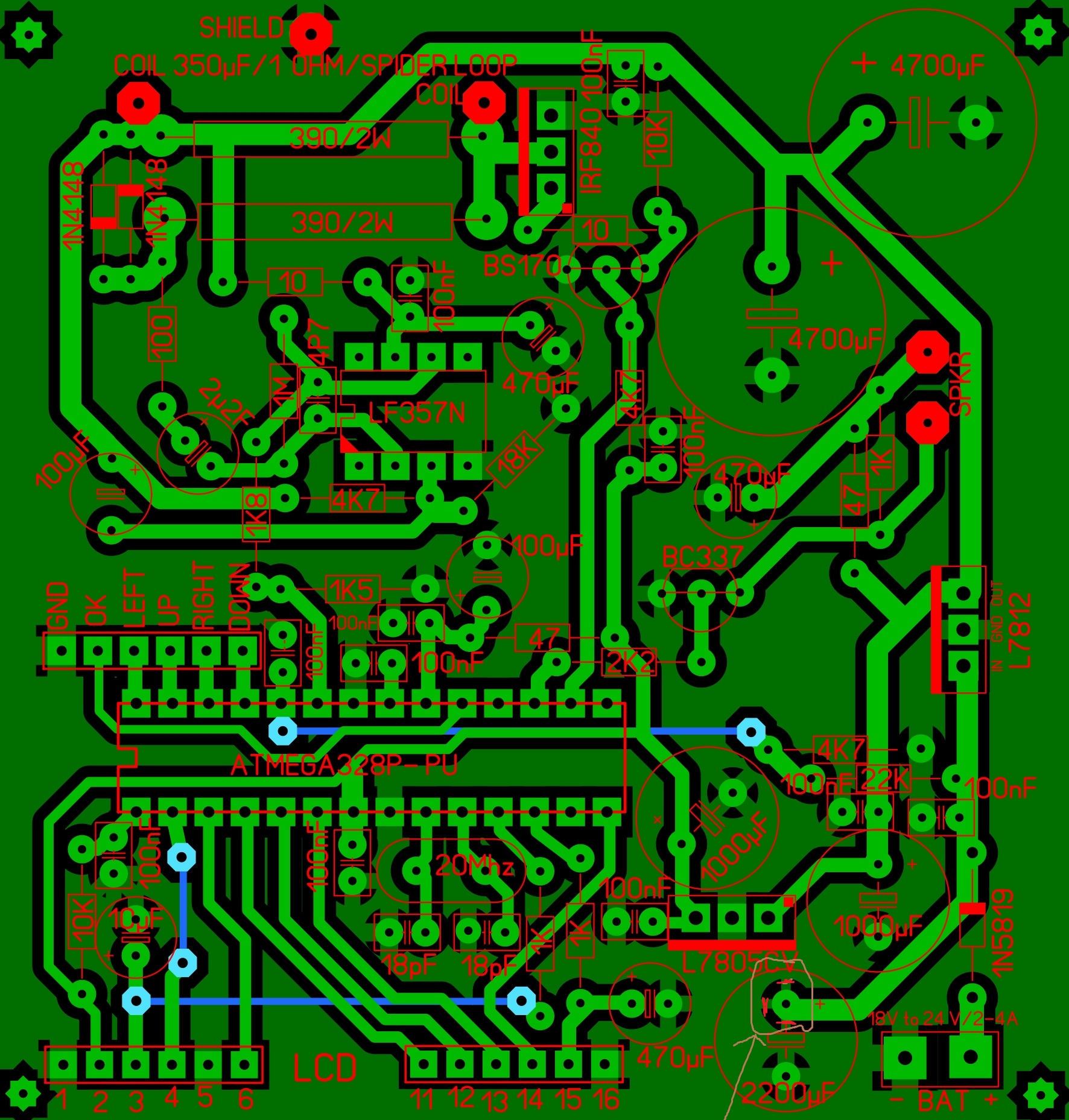

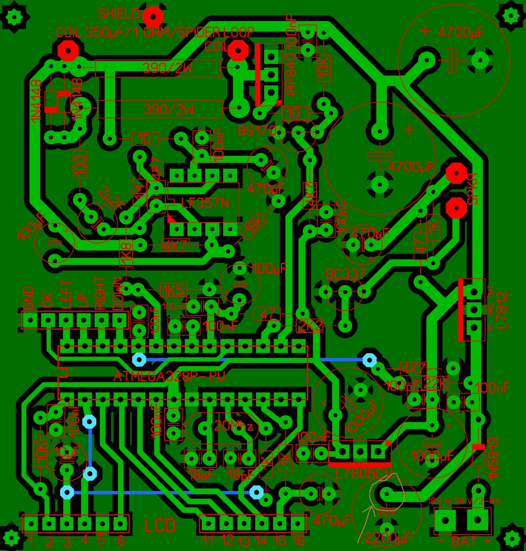

                          • error in pcb made by sprint layout typon 2 and 2 variants of this with isp are shorted Click image for larger version
ID:	348415Click image for larger version
                            • Originally posted by chafik View Post
                              error in pcb made by sprint layout typon 2 and 2 variants of this with isp are shorted [ATTACH]39641[/ATTACH][ATTACH]39642[/ATTACH]
                              Your R5 still use 10k it should 2.2k
