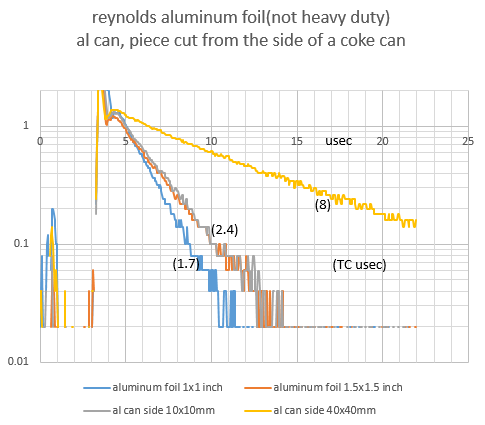

        Hi Eric
        Thanks for testing the 1x1 aluminum foil. Wondering why you couldn't detect the 1x1inch but could detect the 1.5x1.5 inch aluminum foil. I charted their time constant plus a couple others. A 156kHz resonance, 1.5uH coil requires a 735 ohm damping resistor to critical damp. Decay time constant=.0015/735(2usec). Could the reason be, the 1x1 foil TC(1.7usec) is shorter than the coil decay TC(2usec) where the 1.5x1.5 foil TC(2.4usec) is longer than the coil decay TC(2usec)?

          Hi Green
          That is a great chart. The thickness of the 1.5” = 38.1 mm Coke can versus the thin 40 mm aluminum foil shows a big difference in amplitude / signal strength. And a big difference in the time constant is also displayed. It shows why the thickness of the metal is so important to the detection process.

              Hi Chet
              The coke can is 40x40mm and foil is 38.1x38.1mm. The 10x10mm coke can has the same TC as the 38.1x38.1mm foil, thickness does make a big difference. I used 1.5x1.5 inch foil because that is what Eric used in his testing. Still don't why Eric could detect the 1.5x1.5 inch foil and not the 1x1 inch foil with the TC's being not too far apart.

                The other factor is the diameter of the search coil and the coupling factor to the target. If I made an 8in, or less, coil for the Vallon, I reckon I would reach a point where the 1inch square of foil would be detectable. The same thing happens in reverse, if you increase the target area, then the two way coupling improves and lifts the amplitude of the whole decay curve. I know I can detect a bar of chocolate (same thickness foil) at about 3ft.
                I will cut up an aluminium can today and test that. More likely to be a beer than a coke though.

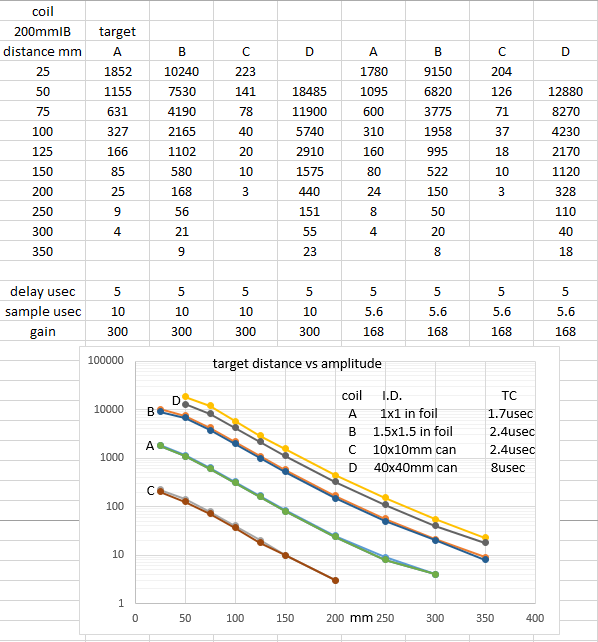

                  Hi Eric
                  Charted amplitude vs target distance for the four aluminum targets with a Rx(two 200mm round, figure eight) Tx(oval surrounding Rx). The longer sample time with increased integrator gain helped with the 40x40mm can but not the other low TC targets. I would be interested in the smallest piece of aluminum can side the Vallon can detect to see if the TC needs to be greater than 2usec. I will chart the TC if you give me the size. Thanks

                    Yes, I have started to do similar tests myself and it will be interesting to compare results. I am using my Magnetic Viscosity Meter to plot decay from 10uS - 50uS in 5uS steps. I will do a log signal vs time as you do. I have some reservation about aluminium from cans. It is very springy and obviously an alloy. Aluminium varies tremendously in conductivity depending on what the other alloy components are, but maybe all Coke cans are the same. I cut up a can from another drink assuming it would be the same and I can detect a 10mm square with the Vallon. I will report back in more detail later.

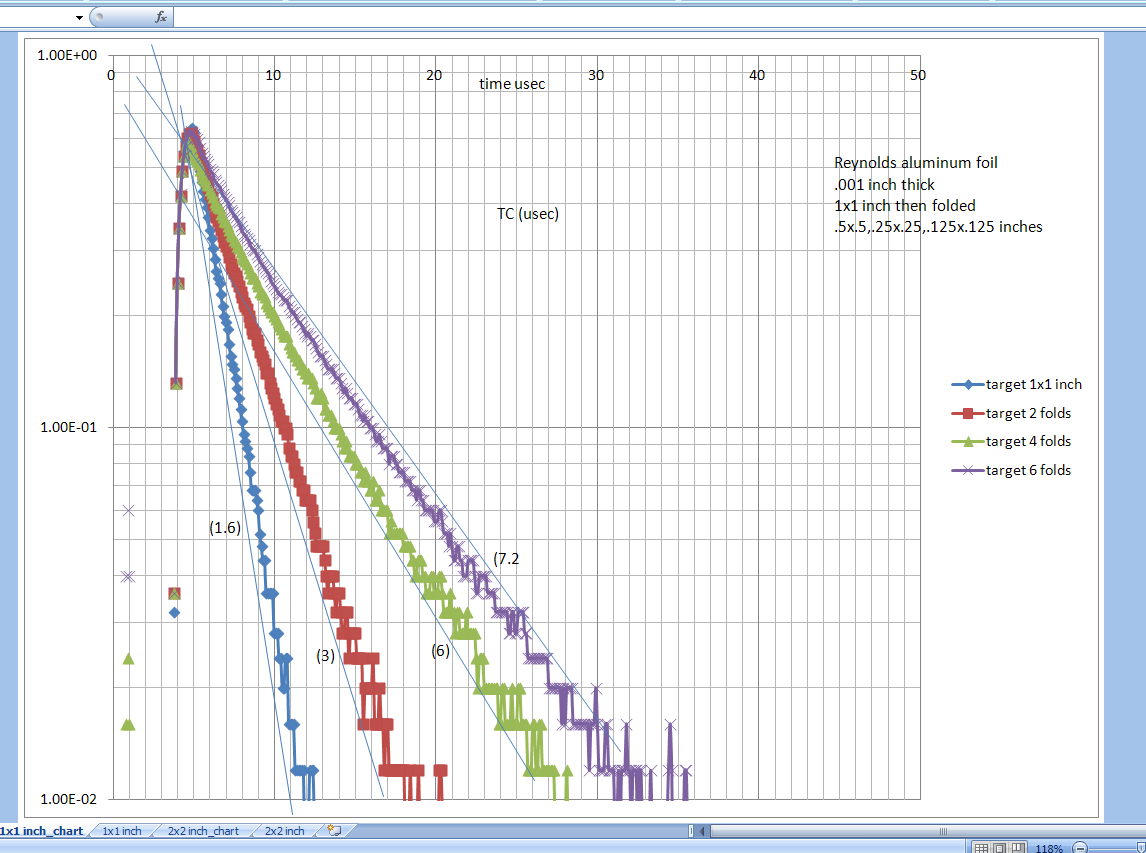

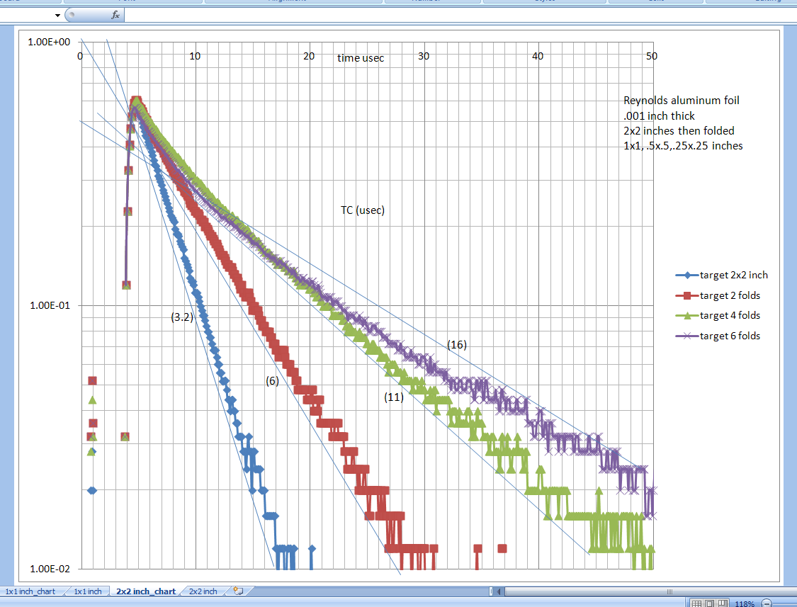

                            Hi Eric
                            A couple charts I posted awhile back. The 1x1 inch aluminum foil folded twice has a TC about twice the 1x1 in foil. That way the material would be the same and one target TC would be less than 2 and the other smaller greater than 2. If you can detect the twice folded and not the 1x1 inch we could experiment with a little smaller size to start with, maybe 20x20mm. I don't have a mic. to measure thickness but could cut a large enough piece of the foil to weigh on my reloading scale to verify we are using the same foil thickness. I found folding the foil around a needle worked good. Looking forward to test comparisons. Thanks. The charts give .001 inch thickness, not a accurate measurement. Probably need to test a few pieces to check for repeatability once you have decided on a size.
