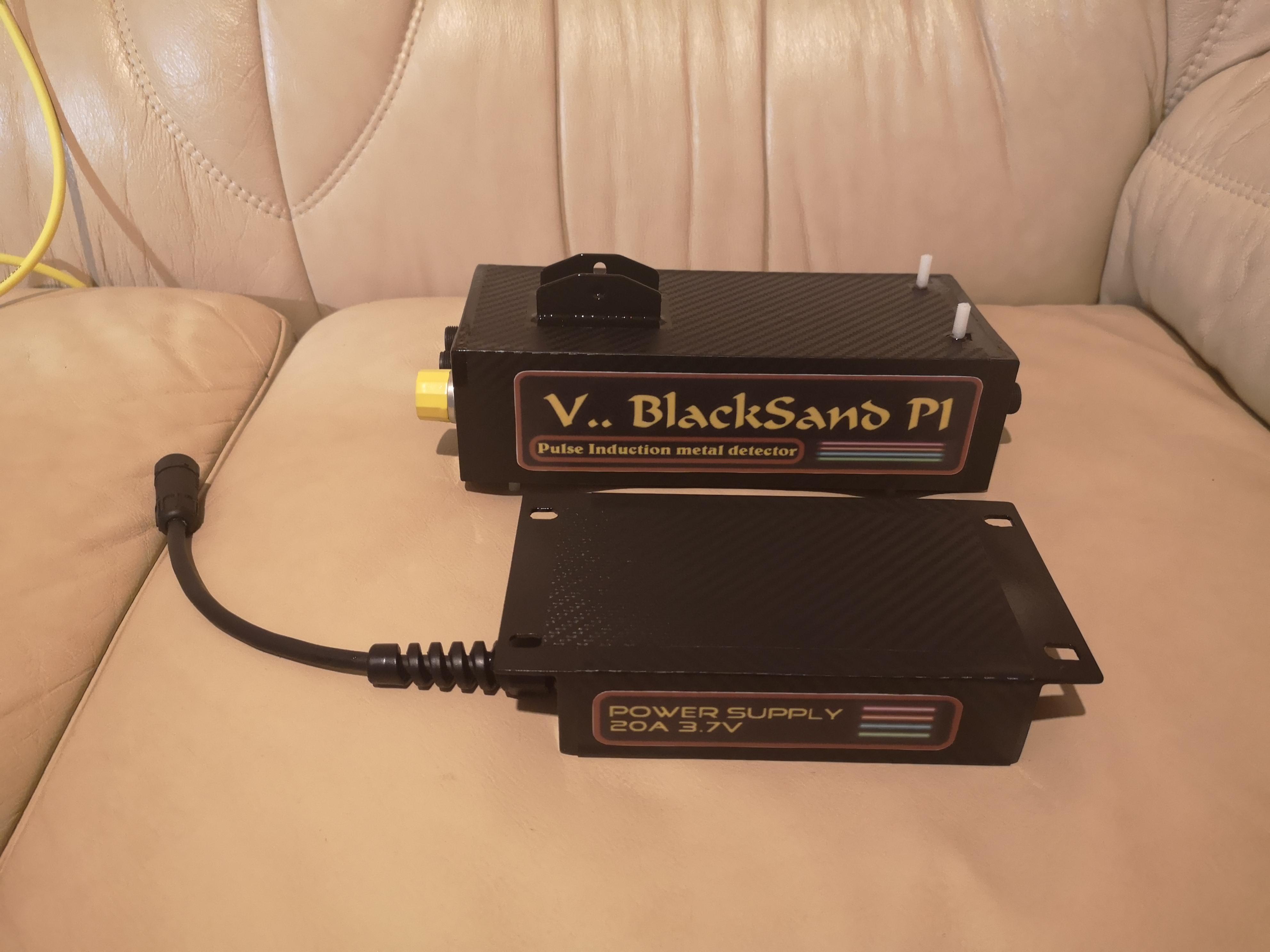

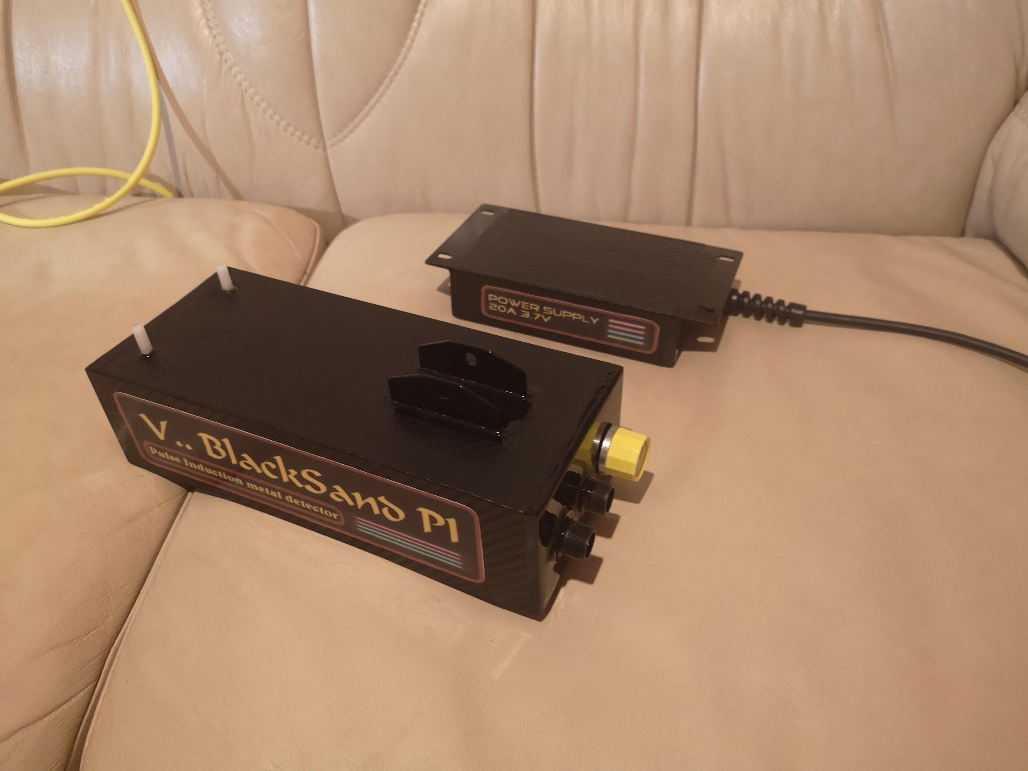

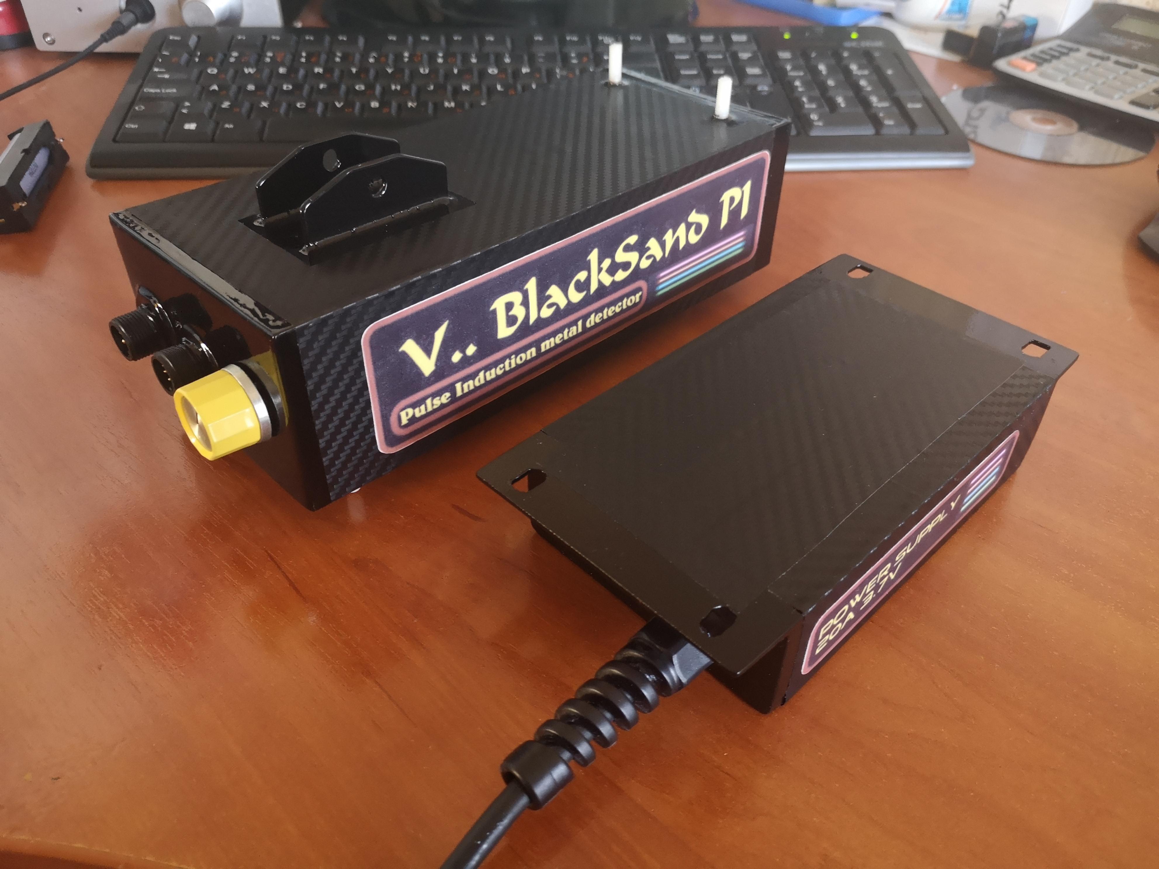

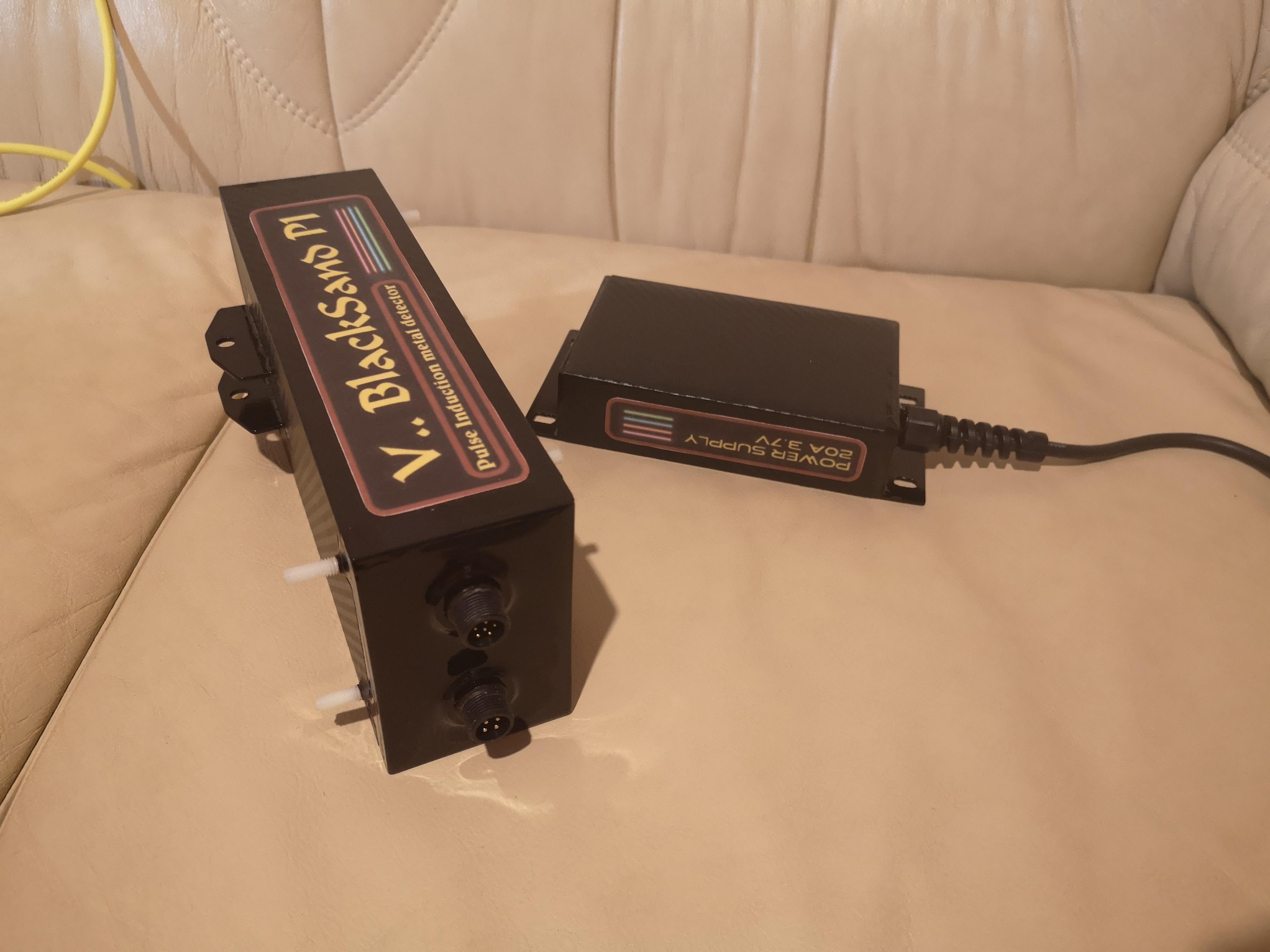

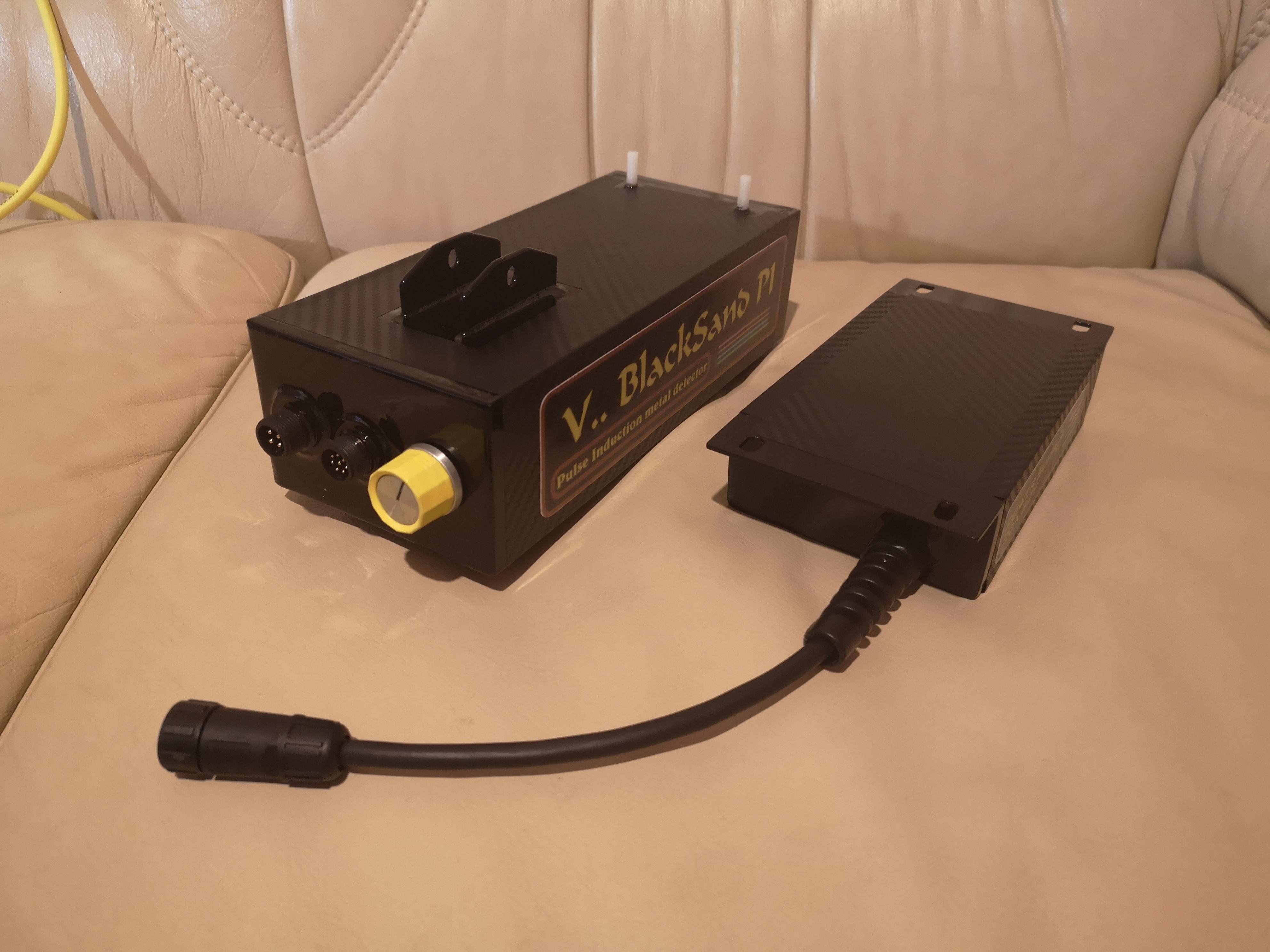

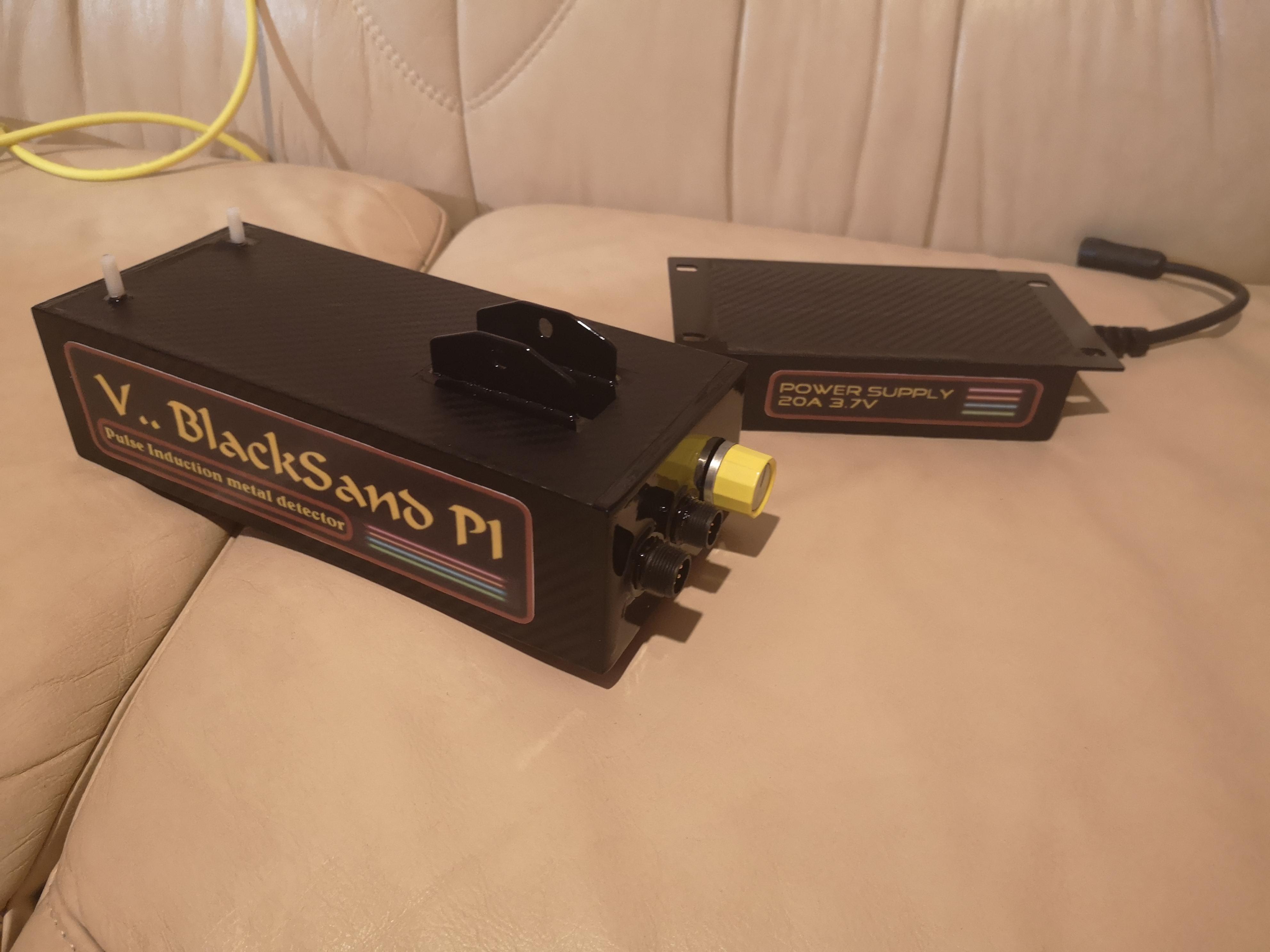

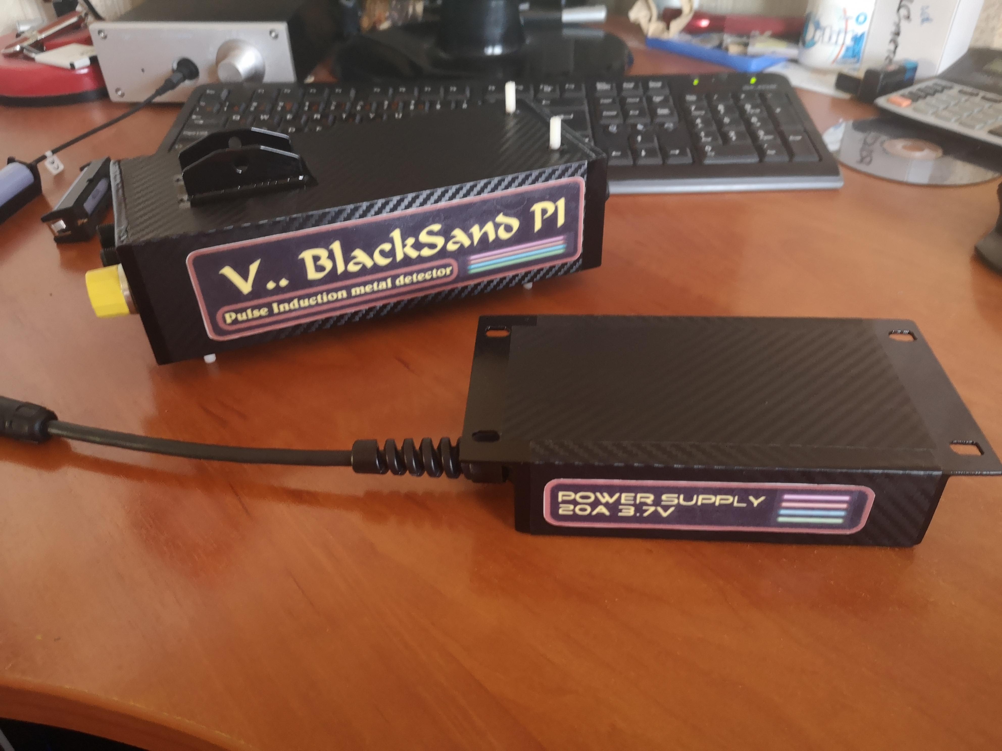

  • Blocks with filling from Vallon are ready.
    The other day I will install on the detector rod.
    And go to test at sea.
    Stickers are homemade, waterproof.

    • Very nice!
      How did you make the labels?
      • Originally posted by Myntmaster View Post
        [ATTACH]49458[/ATTACH]
        That was first class work.
          Very nice!

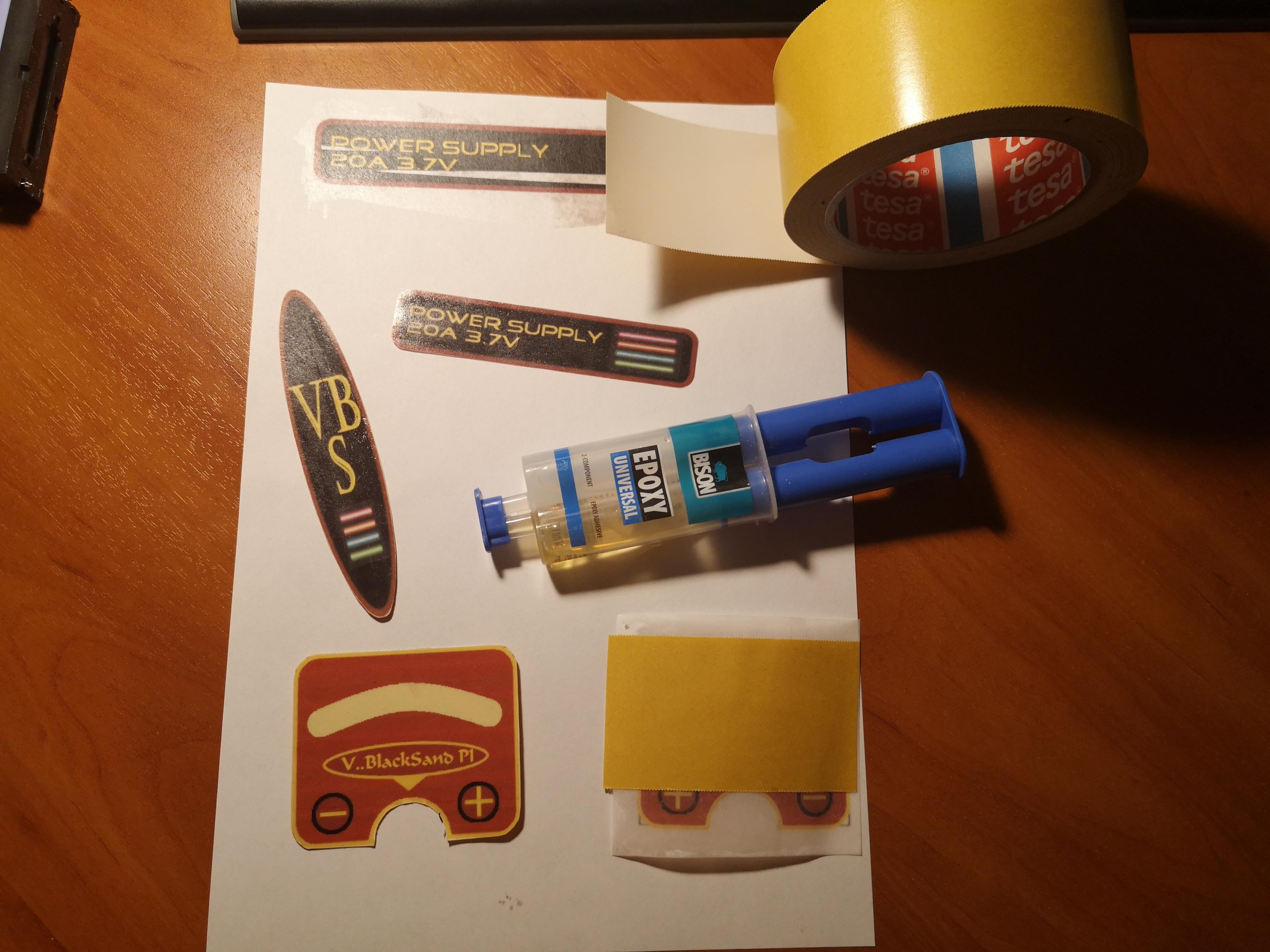

          The method is very simple. And not new.
          Design a sticker on your computer and print it on an inkjet printer on plain A4 paper. Now we are preparing a two component epoxy resin.
          We cover the printed pattern with epoxy on both sides, so that the paper is saturated with epoxy.
          When the paper is saturated, remove excess from the surface with a scraper.
          Leave on a flat surface until completely dry. After drying, the completely fulli waterproof sticker.
          Then stick it on the double-sided tape.
          Can print on a laser printer. It turns out more contrast. The method is good if you need to make a small amount.

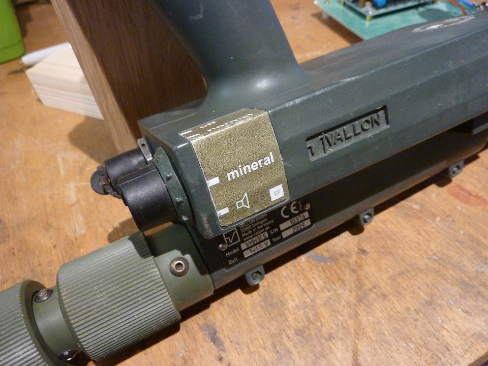

                I'll try that to reproduce the missing sticker around the selection knob of my VMH3CS.

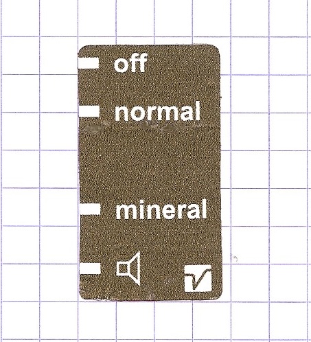

                  • Originally posted by F117 View Post
                    Very nice result
                    Thanks for the info on how to make the stickers.
                    This may help.
                    Eric.
                    • Thanks, Eric !
                      That's the one.
                      - Bernard
                        Thanks, Eric !
                        That's the one.
                        - Bernard
                        Hi Bernard,
                        I had a couple of Vallons where the label was very damaged, so I took a reasonable one off another machine and scanned it. I had to fill in some marks where it had worn away just under 'normal'. I had to scale it to get back to the proper size and then printed it out on normal printing paper. I had some matt polycarbonate laminating film from a previous label printing kit, which I carefully rollered over the face of the printed label. Having trimmed the edges with a scalpel, I then applied double sided Cellotape to the back. The only difference you might notice is that the Vallon logo is replaced with EF.
                        • Nice work Eric !
                          Looks exactly like the original label - but what an excellent idea to personalize it !
                          This adhesive film method is even easier than the epoxy coating.
                          Thanks,
                          - Bernard
