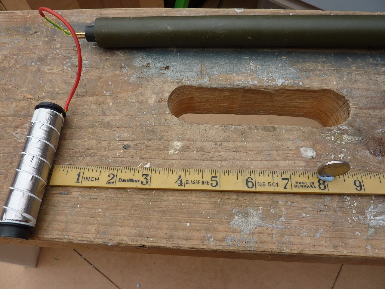

      For the first test I wound the 4in x 3/4in rod with as many turns as I could get on and achieved 1.8mH straight off. Resistance was 3.5 ohms so, we are in the right ballpark straight away. I left off the outer shielding at this stage, but had the core grounded with a drain wire running its length. Plugged it into the shaft connector of the Vallon so that it had all the cable capacitance and additional resistance. It ran through all the startup checks and the detector settled down with no problem. The difference I noticed was that it seemed quieter than the other probes I have made. My home workshop is quite noisy electrically, much of it from surrounding shops and light industry. I'll have to check it out away from the premises to be sure, but I definitely gained a couple of inches on a nickel. 10in instead of 8in. Over the weekend I will add the outer shielding and house it in a spare Vallon shaft tube; which happens to be just the right diameter. [ATTACH]36403[/ATTACH]

          • Originally posted by Chet View Post
            Hi Eric
            Thank you for the information in the previous post. Your latest coil (10” on a nickel) wow! That is something to be proud of. What does the field around the side of the coil look like with this kind of probe? Does it still pick up the nickel at several inches?
            Have a good day,
            Chet
            The external field is exactly that of a bar magnet. Going out sideways from the middle of the winding, I get 7.5 - 8in on the nickel; the coin being in the same plane as when measured off the end of the rod.
            Eric.

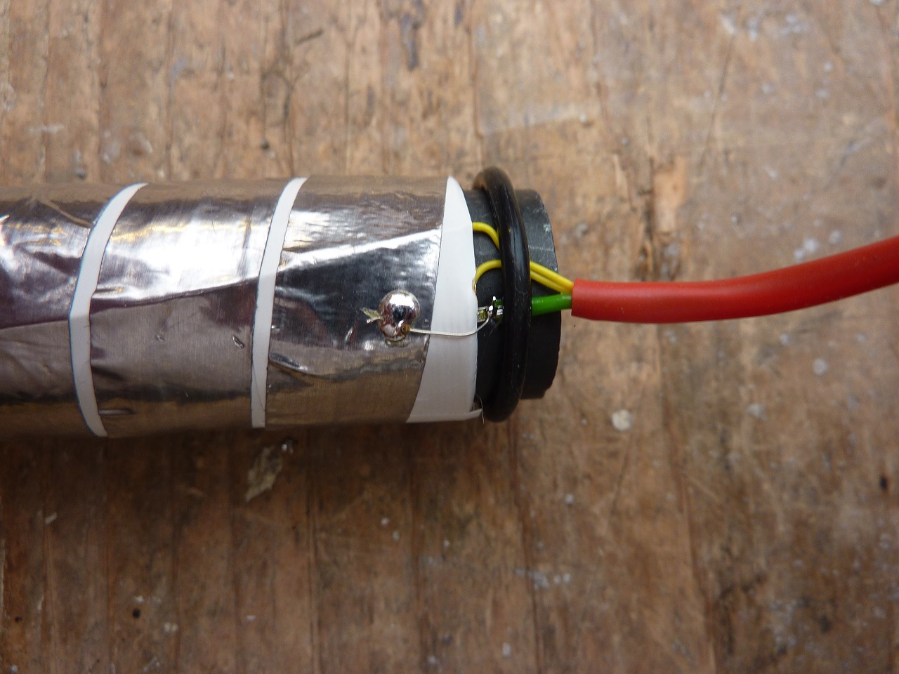

            • 4in x 3/4in probe core test. 2
              I have now applied the helical outer shield of lead tape. This is 0.1mm thick and adhesive backed, so it is easy to apply. I ceased using this some years ago but still have some left, so I might as well use it up in these experiments. The first picture shows the set-up for measuring the range to a nickel off the side of the coil and the orientation of the coin. There are three lobes of detection for a coin in this orientation; one each, top and bottom and the other all around the side, with a sharp minimum as you move from one lobe to the other. With a sphere you get a fairly uniform sensitivity all around the core, with no dips.
              Second picture shows connection from lead tape to core ground wire.

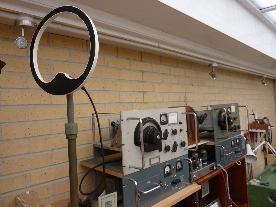

                          I realised yesterday evening that I have been disregarding my own advice. That is, to have the detector coil horizontal to minimise noise pickup (coil axis vertical).
                          I have been testing the probes laying horizontal, when they should be vertical. For broadcast radio use, a ferrite antenna is horizontally mounted to get maximum signal from the magnetic component of the carrier wave. Also radio direction finding frame antennas are vertically mounted on a swivel base. That is not what you want for a ground searching metal detector as minimum r.f pickup is the desired situation both for open coil and ferrite probe.
                          Sometimes probes are used in a horizontal situation so I am going to put together a differential arrangement which is noise cancelling in all directions. Will that work on the Vallon I wonder? I will consult my favourite reference work 'The Electronics Empiricist'.

                            Collins or what?
                            btw http://www.radista.info/en_hf_radio.html
                            • Dear Eric,
                              I have just sent you a private message with the requested informations.
                              • [QUOTE=ivconic;218363]
                                Collins or what?
                                /QUOTE]
                                No, they belong to me.
                                The l.f. receiver to which the search coil is connected is out of the picture and under the nearest receiver and power supply. To take the picture from the other side and it would have been dominated by the face of a Morbiere grandfather clock close to the coil. The picture was to illustrate that the vertical plane was good for the reception of radio signals and not good for a metal detector. Also an alternative use for a Vallon shaft which has been doing this job long before I managed to get a couple of control units to play with. BTW. some search coils by other manufacturers make better radio antennas than my coil, due to the use of graphite paint shielding which has less attenuation unless you spray on several coats.
                                A free ferrite rod if you can identify the receivers and the manufacturer. Clue - they are not American.
