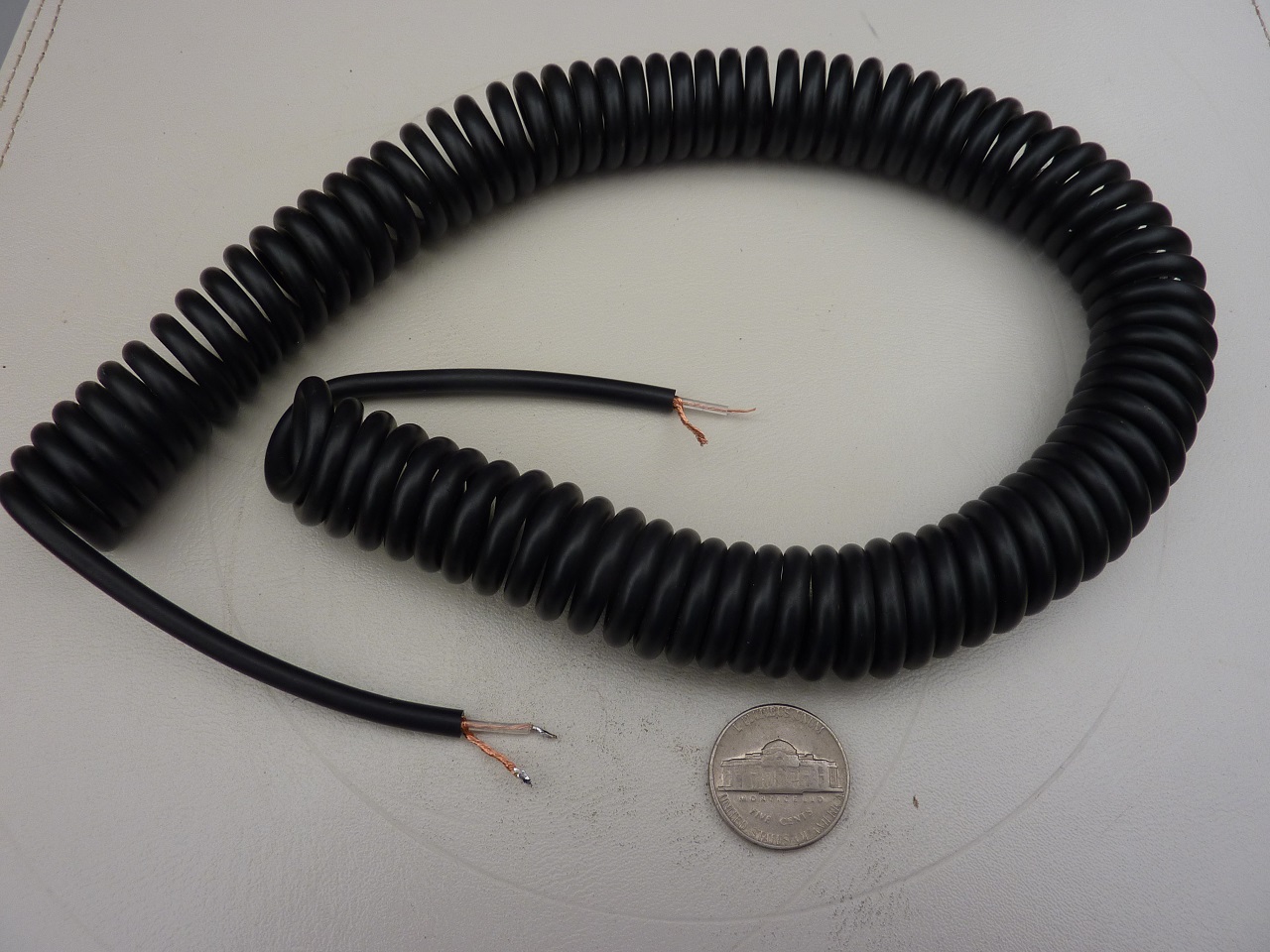

      • Coiled Coax
        I think I have found the answer. I was rummaging around in a box of mixed cables and found this unused coiled electric guitar cable with a mono jack on each end. Having a Fender Strat I was a bit reluctant to cut off the jack and find it was no good; but I did and what I found looks good. Stranded inner, polythene core insulation, lap wound shield and a substantial outer cover. Coils are 15mm mean diameter so nice and neat and very flexible. I worked out the length which came to 4m and measured capacitance 410pf. So 102pf/m. Not bad at all. All that remains is to try it, but I have high hopes.
        Eric.

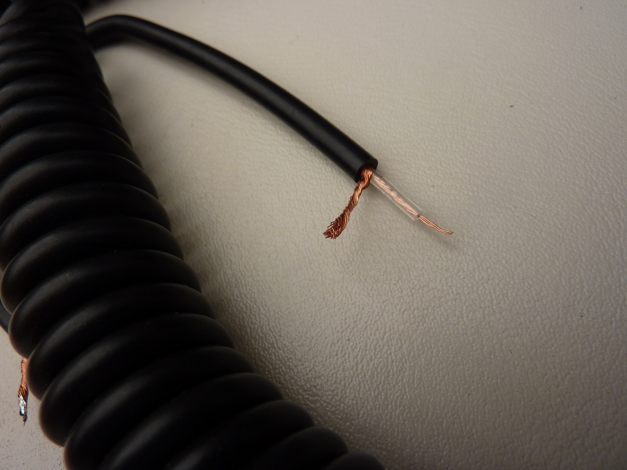

        • More on the guitar cable
          O.D. is 4mm; Total resistance forward and back is 0.8 ohms for 4m or 0.2 ohms/m. Notice the good thickness of outer insulation. The centre conductor is 7 strands of 0.15mm copper wire

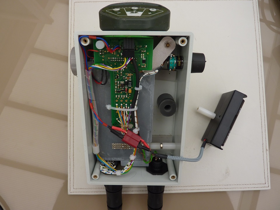

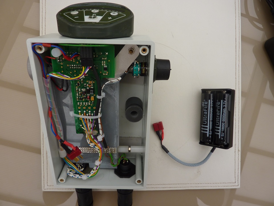

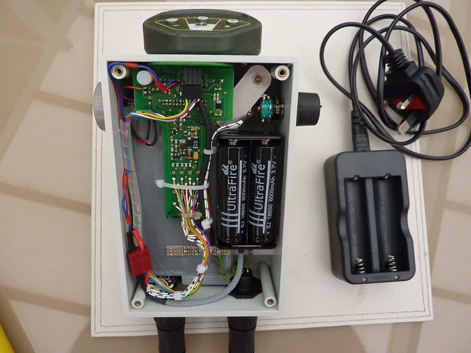

          • Li-ion Batteries
            Here is the latest news on the rebuilt Vallon VMH3CS.
            I'm really hooked on the use of Lithium Ion batteries now. When you compare the size and weight of three alkaline D cells that the original detector uses with the two 18650 size Li-ion batteries it is almost no contest. The three D cells weigh 15oz (425gm) total while the two Li-ion cells in the holder weigh just 2.35oz (66.8gm).
            These two are Chinese and are 6000mAh making 12000 in total. If they really are that capacity, then they will exceed the life of alkaline D cells, which are reputed to last 30 hours of operation. The two cells came with the charger which gives 1A per cell up to 4.2 volts. Red LED when charging; green when charged. With the battery holder and inline T connectors, the total outlay was £14.00, which I thought was pretty good. Yes, and the batteries have inbuilt protection circuit, which is just as well as the battery holder is embossed with battery symbols for series connection, although wired by the manufacturer for parallel cells.

            It's good that the Vallon electronics operates with no change in performance at battery voltages between 3V and 4.5V, thanks to its onboard converter. As the voltage drops below 3V the detector gives a continuous alarm and all even numbered LEDs light up.
            The next stage in my Vallon program is to package the electronics in a Pelican Micro case; either a 1050 or a 1060 size. Using these Li-ion batteries make this a very viable project. Just one control knob and the small push button/display unit is easily made fully sealed. In fact it is done on the unit in the picture with an O ring between the box and the display module.

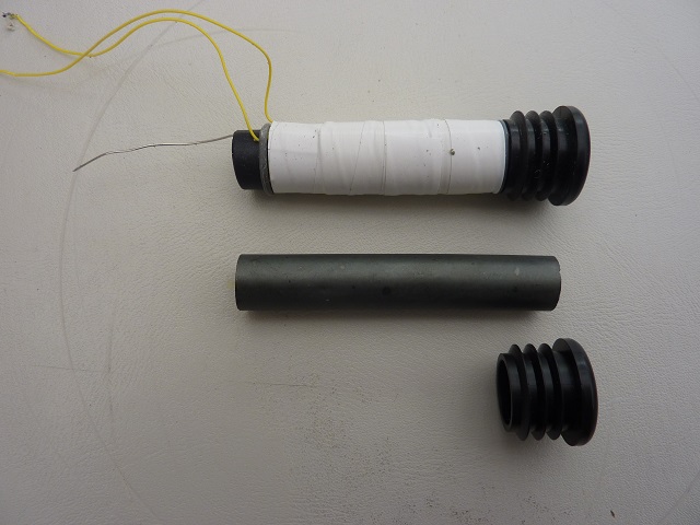

                        I have taken a couple of probes to the beach. One worked well but the other appeared to have an EF effect. I have noticed this before on some ferrites and came to the conclusion that orientation in the earth's field changed the permiability slightly, much like a fluxgate sensor. The other probe with a different core is absolutely fine. Finding the best way of shielding for the core is also tricky and I am working on that. Obviously you do not want a spurious response when the end of the probe touches wet sand or water. I am grounding the core itself with a drain wire and making the low potential end of the winding to be nearest the working tip. Do I need an outer shield at all? At the moment I don't really know. There is a plastic bung on the end of the core to seal it and prevent actual contact with the rod. This is a 3in rod of a material that I know to work well.

                        Just taken the photo attached here at 08:45 and checked the Vallon with the Chinese batteries that was switched on fully charged at 06:00. Guess what; they had expired!!!!!! Both batteries 1.5V!!! I will charge once more and try them, then it's back to the retailer for a full refund.
                        Eric.
