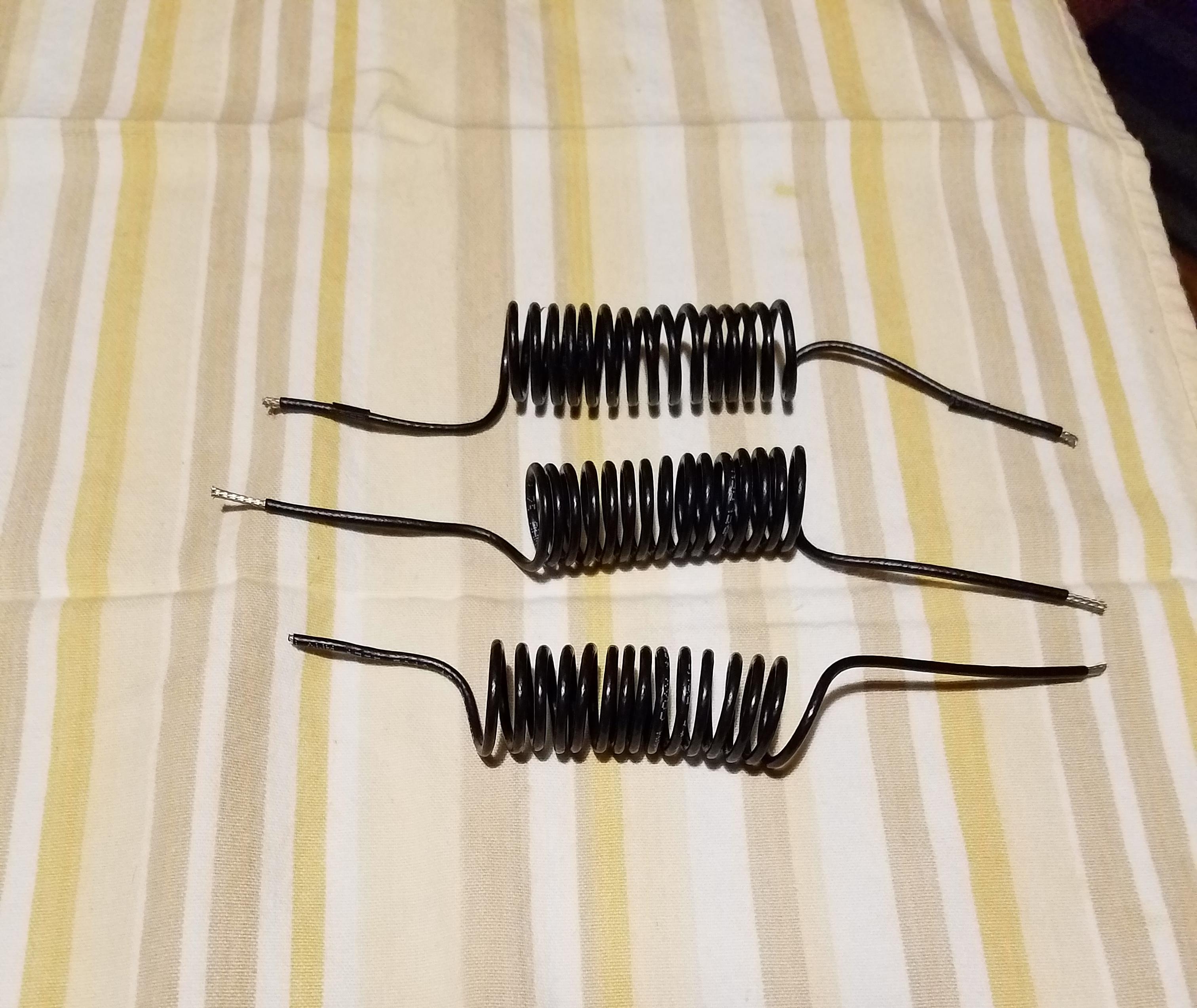

    Well, I've done three more... Hey, I am getting good at this! Increased the oven time to 30 min @ 250 deg F (121 deg C), freezer time to 30 min.

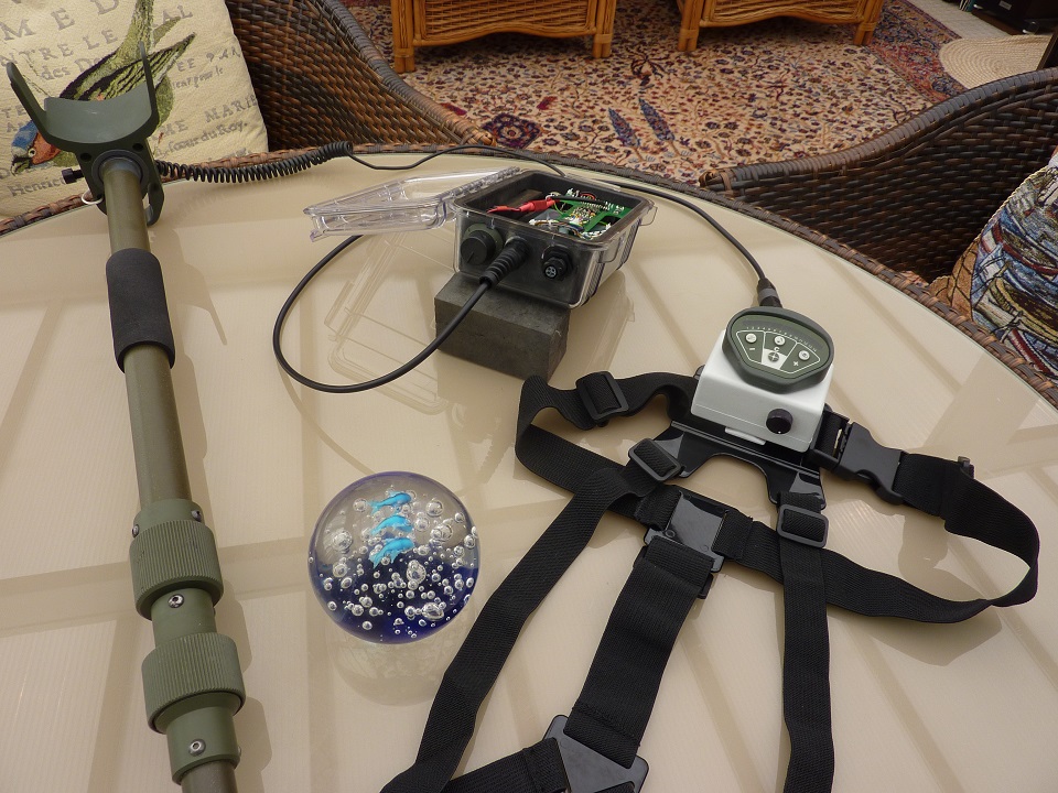

      Very good! I haven't done any more myself lately but I will have another session shortly. I need to curl a 7 way data cable as I want to mount the Vallon control/display module on the coil shaft, with the rest of the electronics in a belt mounted Pelican Micro-case. Everything fits neatly in the 1050 size case and I am using Souriau UTS Hi seal connectors, size 8, for coil and phones. They are great connectors, easy to fit and use, and are not as expensive as underwater connectors usually are.
      The modules are not wired up yet but all in the box plus Li-ion batteries to check fit. The data cable is the one in the top strain relief gland.

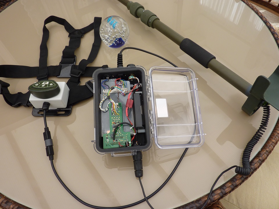

        Here is the latest incarnation of the Vallon VMH3CS.
        It all fitted neatly into the 1050 Pelican case with the Li-ion batteries. The top of the case has the single control switch; the cable to the LED indicator and push button panel, and headphone output. The bottom end of the case has the connector for the search coil or probe.
        The case is mounted on a 2 inch wide waist belt threaded through a stainless steel clip on the back of the box. In use, the best position seemed to be with the box just round the back at waist level. This keeps the one control, which is basically the on/off switch, within easy reach, and is the most comfortable when bending forward or digging.
        The 8 conductor cable goes around the back to the chest mounted box which houses the push button control panel and LED signal indicator. Also in the box is a piezo speaker which is easily heard, as long as the surf is not crashing too loudly, but with a waterproof volume control that can adjust the sound almost to zero. If the conditions or preference is for headphones, then these can be plugged into the connector on the top of the box, which then disables the speaker in the chest unit. The chest unit mounted very conveniently on the chest harness for a Hero camera. The chest box disconnects from the cable by means of the mini DIN connectors for which I have made a sleeve which is watertight when mated. The box also slides off the harness mount.
        The push buttons on the chest box control sensitivity, audio volume, pinpoint mode, and ground balance if needed. Battery state is also shown on the LED bargraph when switching on.
        The concept is that one can search in water to waist height with the main box being submerged at times. The chest mounted control and indicator is mainly out of the water but will survive the inevitable wave splash. In fact it is only the 1/4 hole for the piezo speaker which limits the submersibility as I have made sure that the small Vallon housing that contains the push switches is completely sealed.
        Field/water testing has yet to be done but the concept appears good so far, with the unit being easy and non tiring to use.

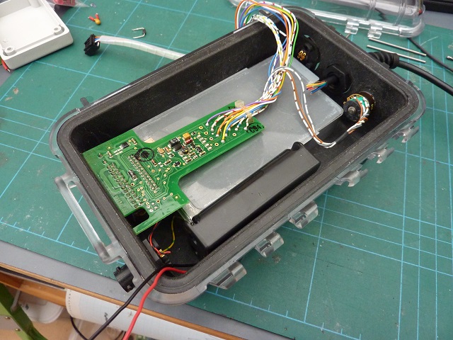

            Sorry to disappoint, but I am just stringing black boxes together. I can remove the whole electronics with wiring loom and controls connected and just transplant into different cases without knowing any of the circuit details.
            The main electronics is in the grey box and consists of two SM boards of equal size piggy backed together. Both sides of the boards are loaded with components and can't be unplugged from each other. They are probably multilayer boards from the component density and would be a nightmare to unravel the details. It is all programmed in firmware too. All I have gleaned from a quick look at the boards is that the bipolar TX is probably an H bridge arrangement as there are four Mosfets close together. Where the RX preamp is, I do not know. Everything is covered in a coating of laquer so that even probing for voltages or waveforms involves penetrating this layer.
            I do not have any faulty modules, otherwise I might probe deeper, but I am happy at the moment just shifting the black boxes around to make a detector that is easy to use on land and in water.

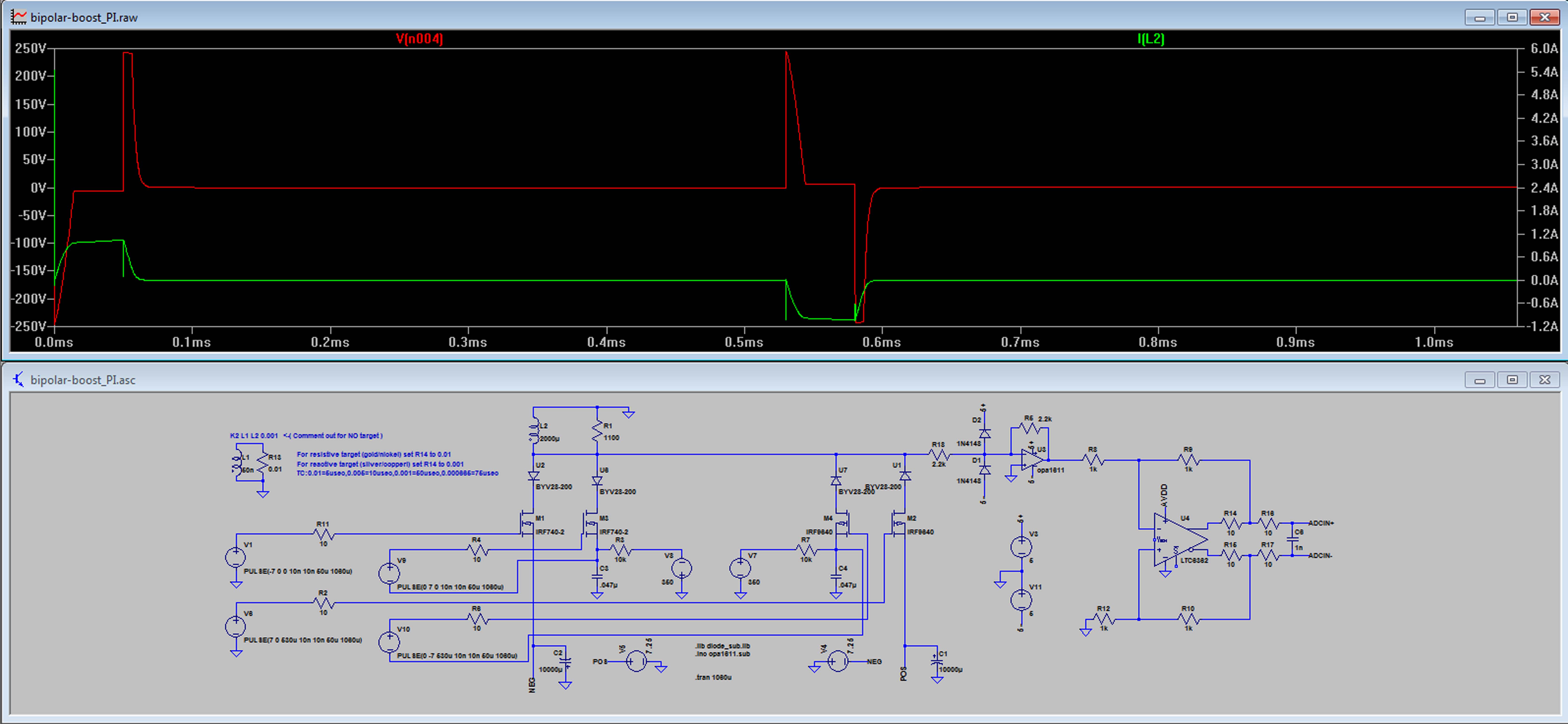

                          I have tried to model the TX based on Eric's descriptions/observations at the beginning of this thread. The model indeed requires 4 mosfets, but not as an H-Bridge.
                          The parameters described by Eric:
                          Measured voltage at the coil = 6Volt,
                          Measured current: 1amp at 10usec... near constant for the next 40 usec,
                          250V flyback, transmit pulses 530 usec apart alternating

                          The only thing that i don't remember him stating was a HV kickstart pulse the same polarity of the main TX pulse, but I can see no way to get that 1 amp coil current within 10 usec without it.

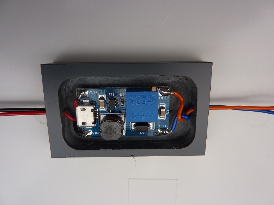

                            For up-converters, it's worth looking at hobbyist modules like those made by Pololu and others. (I have plans for one of these 5 Volt output modules to reduce battery pack size)
                            Example:
                            http://www.hobbytronics.co.uk/batteries
                            There are quite a few variations on the market, but the one I chose uses the MT3608 converter. This runs at a high frequency of 1.2MHz which I thought would give less chance of interference than others that run at lower frequencies. Up to 2A of output current is more that adequate.
                            I have machined a small housing for the board, which I will wrap in copper shielding tape and ground to the electronics in the detector (my viscosity meter) as there is bound to be a bit of radiation from the inductor. I didn't notice any effect on the first test though.
                              I had also looked back over the previous posts, and determined by calculation that the drive voltage cannot possibly be restricted to 6V, and needs to be about 300V (or thereabouts) to get the coil current up to 1A in 10us.
                              Would you mind posting the LTSpice files?
