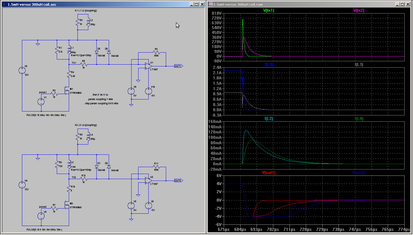

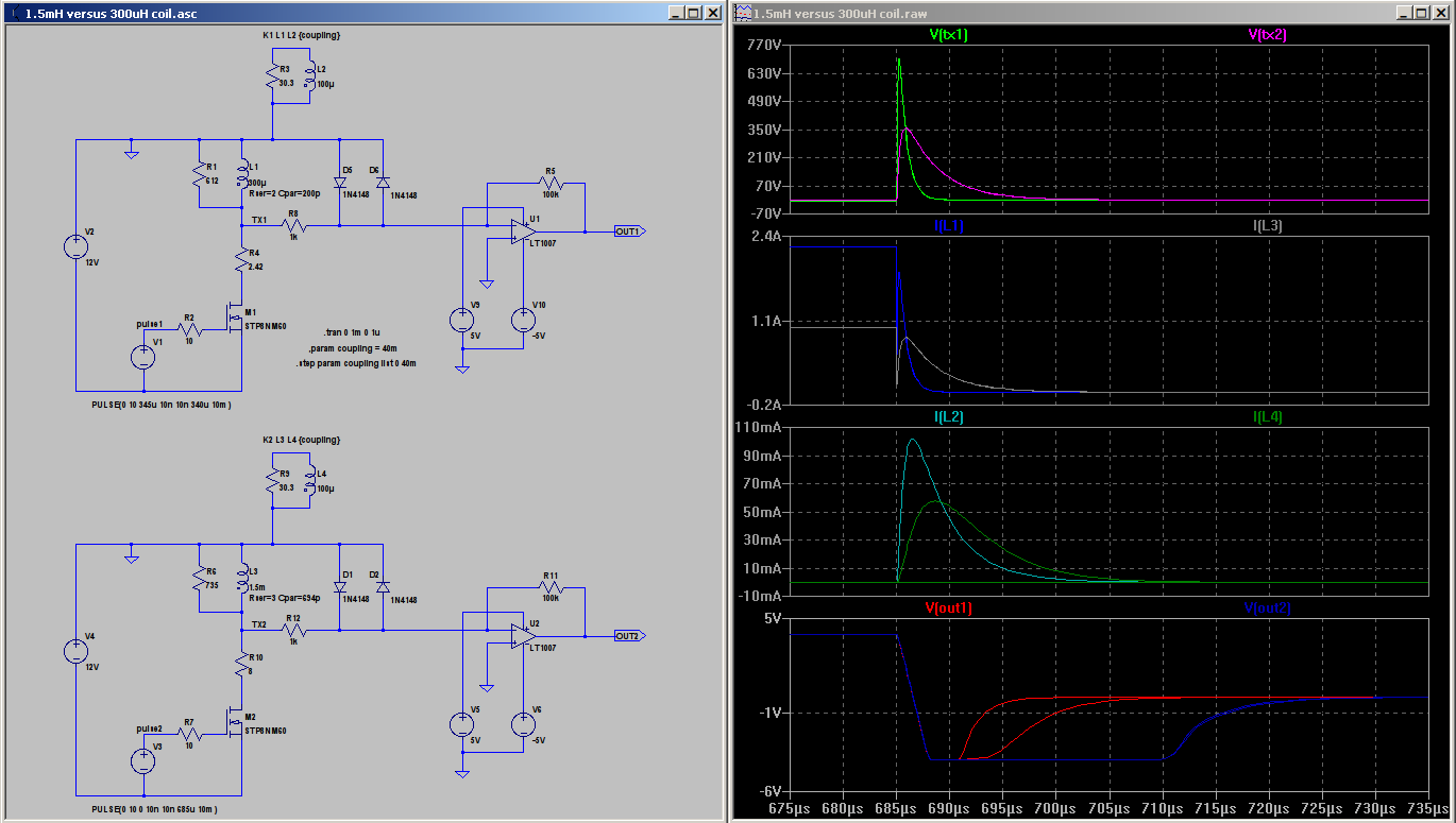

                        • Summary of Vallon VMH3CS Characteristics
                          Having re-read all posts in this thread, I have noted the important details below:
                          1. Earliest sampling time appears to be 25us. Eric deduced this by connecting the Vallon coil to a standard PI preamp.
                          2. Drive voltage = 6.5V.
                          3. Pulse width = 50us.
                          4. Pulse current = 1A (rises to full value in 10us, and flat for 40us).
                          5. Current drain is 340mA average.
                          6. Operating time = 30 hours.
                          7. Power source = 3x D-type batteries.
                          8. Coil = 1.5mH, 3 ohm DC resistance, f0 = 156kHz, C = 694pF (including connecting cable).
                          9. Rd = 735 ohms (optimum value for critical damping from calculation).
                          10. Coil wire is 32 AWG enamelled copper.
                          11. Pulse period = 1020us, 510us between +ve and -ve pulses.
                          The detector must be using high voltage with current limiting to get the coil current to 1A in 10us, and then remain flat-topped for a further 40us.
                          Combining a high-resolution ADC with a DSP may conceivably allow sampling further up the decay curve, but who knows?
                          Consider this ->
                          A 0.3gm gold nugget with a TC of 3.3us. Therefore 5*TC = 16.5us.
                          The target signal will have decayed to 0.67% after 5 TCs, and 0.05% at 25us. This is a miniscule amount of target signal to extract from the noise, even for some clever DSP algorithms. The puzzling thing about all this is why anyone would choose to use a 1.5mH coil for minimum-metal mine detection?
                          To try and discover the answer I ran two simulations side-by-side. One with a 300uH coil and the other with a 1.5mH coil, and compared the results. With reference to the summary of the Vallon characteristics, we can calculate that the 1.5mH will contain 750uJ of energy when charged to 1A. To put the same amount of energy into a 300uH coil would require 2.24A.
                          Rather than complicate matters by using a high-voltage with current limiting, I simply inserted an appropriate series resistor in each current path and made the pulse width long enough that the coil current would flat-top at the required value. Then it was possible to make a valid comparison and determine which solution yields the best result. The analysis was also performed using a mono-polar configuration, as the design is symmetrical and the results will be the same for both polarities.
                          From the simulation plot results (for target with 3.3us TC) it is abundantly clear that the 300uH coil wins hands down when detecting a 3.3us target. The simulation includes a parametric sweep of the mutual inductance between the coils and their targets in order to compare the target response with the no-target signal at the preamp output. V(out1) is the 300uH coil response, and there is a large change in the decay curve. However, for V(out2), which is the 1.5mH coil response, the change is very small in comparison.
                          Perhaps Vallon's decision to use a 1.5mH coil is related to the elimination of ground response by sampling later, and using the power of the DSP algorithms to compensate for having a much weaker target signal; plus using a high-voltage source with current limiting to overcome the high inductance at switch-on, and thus allowing a higher pulse rate.
                          In conclusion, I really cannot see any advantage to using a high inductance coil for this application. The simulation results demonstrate beyond doubt that a 300uH coil would be a much better choice. Previously I considered whether the damping resistor was being switched in after the flyback had reached maximum, but examining the scope images show no evidence of this happening. It's almost as if Vallon went out of their way to make things difficult for themselves by deciding to use an inappropriately high inductance coil wound with enamelled copper wire, and then having to circumvent these difficulties with an overly complex design.
                          One final point ... nowhere in the Vallon brochure does it even mention minimum-metal mines. So this detector may not even be intended for that purpose anyway, and that's why it performs well as a coin detector (see second simulation with target TC of 10us).
                          Target with 3.3us TC:
                          Target with 10us TC:
                          • Perhaps I should add a few comments about the simulation results ->
                            For the 300uH coil:
                            V(tx1) = TX voltage
                            I(L1) = coil current
                            I(L2) = eddy current response in target
                            V(out1) = preamp output
                            tx1, L3, L4 and out2 are for the 1.5mH coil.
                            TX-on delays are set such that TX-off for both coils occur at the same point in time.
                            Maybe the designers at Vallon were simply too DSP-obsessed when working on this detector.
                            Either that we're missing the bleedin' obvious.
