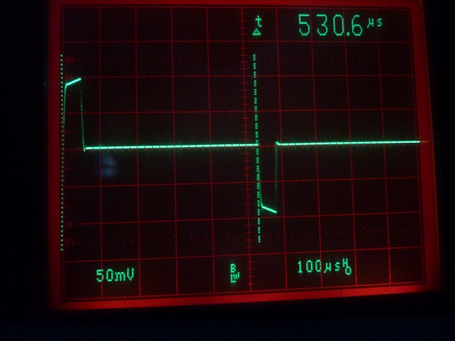

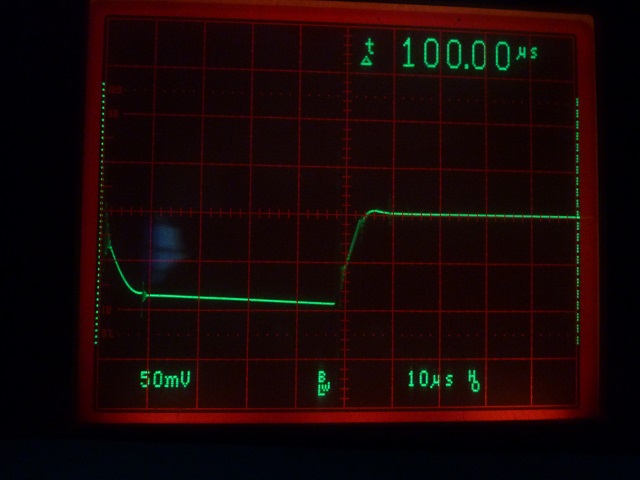

                  Here are a couple of shots of the coil current on the Vallon detector with 0.1 ohm series resistor.
                  Bipolar pulses. Click image for larger version

                  Negative pulse expanded.Click image for larger version
                  • #54
                      It appears there are both acceleration and deceleration mechanism involved. There are steep, but near-linear current slopes on both sides. Interesting.
                      • #56
                        Hi Davor, I wonder if they are using the high voltage spike from one pulse to kick start the next opposite polarity pulse in order to get the fast rise time. A diode capacitor snubber would store the 250V which would be in the correct polarity to do this.

                            Hi Mick, Your waveform looks the cleanest. There are some odd splurges on the Vallon one, so I suspect there are other things going on in the background.
                            • #59
                              My thought exactly. You may observe that current continues rising past the initial kick start. Seem like a perfect way to employ a snubber. In a unipolar machine it would require lots of effort to reverse polarity, but here it fits perfectly. You need to burn some energy stored in a snubber capacitor between cycles for it to run well, so there you have it.
                                I think that's exactly what they are doing. It's not 100% efficient, ergo the "tilt" during the on-time.
