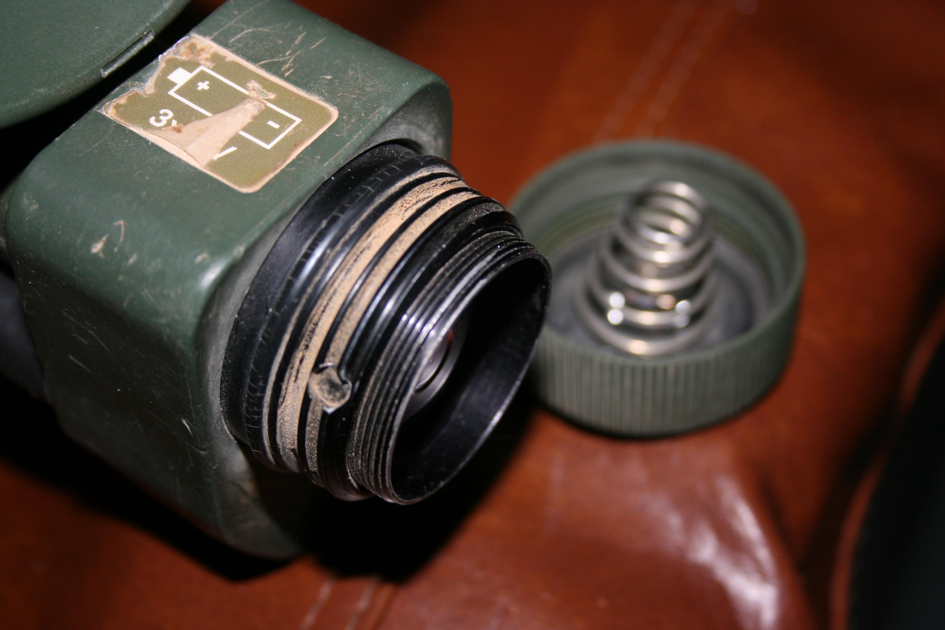

    What is the problem with the battery cap? Did you get a test piece with either Vallon?
    I have not found any difference in performance with the Vallons I have had, which is about 12. I always check them out with the test piece. Have you tried changing the channel (presume pulse rate) to minimise interference?
    Eric.
    As you can tell by the exposed fine threads, the metal battery holder protrudes about .25 inch past the plastic thread where the battery cap screws on. I know that it must protrude a little (as in my other Vallon) to make negative contact, but at this distance the rather stiff coil spring has to be greatly compressed for the cap to travel that extra distance in just engaging the plastic threads where it bottoms out after about two threads. You can also see from that ring of Afghan dust that it has been some time (never?) since it screwed all the way to the seal O ring. Resultant here is a cap that takes excessive pressure while twisting around in trying to get engagement with the first thread. Since you have had these detectors apart I was hoping you could suggest some adjustment. Thanks in advance.

    • Yes, that part onto which the battery cap screws is badly out of position. I will post the info later today on how to position it correctly.
      Eric.
      • I like the white Pulsepower coil the O shape is just so simple but beautiful
        RR
          Eric.
