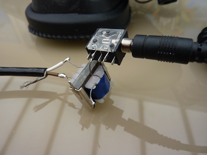

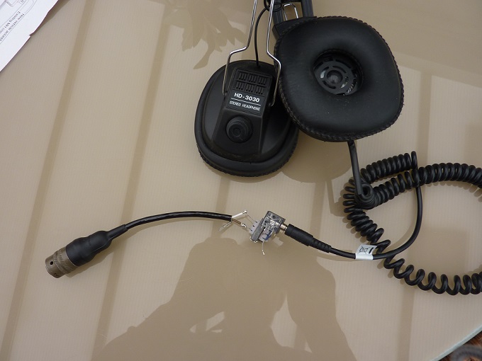

                      So I chopped the earpiece end off one of the phones I have today....I have a brown wire, white wire and silver wire.....How do i go about connecting that to a set of "normal" headphones??! Help !

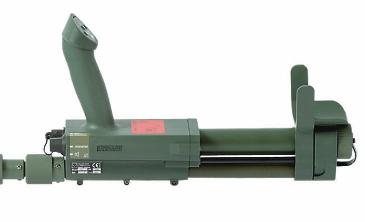

                        Hello Eric; My Vallon #1 had a sticker on top, like the attached photo, when I received it. It was considerably defaced, and since I did not attach any significance to it till I saw this picture yesterday, I scraped the remains off. This one may have the "sub- munitions" up grade which could account for its much increased sensitivity to the 1 X 1 Std. Wgt. foil over my newer Vallon.

                          This is a quick solution rather than an elegant one if you want to run standard low impedance phones. The phones shown in the picture are quite cheap, and when switched to stereo they are in series with the ground as common. If you disregard the ground then the series dc resistance is 60 ohms (30R per insert).
                          What you need then is an LT-44 transformer, available on ebay and connect up as shown in the photo. It is important that the secondary side connects to the tip of the jack plug and the second band only. The third band on the plug (nearest the body) is not used. The phones are readily available (ebay again).
                          I am planning to use an in-line jack socket, rather than a panel mount, and put the whole thing in a small plastic housing. This arrangement gives adequate volume and which can be turned down with the controls on the phones.
                          The silver wire you referred to is an outer braid on the twin cable which goes to ground in the detector. This can be cut off where the white and brown wires poke out, as a ground is not needed in this arrangement. Note that the nearest connection on the transformer is not used.
