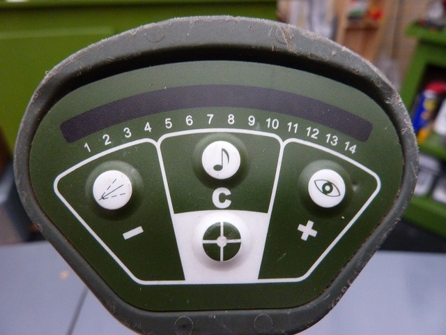

    I recalled that someone once told me FTP had a Vallon, so I poked around the dustbin and found it. It's a VMH3 without the CS, which apparently means Changeable Searchcoil, because that appears to be the only difference.
    A couple of years ago I picked up a copy of Janes Mines and Mine Clearance 2009 - 2010, at a swap meet. It has a section covering the various countries and the mine detectors they manufacture; Vallon being one for Germany. The VMH3 details are there and from the pictures it appears that the seach coil is not changeable, whereas the VMH3CS has this facility. On the following page is the VMH3S which has interchangeable coils as does the VMM3 on the next page. Whether CS really means changeable search coils, one can't be sure.
    One difference between the VMH3CS that I have is a push button for pinpointing Click image for larger version
ID:	345751 which is absent from the VMH3 picture in Jane's. The button with the crosshairs appears to speed up the 'retune' and sharpen the response. The other variable is that the firmware can be reprogrammed on all machines for different applications, which presumable would affect the small object response and range.
                          Yeah that was just a wild guess.
                          One difference between the VMH3CS that I have is a push button for pinpointing [ATTACH]36197[/ATTACH] which is absent from the VMH3 picture in Jane's.
                          Mine has the exact same layout, including the pinpoint feature.
