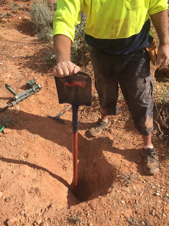

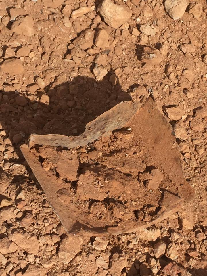

                        • I can now confirm that when I increased the sensitivity to 13 and did another GB, the vallon was much more stable
                          In fact, was able to stay on 13 for the whole 2 hours.
                          Dug about 2 foot down for a signal that screamed on an old pushed heap on our block!...Got quite excited!...Ended up been half a rusty can that someone has thrown down an old goanna hole

                          • Originally posted by kingswood View Post
                            Good depth [ATTACH]39774[/ATTACH][ATTACH]39775[/ATTACH]
                            Thanks Kingswood, Yep, same here, so that's a win I reckon

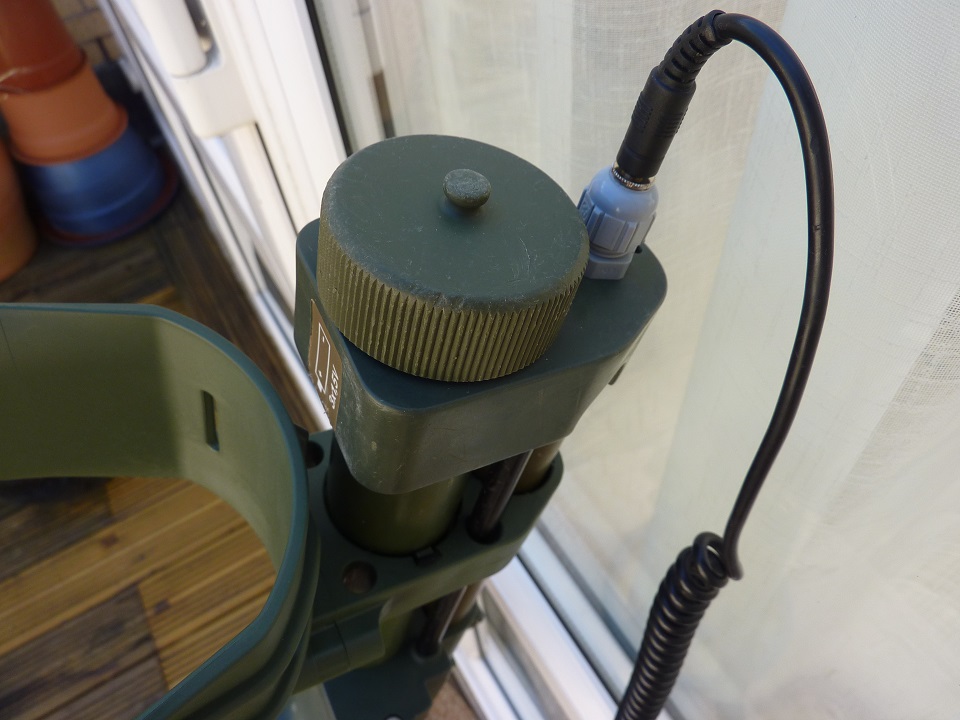

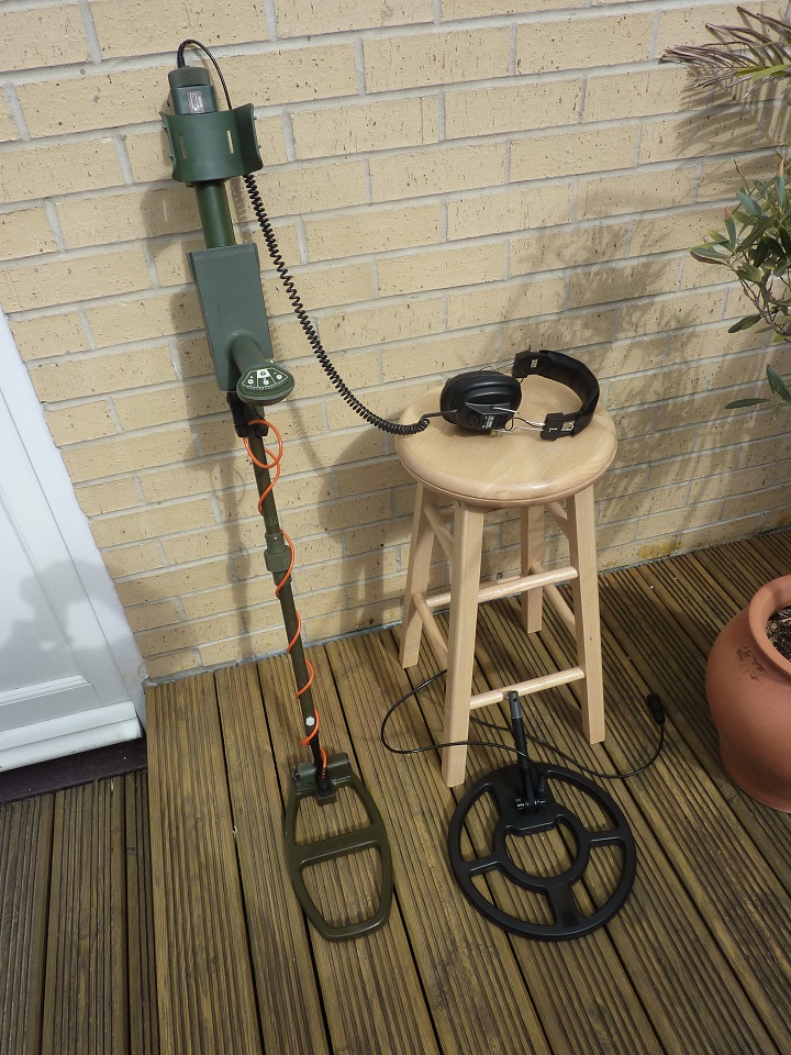

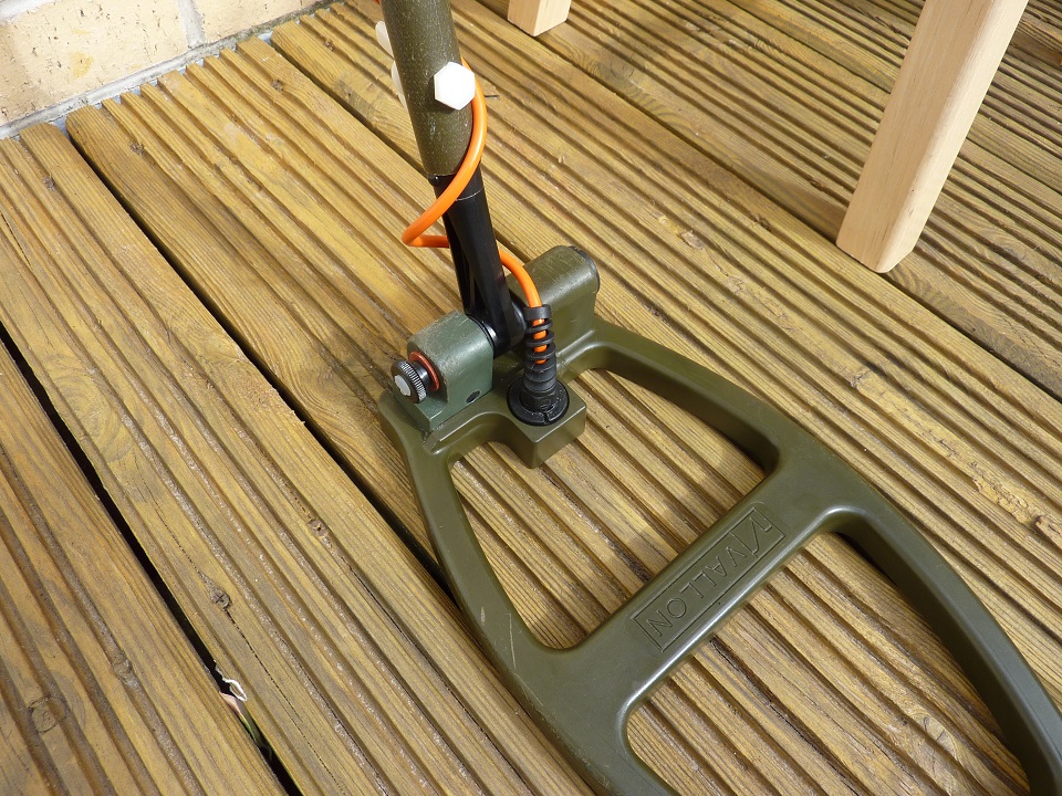

                            • Vallon VMH3CSME
                              Or, Change Search Coils More Easily.
                              I had a blitz on a Vallon over the last couple of days and changed things around to make it a more versatile machine for hobby use. It means pretty well a complete strip down to do it but it all worked at the end of the day. The first thing was to use the 6 pin socket on the front as a coil connector instead of audio and data. I was going to change it for a Souriau but decided to stay will the MIL one as it was in good condition. Next to go was the cable in the shaft and the 6 way connectors which seen to be a Vallon special and almost impossible to replicate.
                              The Vallon swivel on the shaft has to be cut off and a simple adapter piece made to join the bottom end of a Whites shaft to it. The Vallon stock coil is modifiable to take a cable out of the top and adapters made so that the Whites swivel end can be used.
                              The coil cable ends up going through the black tube into the electronics box, but the same black tube now takes the audio to the 3.5mm jack on the rear support just below the battery cap. Much more convenient. There is enough room to get a 1/4in jack socket, but I decided that to test the concept a 3.5mm one would do. Finding a place for the step down transformer and filter for the audio was a bit of a challenge as there is little room in the main box. That is where it ended up though, potted into the dessicant tablet, after it had been emptied.
                              Eric.
