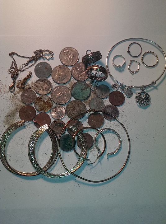

    • The test on the full submerging of the VALLON lasted 4 hours 10 minutes without any problems in waist to chest deep water.
      I retrieved a number of targets including coins, jewelry, and trash. I have had no luck posting a picture though but will try again.
      I have not noticed any tone difference between gold, silver, nickel and trash. The only tone difference I hear is in the depth of the signals and the double blip from shallow targets. This could be me though.

          Carolina emailed me a picture of his finds with the VMH3CS so I have taken the liberty of posting them for him. Not bad for a 4 hour stint in the water.
          Eric.

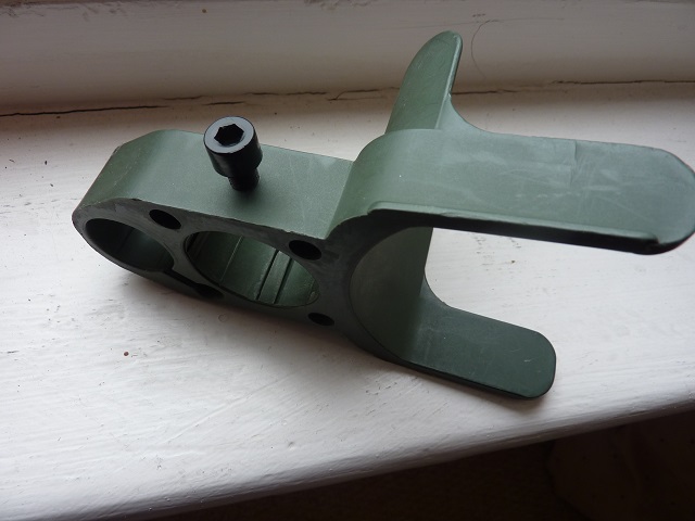

          • Arm rest of my Vallon goes down while I use it , what could be done to fix this annoying thing?
            Are there some tips to dismount it?

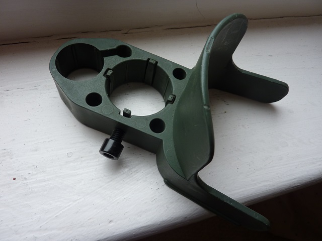

                The way I have fixed it is to drill and tap a hole in the side to take a short M8 nylon bolt This then tightens on the side tab and locks the armrest firmly. Accurate drilling is needed though to locate the bolt in the middle of the groove and tab. It would be hard to do without removing the armrest from the detector and holding it square and level in a vice. I have a mill drill which makes the job easier.
                Each of the four tabs has a strip of sponge rubber behind it and it seems that prolonged use in dust and heat causes it to collapse and the armrest becomes loose.
                Is your armrest of this type, or the later wide one?
                Eric.

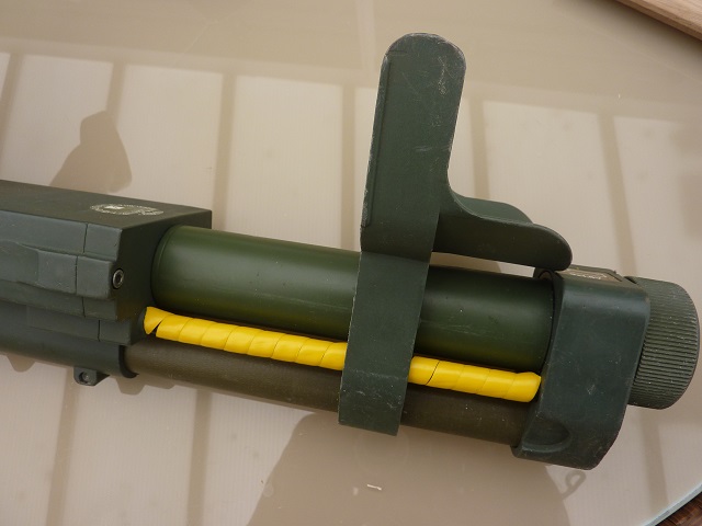

                • Alternatively, look at my post #550, IMG_3600.
                      Eric.

                      Thank you Eric.
                      Very good explanation.
                      My arm rest is the same as in pictures.
                      I will apply your suggestion before next field test.

                              • Originally posted by Altair View Post
                                Thanks TH'r to have pointed out your solution.
                                TH'r's solution is a good one and doesn't involve any machining. I tried the same idea using spiral cable wrap and that works too.
