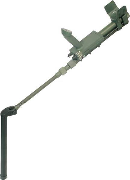

            • I also bought a vmh3cs yesterday, hopefully it will be here next week.
              Is the someone around here who have experience with the stick probe for this detector? It is made for bomb finding so maybe its very interesting for the WW2 guys (like me) here.
              Or someone here does have experience tips how to make a probe buy yourself for this detector?

              • There is also the vxc1 also with probe looks pretty much the same to me as the vmh3cs
                http://www.vallon.de/products.lasso?a=uxo-detection&b=8
                • I was wrong its not for bomb detection the vmh3cs with probe is for searching in thin woods and bushes the vxc1 is a magnetometer and yes is for bomb finding in big depth

                    Hi Stefan,
                    Go back to post 216. Starting there, and the following posts, are to do with making a probe for the VMH3CS.

                                Hi Stefan,
                                Do you mean the depth of large objects using the probe, or the depth of large objects using the standard coil?
                                30cm and 60cm diameter coils are available from Vallon at huge cost and for use as a UXO detector. I have made a 38cm round coil which works fine and would be great for WW2 relics. However, if it is the probe performance you want, I can do some tests.
                                By the way, the Vallon stick probe looks out sideways rather than downward. Maybe it is just a small rectangular coil held lengthways in a tube. My probe is a ferrite cored solenoid type coil.
