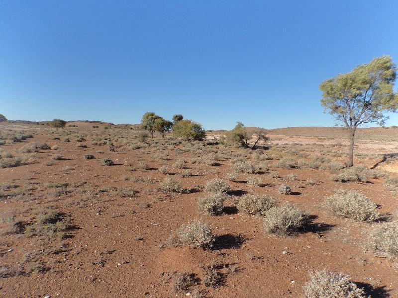

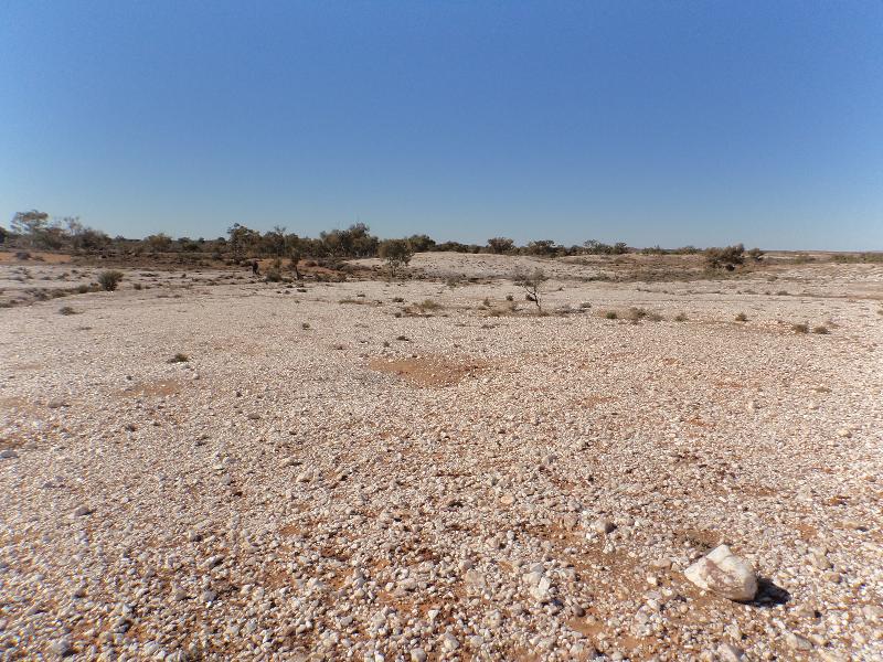

Well last week I cured my EMI problem I drove 1200 KM into the Australian outback of North West New South Wales, right were the borders of NSW, SA and QLD meet,
the only thing out there are idiot prospectors, roos, emus and goats and rocks, , anyhow tried the Vallon with the 1" foil, NO GO, the 1.5" was detectable at about 2-3 inches, tried a quick ground balance on the horrible gold field ground but it was doing strange things, lots of hot rocks, as I was on the top of a hill in a bitterly cold wind, I had no patience for messing about, and gave it a miss, and went on detecting with my 4500 and various coils which handled the ground OK, even got a little gold.
Should have tried again but didnt.
BTW a 7000 will find the "invisible" nuggets a 5000 will not and vice versa, also had to use my 4500 and sadie coil to pin point a very small bit that a 7000 could not, he could have dug a lot of dirt to get it, but that was not the point.

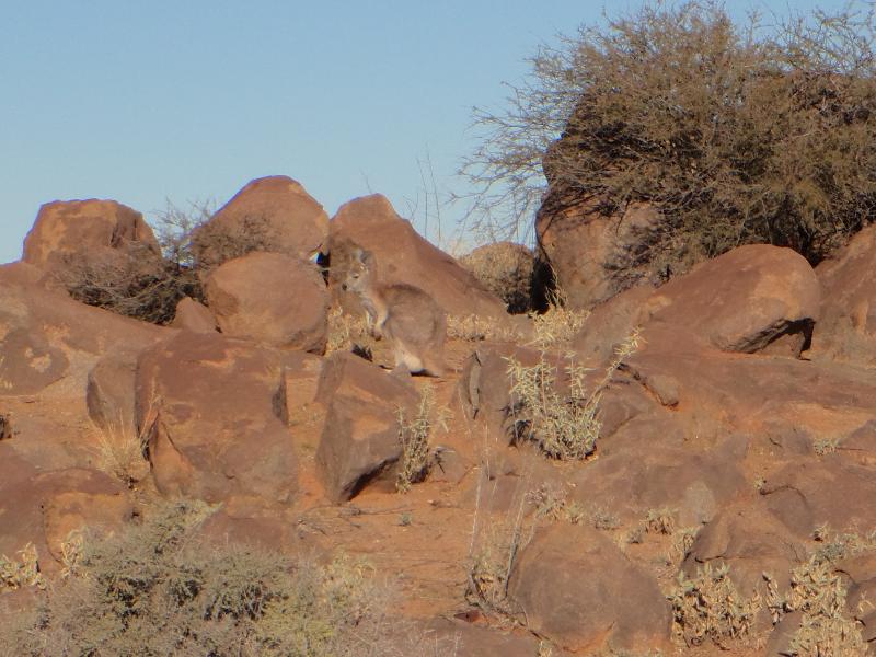

can you spot the roo ?

Sounds similar to my Vallon experience yesterday ....Good in milder ground..
Great photos!....And yes, I just found the roo
You are being watched!

Ha ha...good luck figuring out where the gold is from the photos...A big place is Australia
No snakes...to cold at the moment!
Thanks for the info and pictures.
Good looking country, looks like maybe around Tibooburra?
