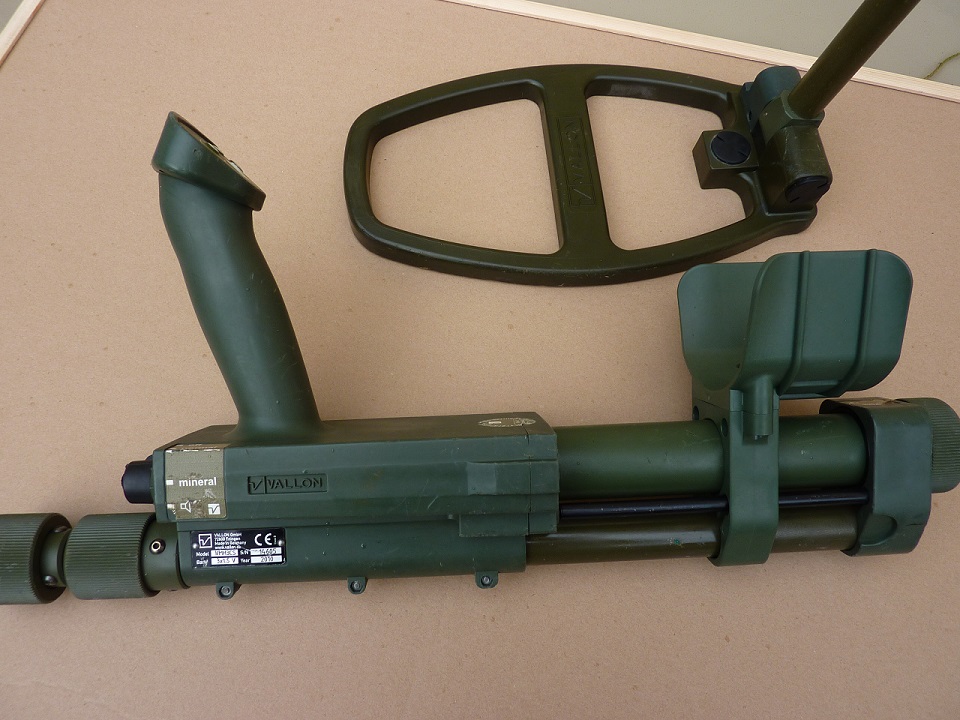

        Hi Dave,
        Yes, initially it looked daunting, but having taken quite a few apart now it is relatively easy, and I have all the right tools to hand. It is now half way back together and will look really smart. The inside electronics still looks brand new as it is so well protected. I did however discover that one O ring on the back of the female 7 pin connector in the shaft is missing. Vallon's QC slipped up that day.

          After the big strip down the was the equally big reassembly. A new armrest had to be fitted, but all the rest of the parts are as in the previous pictures (posts 1114 - 5), but now cleaned up. A couple of O rings were replaced and the missing one on the 7 pin connector is now there.
          After the assembly was completed a full test was made of all functions and everything was up to spec. What appeared to be fit for the skip, now has a new life

            Hi Eric...Thats an amazing transformation.
            • Hi Eric: Looks like you been busy! Very nice clean up. I can't help but notice in the before and after pictures the British ID tag is missing. They choose a small square tag placement just to the right of the larger VALLON tag rather than the opposite side of the main body where you see the rectangular indention with two small holes for rivets. All VALLONS sold in the US look like this. It is evident that that machine was in the middle east from the tell tale red dust throughout. My rant is because all US VALLONS come with the 3.16 firmware installed as the British requested the 3.0 version. If it has the confidence click, 3.0 & if not 3.16. I'm sure you would have caught this though. Again super job.

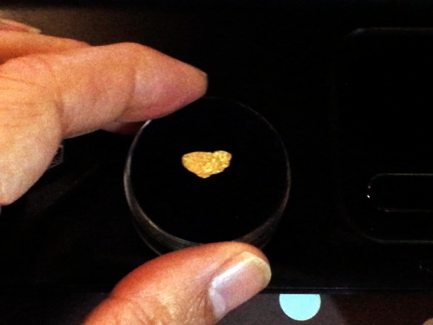

              • My Vallon can detect a jean rivet at 30cm depth, but it's blind at all to this 0.3g flat gold nugget. My MiniPulsePlus can see it at 3cm though.
                What are your experiences with gold nuggets and the Vallon?

                    Interesting!....I know my Vallon can ping my 1.8g and 0.8g test nuggets...they are round nuggets. I guess the shape and thickness of the nugget would change the TC....I think...
                    I also know it can ping a 0.5g round bit of lead shot.
                    It can also signal on the smallest bits of metal scrap.
                    If there are any land mines where I detect, I am confident that I will find them

                      What do you use to clean, warm soapy water or mineral based cleaner Eric?
                      Brian

                        For my machine I used home cleaner soapy, water and finish it with silicon grease. The result is excellent: the grease give it a polished lubricator aspect and preserve it from humidity
                        • I read in an earlier post I believe, Eric used warm soapy water and ArmorAll Trim and Plastic Restorer. Made mine look like new again.
                          Carolina
                          • Yes, that is correct and you can do a good external cleanup without taking the detector apart. Use of an old toothbrush with soapy water (washing up liquid) can get rid of the dust in the knurled shaft locking collars and their internal threads and when dry, brush in some ArmorAll. Finish threads with a very light smear of silicone grease.
                            Eric.

                              • I have found this yellow paint on a few of the Vallons I have. I believe that it is paint that is sprayed on the ground when a potential mine is detected, and it is quite difficult to remove. I used MEK; a cleaning fluid for pvc piping prior to doing a solvent weld. I first checked that it did not affect the case or coil shell of the Vallon as it is quite an aggressive fluid. Perhaps paint brush cleaning fluid would work as well.
                                Eric.
