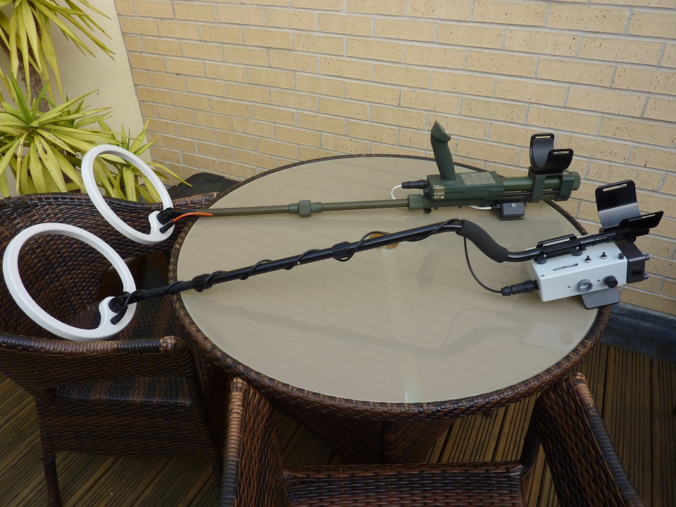

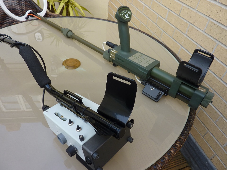

                      • Brothers in Arms
                        At the back of the first picture is a previously modified Vallon with a new arm rest and ground stand. Also mounted on the stand is a box containing the components to convert the audio for standard phones. The new modification is to incorporate a 11.5in fully submersible coil using a Whites shaft end which makes for a neat job. This fully shielded coil gives an improvement in detection range over the standard Vallon coil and looks more the part for a treasure detector.
                        In front is the latest rebuild. The 4 pushbuttons on the original control and LED display plate are replaced by (On)-Off-(On) momentary switches. The forward one being + and - and the rearward one C and pinpoint. Labels will be designed shortly to identify all the features. Power is two parallel 3.7V Li-ion cells in the rear box with a 1/4 jack socket for standard phones.

                        • hi eric..a very well done job on both detectors.
                          • Eric: Very nice. I particularly like the VALLON in the rear. Three different shafts on three different coils would be a quick and easy change say from 8" to 12" to 15". Have you thought of a 8" or 6" coil yet?
                            Carolina
