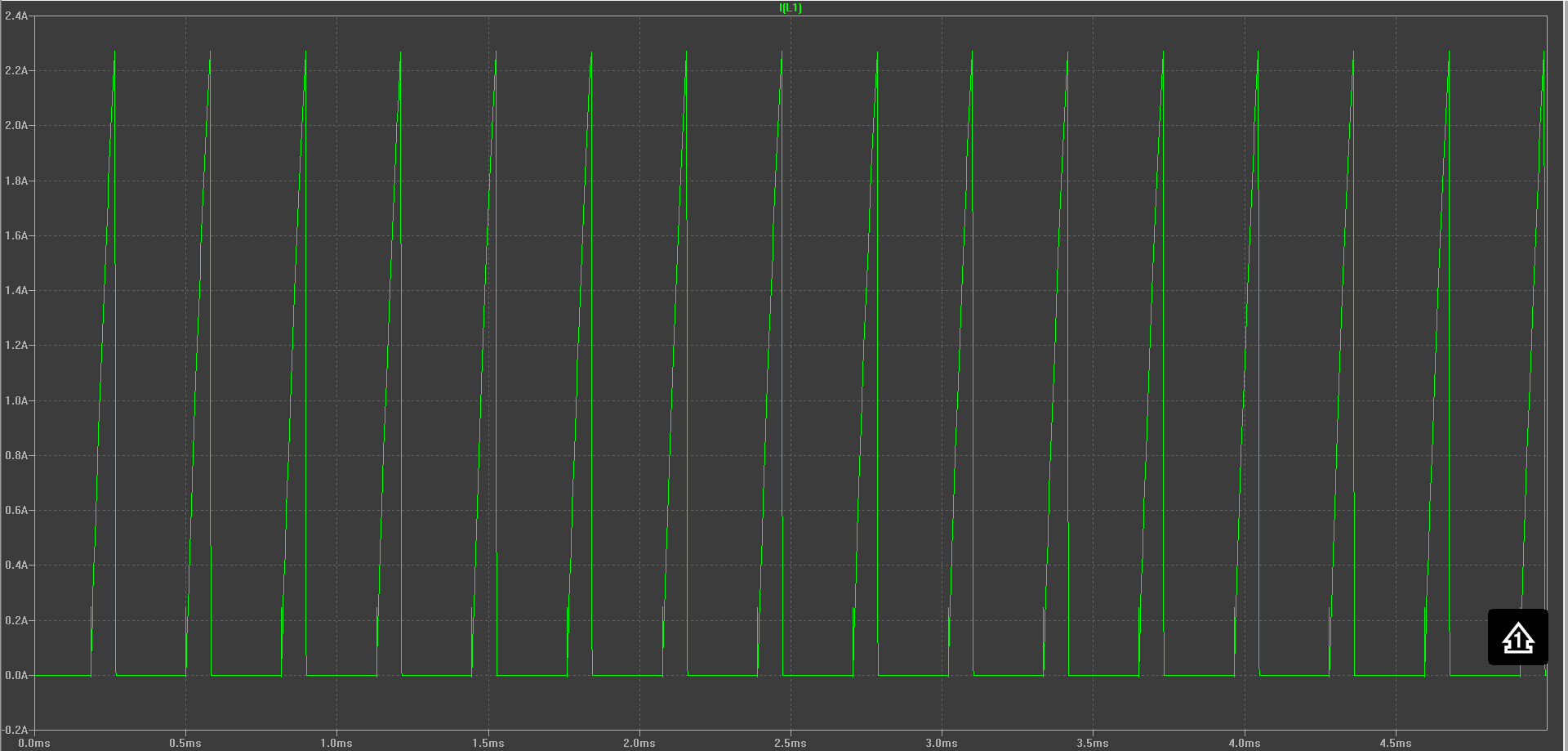

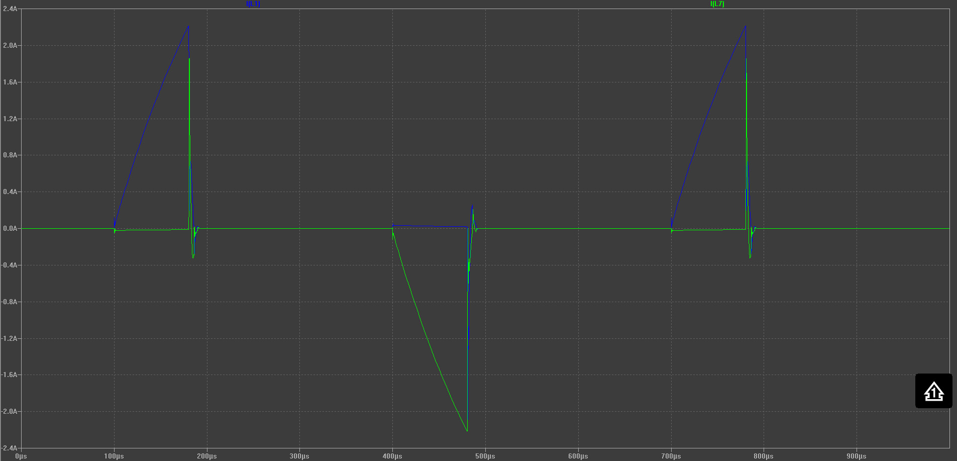

    whats the total current draw of your manta metal detector ???
    For this test, battery Lithium Ion near full charge 16V, current 2.278A view : single pulse mode Click image for larger version
ID:	345818 bipolar mode :Click image for larger version
    But I can increase the current with PIC32 Max 3.1A
    And you ?
