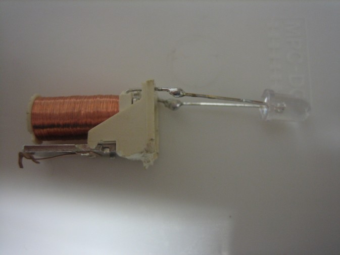

      How can you detect if there is a flyback pulse ? Good question.
      Maybe some sort of pickup coil and a speaker that is kept close to the search coil ?
      The pulse width is 100 microseconds and the period 2 milliseconds, resulting in 500 Hz, with a duty cycle of 1/20. Not sure if you can pick this up as an audio signal.
      I never tried it this way, and there may be other ways to verify it, like touching the coil pin and ground with left and right hand. You should feel someting...
      Again, this is why the COIL ERROR sound proves to be helpful. At least it points towards the front end = BS170, IRF740, coil, LM318 -> pin 8,9 of the PIC.

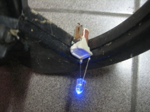

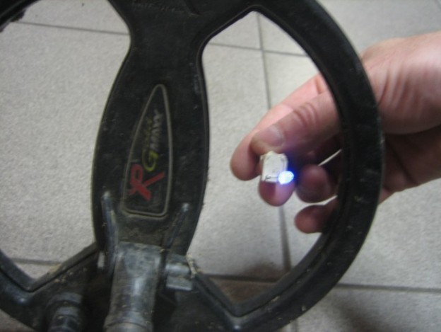

      • To check if your coil is pulsed or not, I once made a simple coil tester from a 5V relay coil and a hi-bright LED. As you can see in the pictures, it also works on a VLF detector (XP GMp):

        • Originally posted by F117 View Post
          [ATTACH]37828[/ATTACH]
          [ATTACH]37829[/ATTACH]
          [ATTACH]37830[/ATTACH]
          Looks cool
