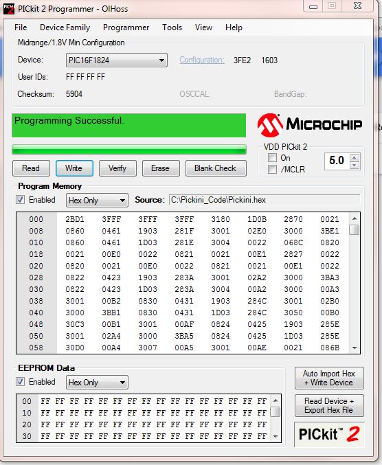

          • Eclipse, thanks so much for your post above about the PK2DeviceFile.dat substitution! Your post was very helpful.
            If you are using the PICkit 2 programmer, as he noted, download his file and rename it PK2DeviceFile.dat in the directory Program Files (x86)\Microchip\PICkit 2 v2\
            In the PICkit 2 software, choose "Device Family", then "Midrange" then "1.8V Min". The 16F1824 can then be chosen. You will also have to import the source code from F117's files to burn the PIC.

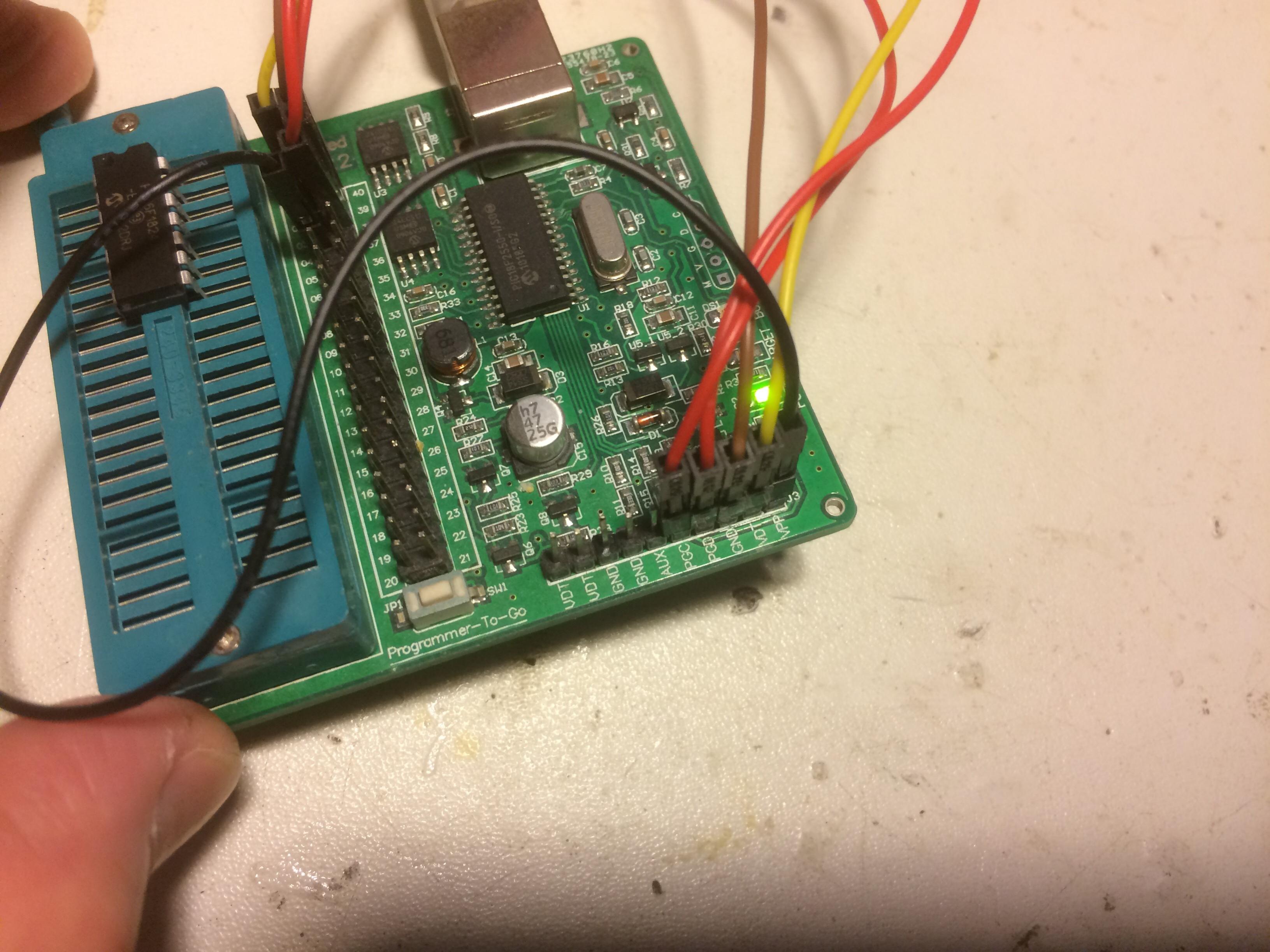

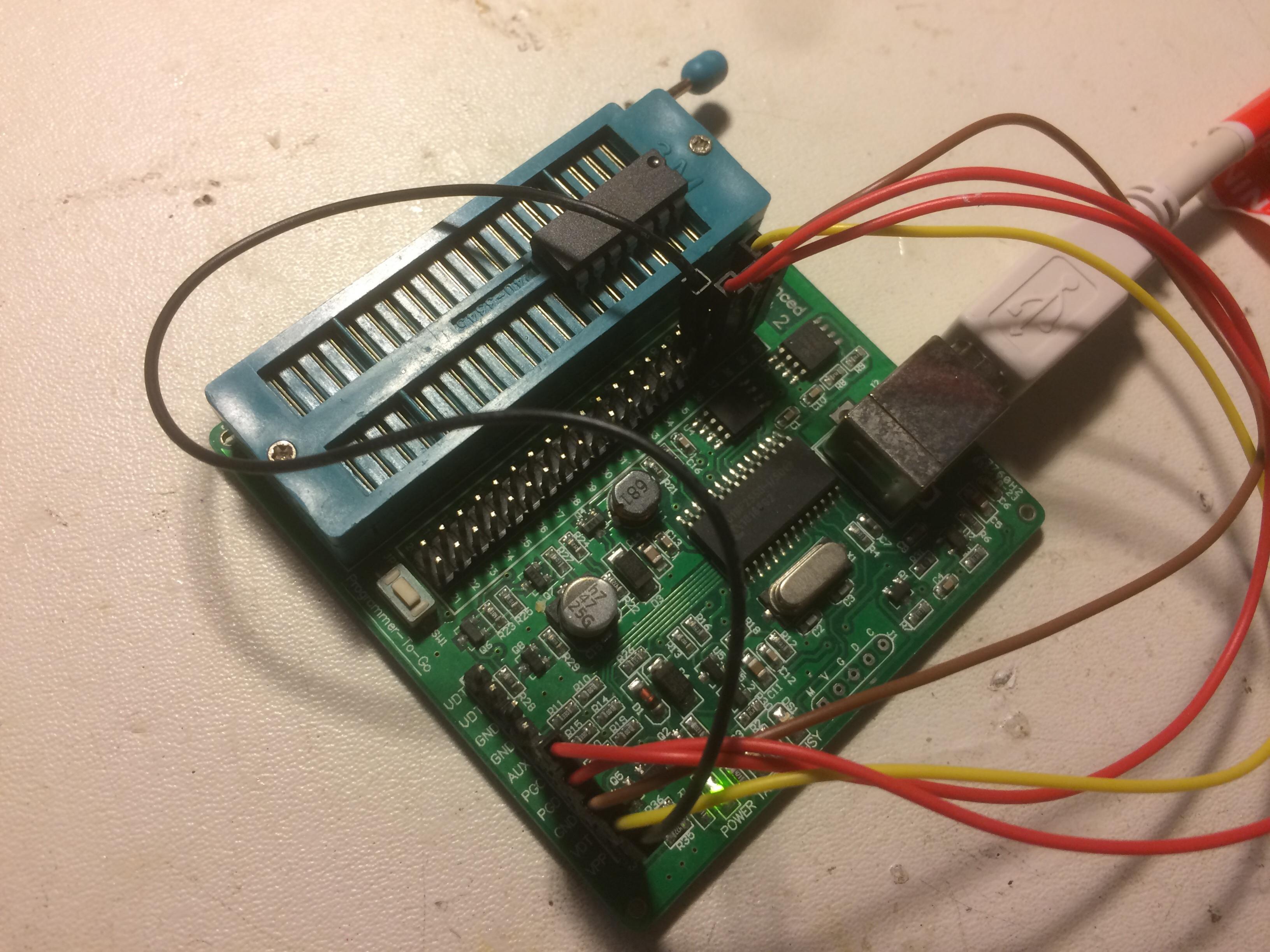

            If you are using the Enhanced PICkit 2 as the programmer the connections to the 16F1824 pins are:
            GND --> pin 14
            PGC --> pin 12
            PGD --> pin 13
            VDT --> pin 1
            VPP --> pin 4
            If you place the PIC in the top of the ZIF socket, which is numbered 1 though 40, the corresponding numbers are:
            GND --> slot 40
            PGC --> slot 38
            PGD --> slot 39
            VDT --> slot 1
            VPP --> slot 4
            See below for a screenshot of the PICkit 2 software and some photos of the PICkit 2 set up for the 16F1824.

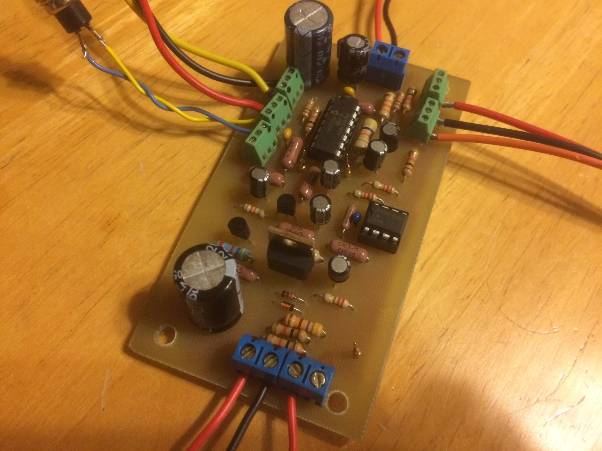

            • Incorrect voltage on LM318 pin 5
              I hooked my new board up tonight, but it's not detecting after connecting it to one of my PI coils. Here are my voltages at the pins for 16F1824 and LM318

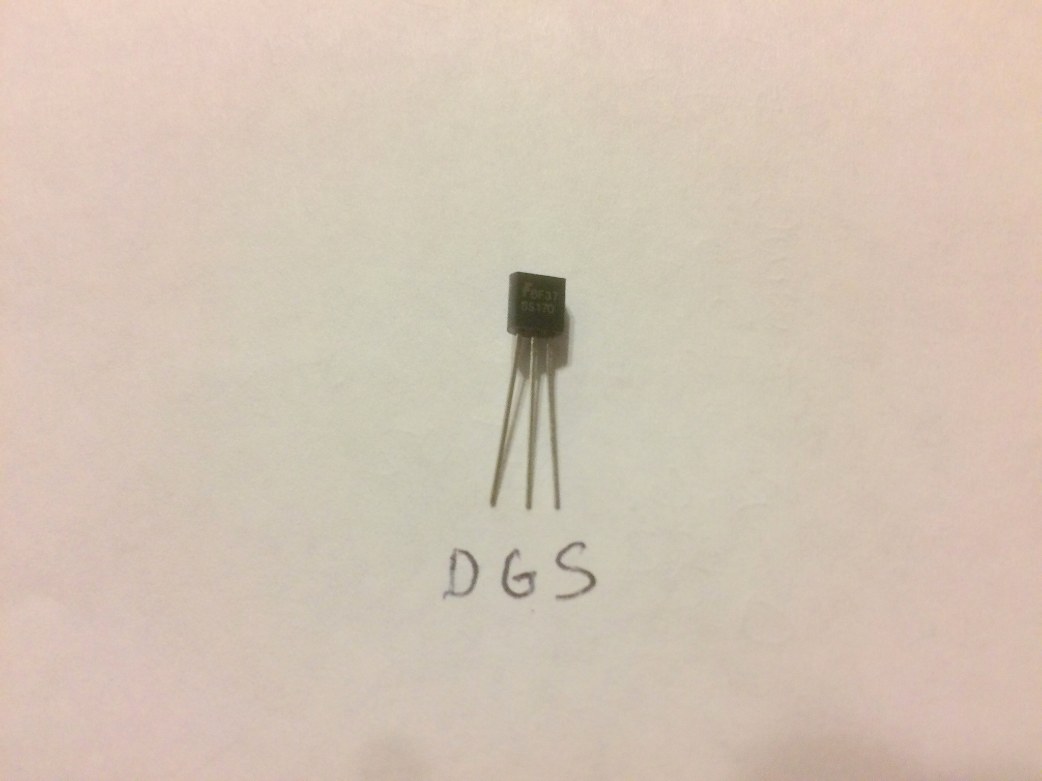

              I may be having the same problem that ripsdevala had--high voltage on pin 5 of the LM318 because of an improperly oriented BS170. I'm using a Fairfield BS170 that has a DGS pattern on the flat side. See photo below.
              I have also attached a photo of my board with the flat side of the Fairfield BS170 pointing at the 2200uF cap. Should I change the orientation of the BS170 so the flat side faces away from the 2200uF cap? Or can someone tell me what is the proper order of D-G-S on the PCB?
              Right now, I'm hearing the opening tones when I connect 12 volts to the board and a continuing slow click, but nothing else.
              Thanks!

              • BS170 connections on my original schematic
                http://users.telenet.be/willaert/MD/..._schematic.png
                D: R10 = 4k7
                G: R21 = 10E
                S: GND
                • Right now, I'm hearing the opening tones when I connect 12 volts to the board and a continuing slow click, but nothing else.
                  After a while ( ~30s ) you should hear a continuous low tone = COIL ERROR when there is no flyback puls ( possibly caused by BS170 )
                  • According to this datasheet of the BS170 from Fairchild - the orientation on your board seems ok:
                    http://www.farnell.com/datasheets/2164079.pdf

                      Thanks for that. I was hoping that I had it oriented incorrectly so it would be an easy solution.
                      If the coil is not connected, would the voltage on pin 5 of LM318 be high, such as I am seeing?
                      Is the slow click after the opening tones normal?
                      Any suggestions about what to try first? I guess I can replace the BS170.
                      • Power on -> welcome sound -> slow tick -> and do you hear a constant low tone after about 30 s ?
                        • Originally posted by F117 View Post
                          No, I hear just the welcome tones and then the slow tick. If I press the momentary switch, the process starts over with the welcome tone. Just curious, what is the frequency of the low tone?
                          • If I press the momentary switch,
                            What momentary switch? The pinpoint switch ? This should not reset the controller.
                              Yes, when I press it, the PIC resets. I'm going to trace the entire circuit out and see if I have a bad solder joint. I'll report back what I find. Thanks for your help.
