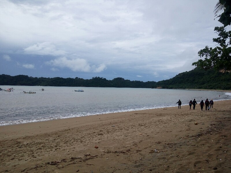

    I was on the beach yesterday for 3 hours, this detector cant withstand iron sand, the only way is to decrease the sens so it will reject iron sand, when i try to 2.5cm brass coin it detect at 15 cm with low sens, not a half of 10k resistor, when use more sens, it will beeping continuously, on the beach the detector behave almost like at home, its somekind get emi interference there, its a shame I don't have the video, I lost part of my shaft on the way there.
    And I can't find anything, even a nail.... Idk

          Yes, i use all the procedures, last time its okay, doesn't get emi with almost at max sens, there is no black iron sand, crowded beach many garbage on small beach.
          On latest beach, much washed iron sand bellow beach sand surface, navy base near there, long...long beach, few tourist, isolated beach

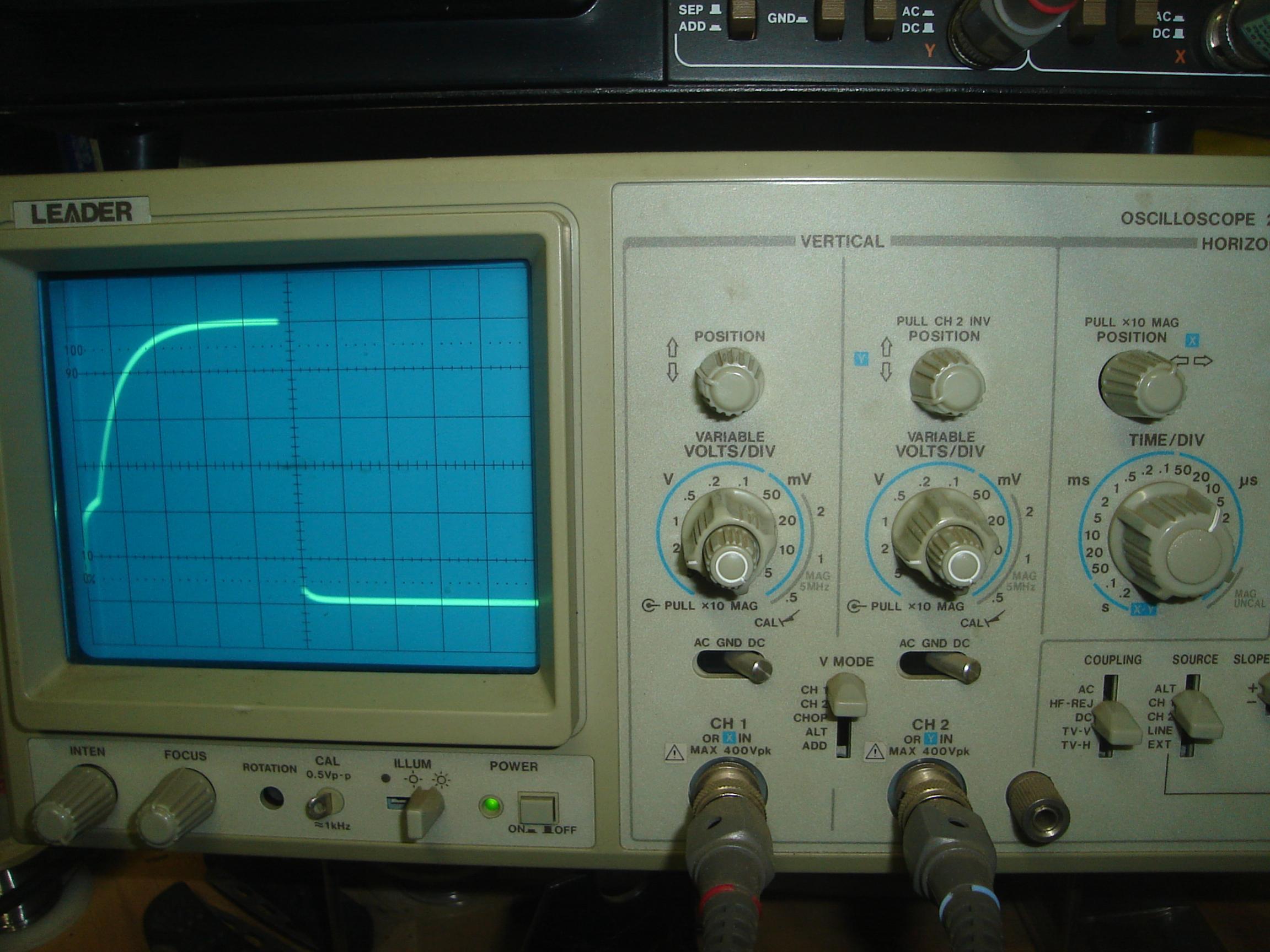

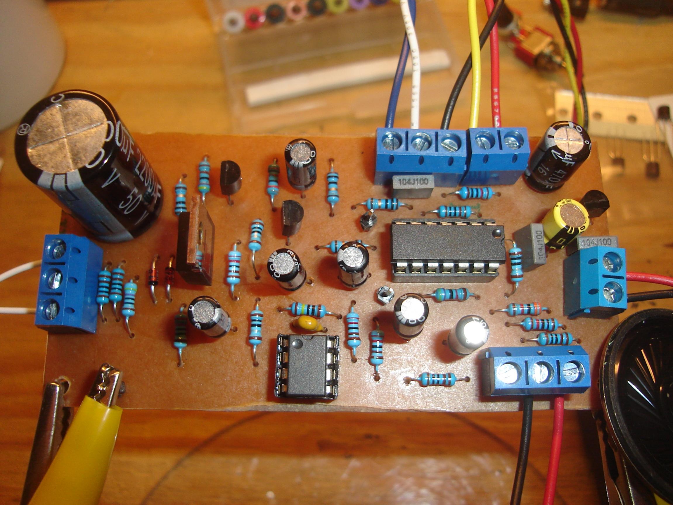

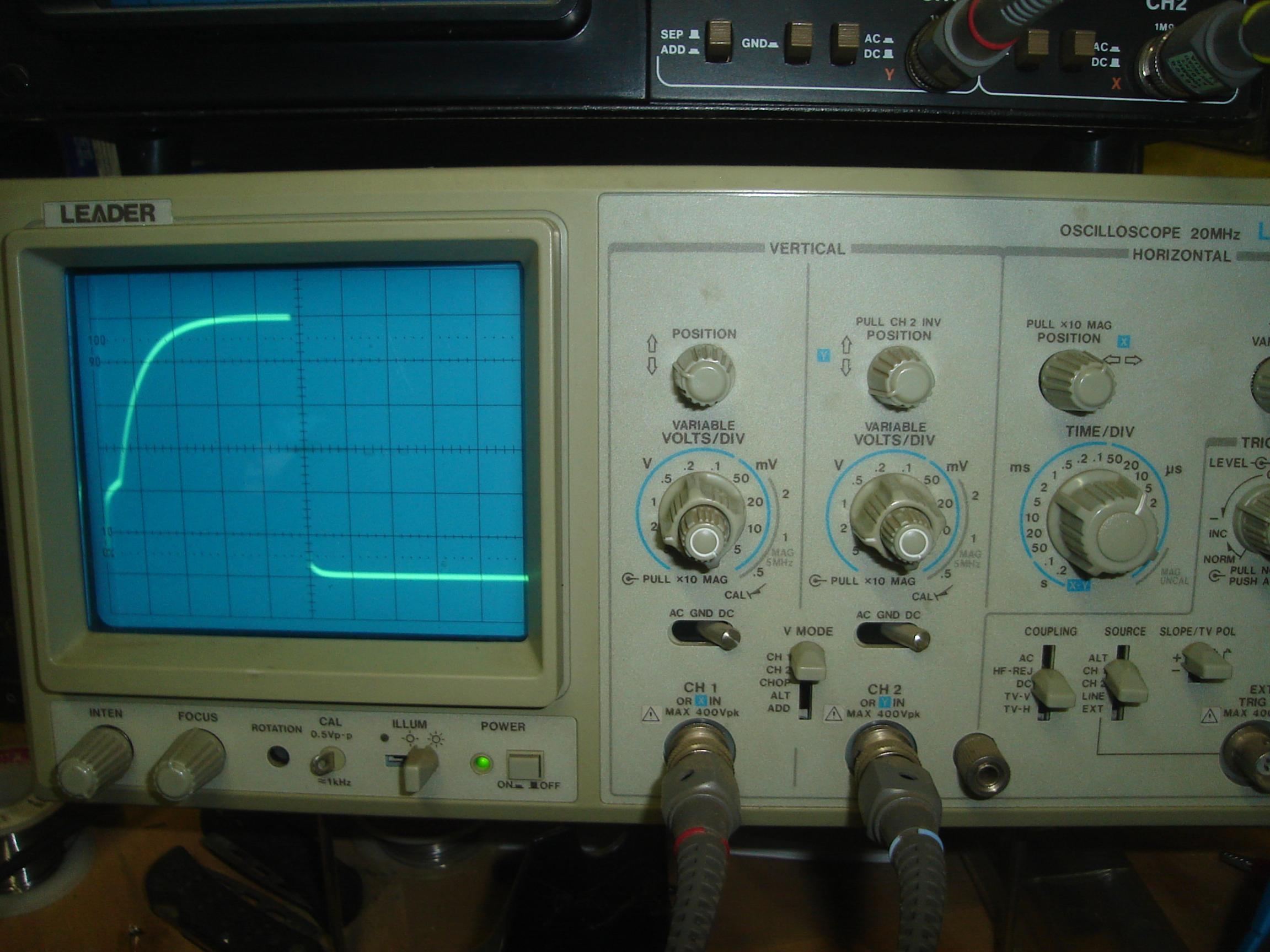

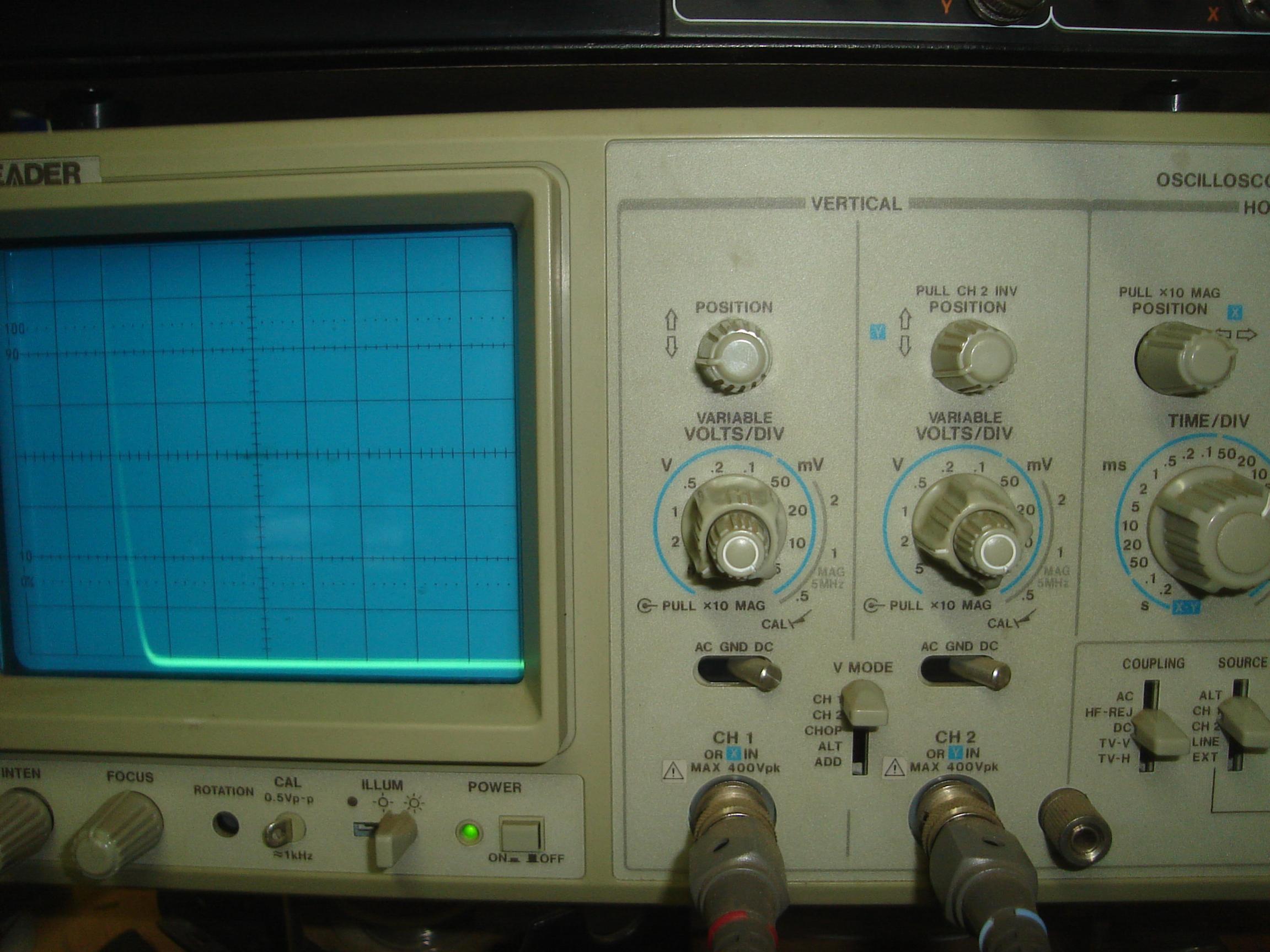

            Well finally finished up my pikini, seems to have loaded hex correctly as when firing up the board it gives the initial double beep, then goes into a slow tick for about 25 seconds but then goes to a constant low tone with no detection.
            Everything is connected correctly but did see where the bs170 may have different pinouts, not exactly sure how to check that to make sure it is placed correctly but I did connect the scope and added some shots below.
            It looks as though it has the pulse, the flyback and the pulse at the gate of the fet so not sure what to look for as what may be causing the issue other than the bs170.
            Any ideas??
            voltages below along with scope pics.

            • pin 10 PIC voltage is wrong - it should be more than 0V - this is the reference voltage for the internal comparator. This is generated as PWM from pin 2 and filtered with R19 / R20 / C13 and then fed into pin 10.
              Check this voltage with the scope during the initial calibration cycle.
              The other pin of the comparator is pin 8/9. Measure there with the scope, this should be a negative going flyback pulse from 5V down to 2V.
              The pulse to the IRF740 gate should be 100 microseconds wide.
              The low tone after the calibration cycle is the COIL ERROR sound: no flyback is detected at pin 8/9 inputs of the PIC.
              At first sight, I don't see anything obviously wrong on your PCB.
              I assume you used the hex file as is, and not rolled your own ?

                    I rechecked the voltage at pin 10 with my scope and still get no response or 0v. I tried the headphone test and can clearly hear a tone which is saying the coil is being pulsed, at least that's my understanding from other builds.
                    I measured pin 8/9 with scope and it definitely goes from 5 to 2v but is positive going, not negative. I used the tp on board for this test.
                    checking the coil with my scope leads across the coil connections gives a good signal (as shown in previous pics).

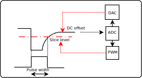

                    • You could also check pin 2 with the scope: this should be a PWM output, that provides the comparator DC reference after filtering.
                      The ticks you hear after the welcome sound have no relationship whatsoever to the presence of a flyback pulse.
                      The flyback pulse at the test pin of the PIC should have this form : 2V bottom, 5V top
                      The "slice level" is the filtered PWM DC voltage to the comparator.
