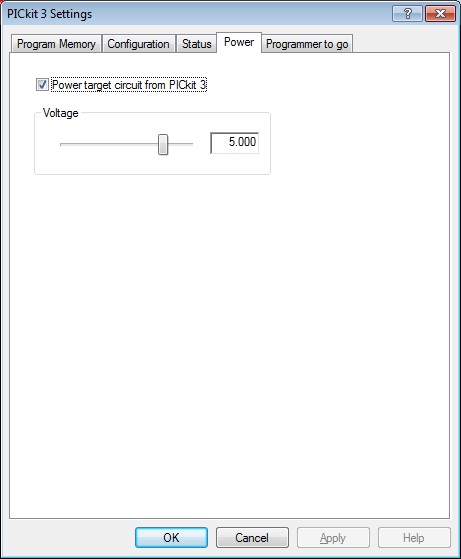

            • Hi,
              I've just received my pickit 3 with adapter board.
              I've installed MPLAB IDE v3.50, MP X LAB IPE v3.50 and PICKIT 3 v3.01.
              I did not try yet mikroC but i'm not sure my unit is working properly :
              When i lauch pickit3 and search for device, i get a message : "Unsupported part (ID=2740)"
              and in the DEVICE FAMILY menu, the PIC16F does not exist.
              The adapter board is set up as writen on (DIP14 : J1=B, J2=2-3, J3=2-3).
              I can't find anything about this on the NET but maybe i'm searching with the wrong keywords.
              Thanks for help

                • Your configuration is same with my clone pickit, try another chip, maybe you have defect one
                  • Check the power supply from PICKit 3 - 5VDC to the microcontroller.
                    • Hi, thanks for help.
                      I'll check for config file installation.
                      I measure 0v between VDD and VSS on the adapter board but i've checked the connections between pins of the chip and output of PICKIT3; everything is fine.

                      • You have to enable power from the PICKit3 adapter ( from MPLAB: programmer->settings-> power-> power target circuit from PICKit3) to the device.
                        Hope this helps,
                        - Bernard

                          • OK,
                            Thanks,
                            my issue was simple. As F117 says, this was a power ON issue .... So simple !!!
