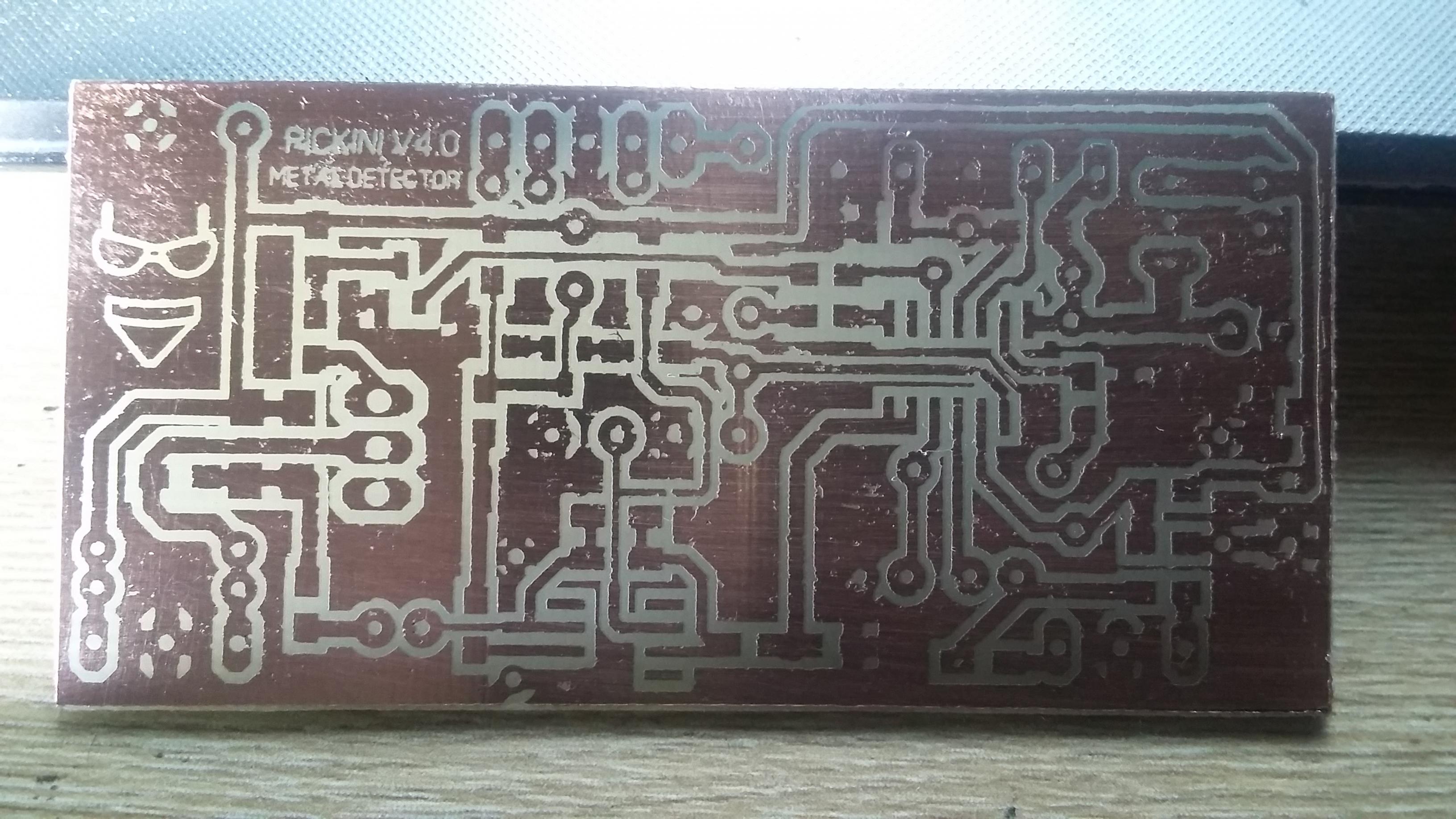

            but i m cheater ,i ve made some mod on capacitor because i fed up waiting for aliexpress smd capacitor GRRRRRRR!!!
            so now it s not 100% smd (maybe close to 70%! LOL)
            look at my pcb ,on the left its a bikini to illustrate the detector (isn t it bernard???)
            • nice, but pay attention you have some broken tracks too
              (i have problems with photo method my exposure was 30 sec to short and the etchant for the photo laquer was too strong)
              just solder a wire on this places, for this it ake the cut off wires from normal resistor or the legs of To92 part
              • @Nick: nice PCB with nice logo .
                Looking forward to seeing it stuffed and working.

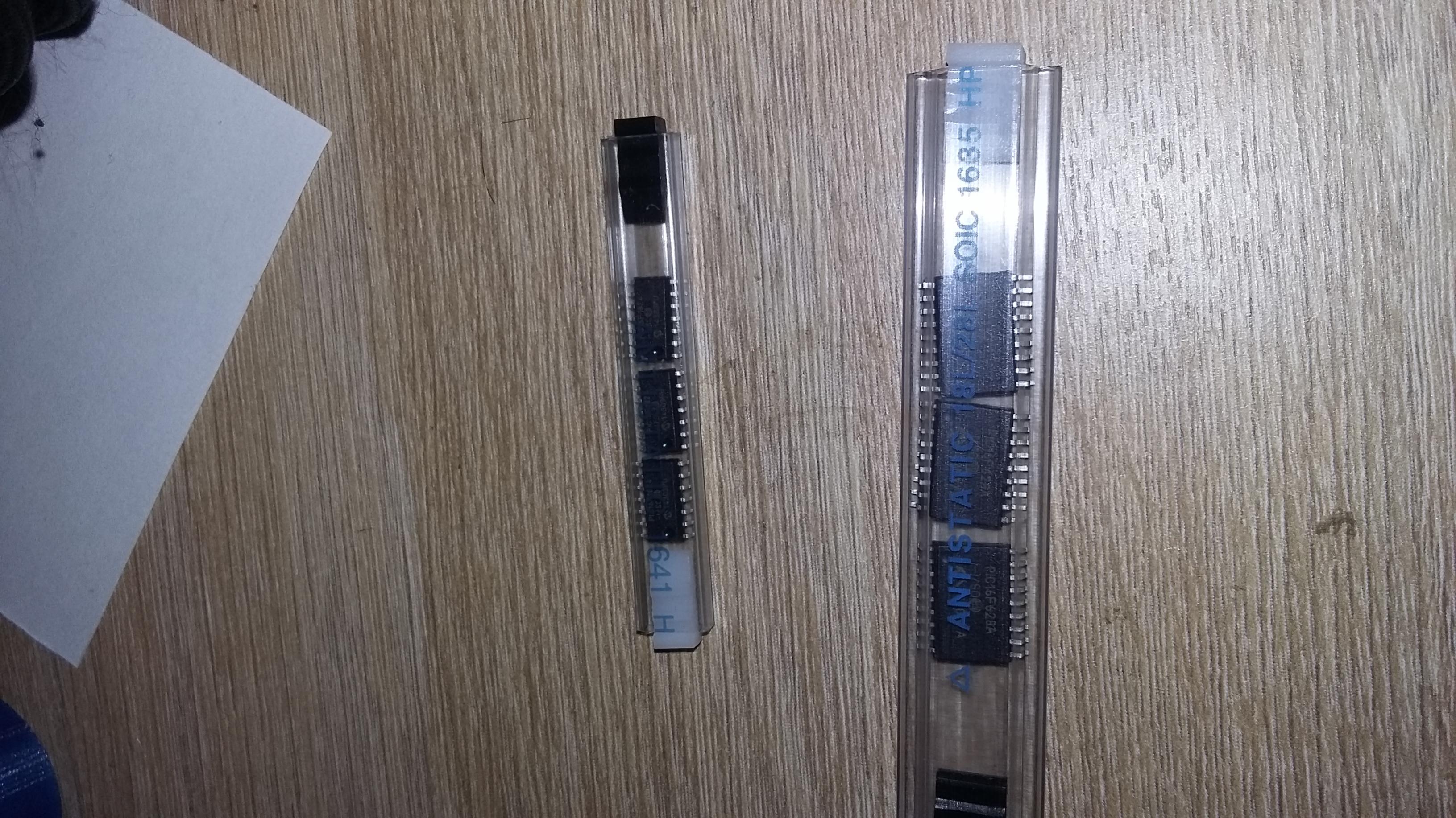

                                bernard look what microchip has send to me today!!!!!!!!! (foto!!pic16f628 and pic16f1824) its very cool to them ,no?
                                now just need lm318 smd and ......... power!!!
                                my pickini in DIP version don t work very good suddenly !!!!! once on tree it gives me false sound for coil and not very good deph(air test)!!!!! +/-10cm for 2€ ( will try to make some test later)
