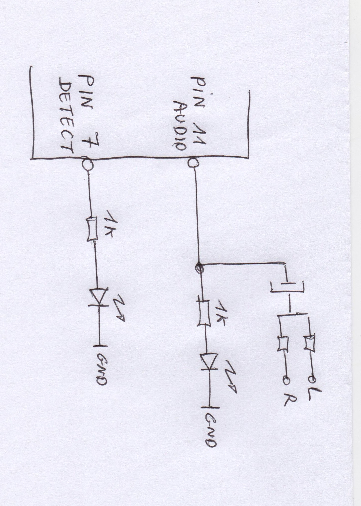

    • why does the light flash all the time, where is it connected to?

          • The LED in the film of Rodrigo is connected to the auido output.
            And yes, you can use BC547B - no idea about 2N7000.

                  • You should connect
                    the Led and 1k series resistor directly to the microcontroller pin, BEFORE the capacitor
                    • I made a mistake , follow correct
                      1)to conect a led
                      Before c15
                      ---resistor(1k)--(diode 1n4148 ) --led---to ground
                      --capacitor(c15)
                      Obs. Maybe the diode is not necessary, according F117

                        No, the diode is not needed.
                        The Led is a diode.

                          • Hi Popka-ru, I made this on my pickini v4 . I tried to draw it in the diagram.

                            • Upon general request: how to attach extra LEDs
                              - An extra LED to pin 7 = DETECT ON every time a target is detected. This is static high or low.
                              - Extra LED to the audio output pin 11 : when no target is detected, this LED will be 1 second ON and 1 second OFF ( 0.5 Hz)
