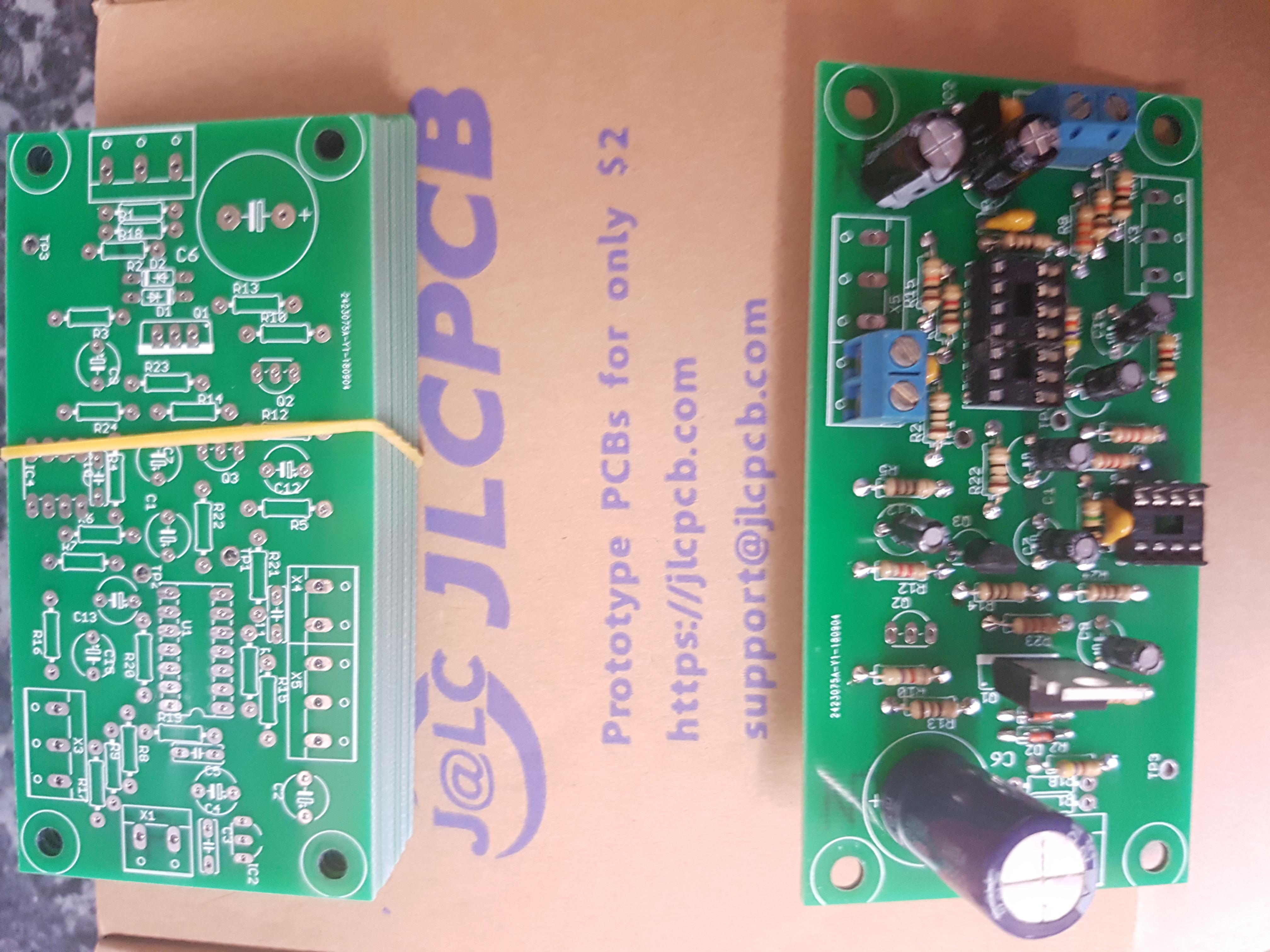

    back to building giving the drones a break just need the programmer now
    • Very nice PCBs.
      I once ordered 5 PCBs at https://www.allpcb.com/.
      Delivery time was about 3 weeks and my boards did not have the through hole metal like yours:
      • i think you have to order them double sided then they will put the through holes in, only thing is it is more expensive i like the through holes though, i didnt have to wait long for mine it was like a week but i think the programmer is on the slow boat

          • If you want through plated holes then you need to send them gerber files with through plated ones.

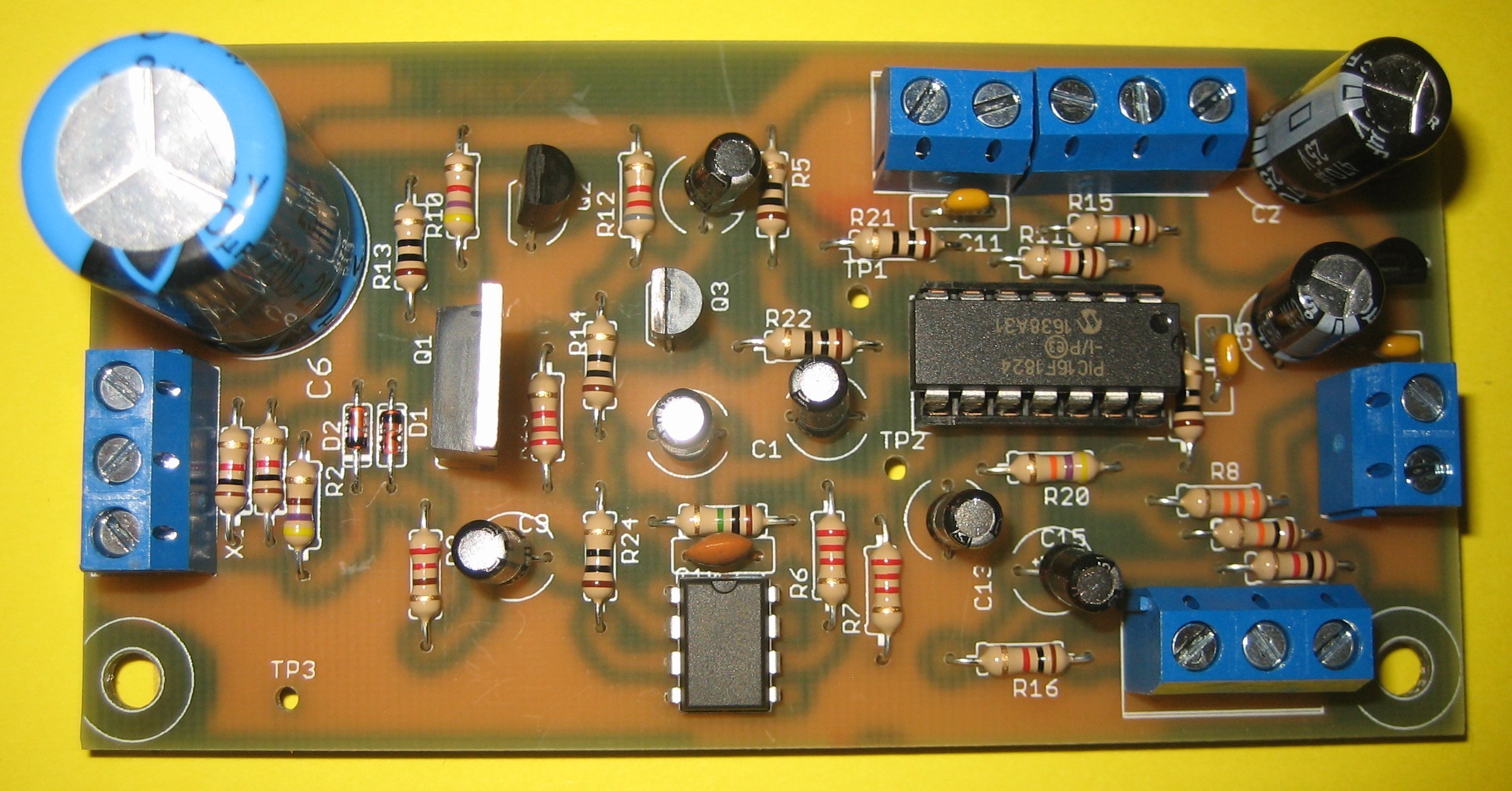

            • @BKY1337:
              I generated the gerber files from Eagle according to this tutorial https://www.build-electronic-circuits.com/gerber-file/.
              When I had sent them to AllPCB, I got an email to ask if they were double-sided.
              I then replied that this was a simple, single sided board and the only gerber files needed were:
              .drd = drill file
              .sol = solder side copper
              .plc = silk screen component side
              .sts = solder stop mask solder side
              This resulted in the board shown in the picture. I am quite happy with the result. Mask color is black and by making the modification from pseudo-double-sided to single sided, I got 7 boards for the initial price of 5.
              Not sure if this extra through-hole metal makes any difference ?
              I am quite sure, it won't influence performance.
              The main factor in performance is - as quoted before by MartyJ1963 - THE COIL !
              Best regards,
              - Bernard

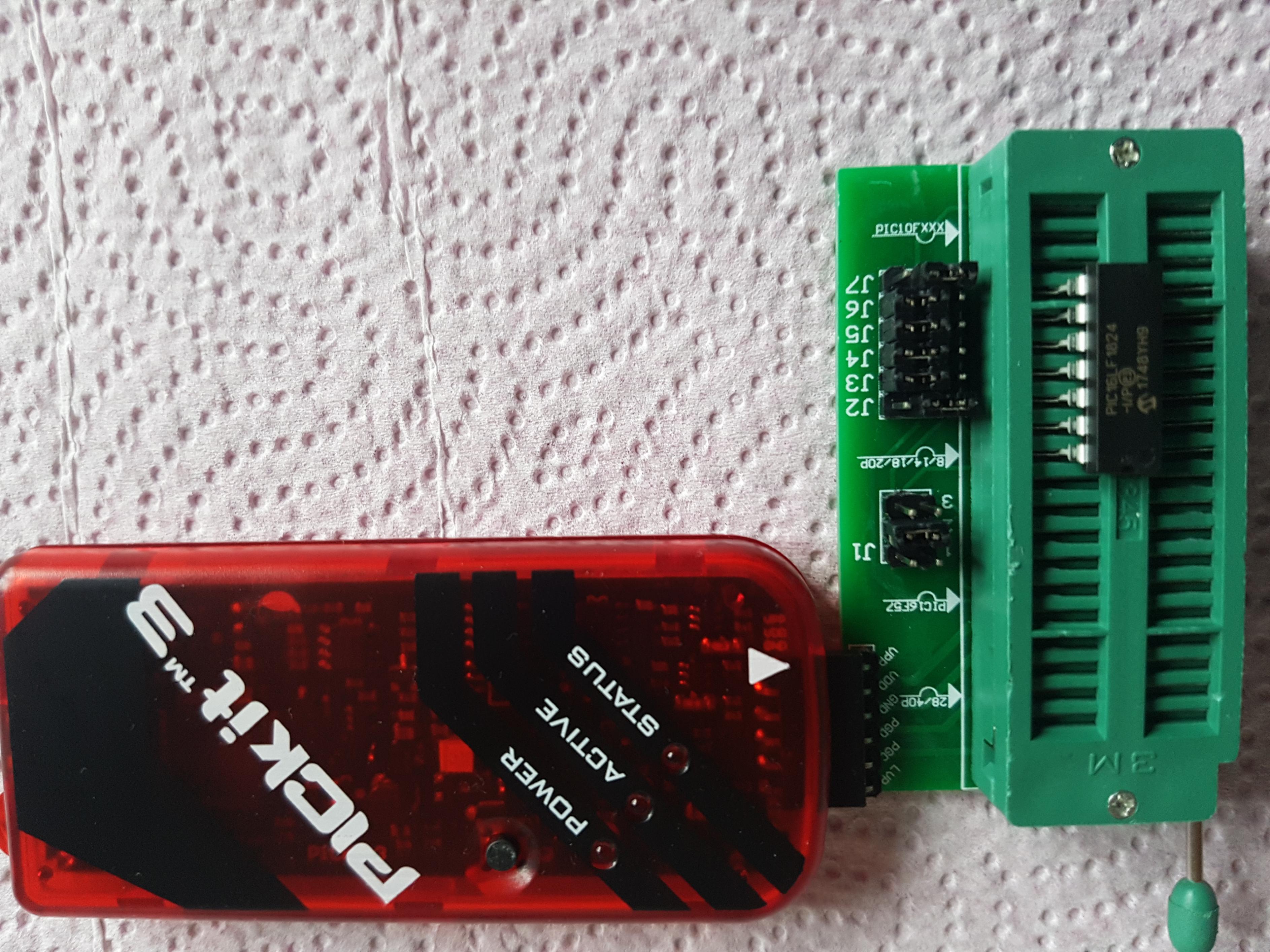

              • @kosacid:
                when I bought the Pickit3 at the time, there was no interface board included.
                So I made my own. Only the top 8 pins of the 14 pin package are required - to make it compatible with an 8 pin PIC package:
                http://www.geotech1.com/forums/attac...9&d=1478186444
                Connections :
                http://www.geotech1.com/forums/showt...749#post222749

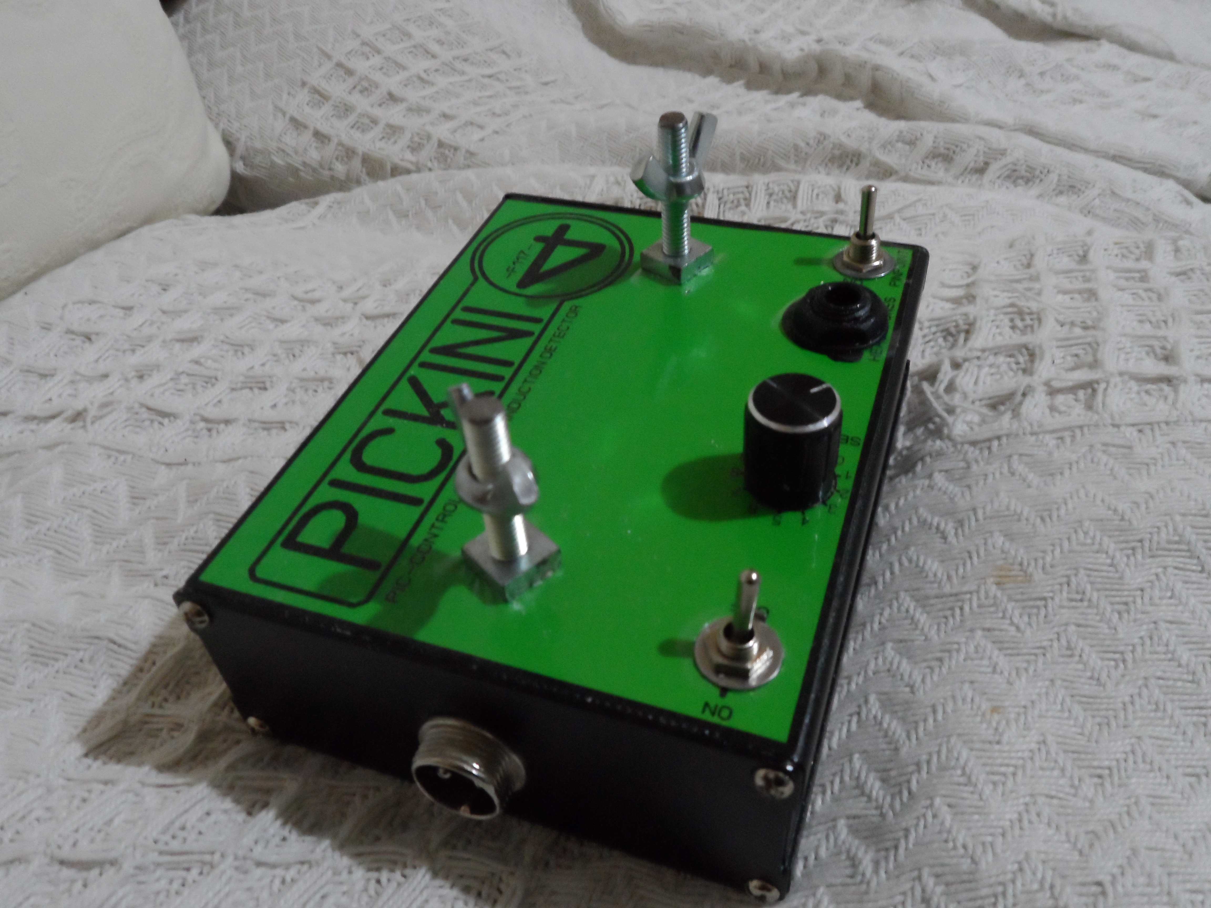

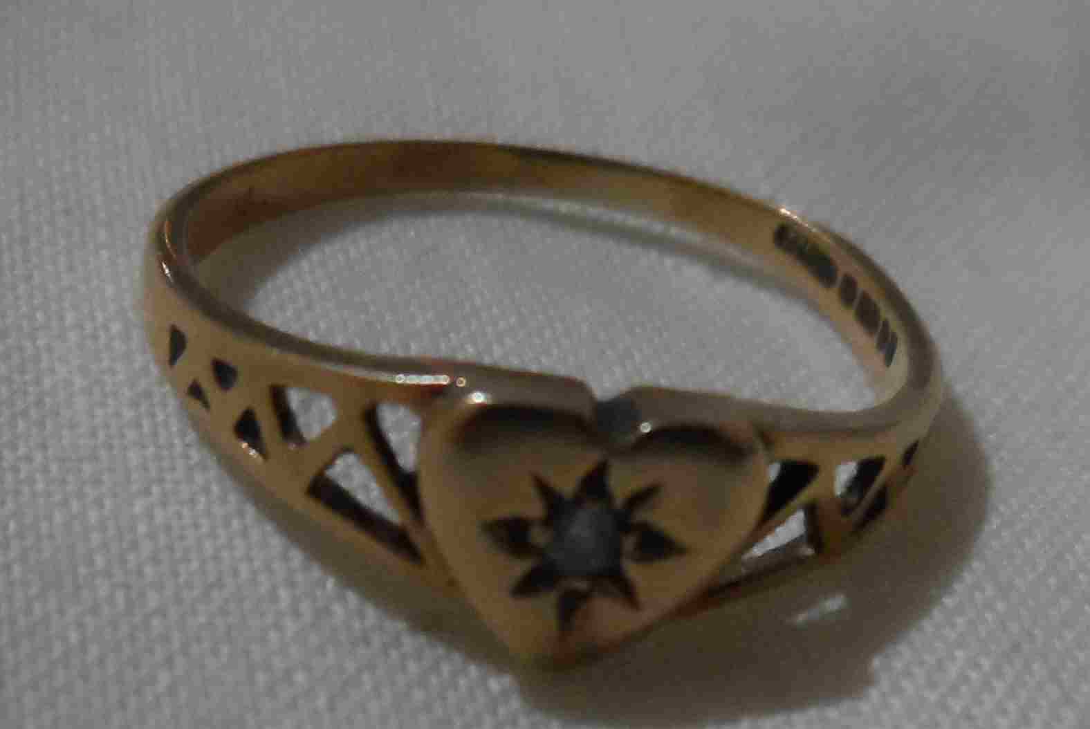

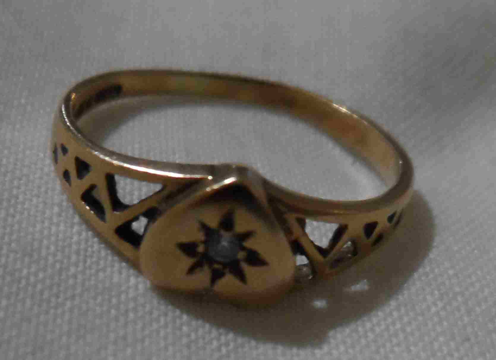

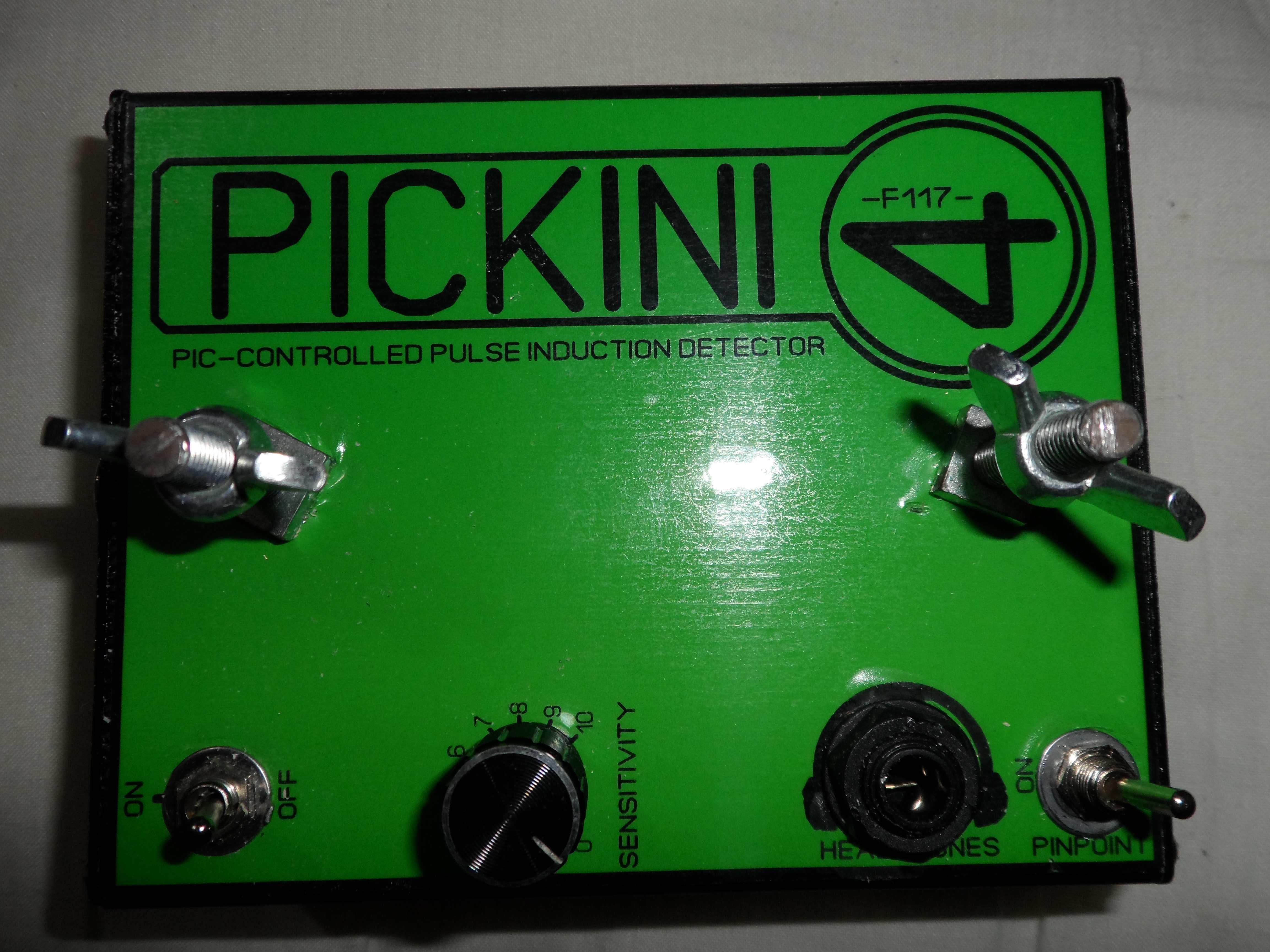

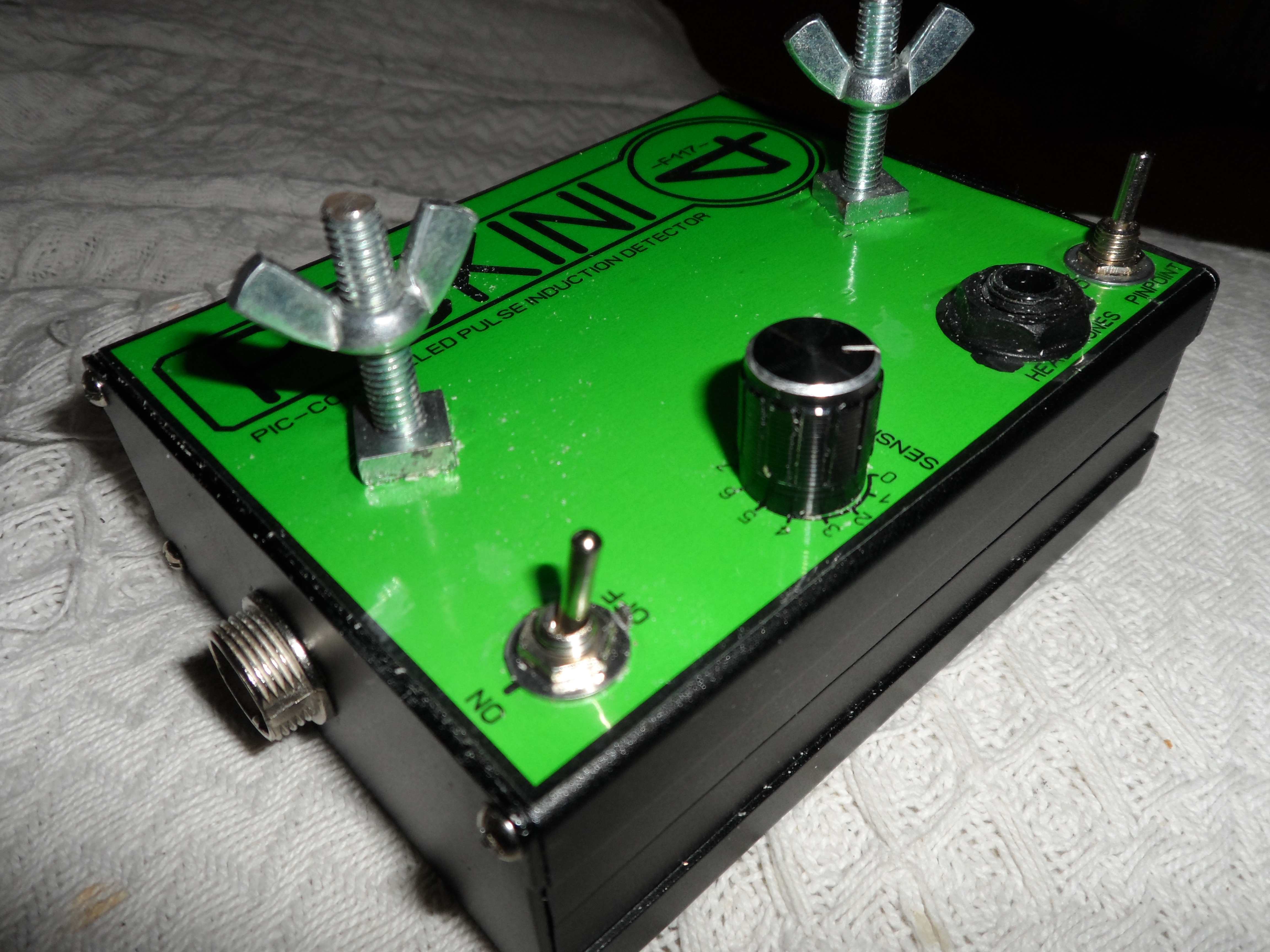

                • Hiya all,,,,I thought I'd finally better post some pictures of the ring I found and one of the Pickini's I made,,,I have made two Pickini 4's now,,both are housed in identical enclosures with the same decals. The enclosure measure '124mmX96mmX40mm' and is made of Aluminium.The basket coil I found the ring with was a 300uh made wth 16 strand/600v/0.5mm wire that came to 2.6 ohms. Great little project! Thanks. Marty

                    • I use sprint layout for my circuits and i think the through plating only works when i use a double sided layout.
                      I can mark the holes there as through plated.
