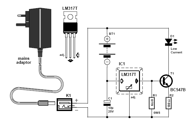

  • Marty,
    when you mean this charger circuit:
    The answer is definitely NO for LiIon !. It is current limited but is not voltage protected. Overvoltage will kill your LiIon batteries if not worse ( risk of fire, explosion..).
