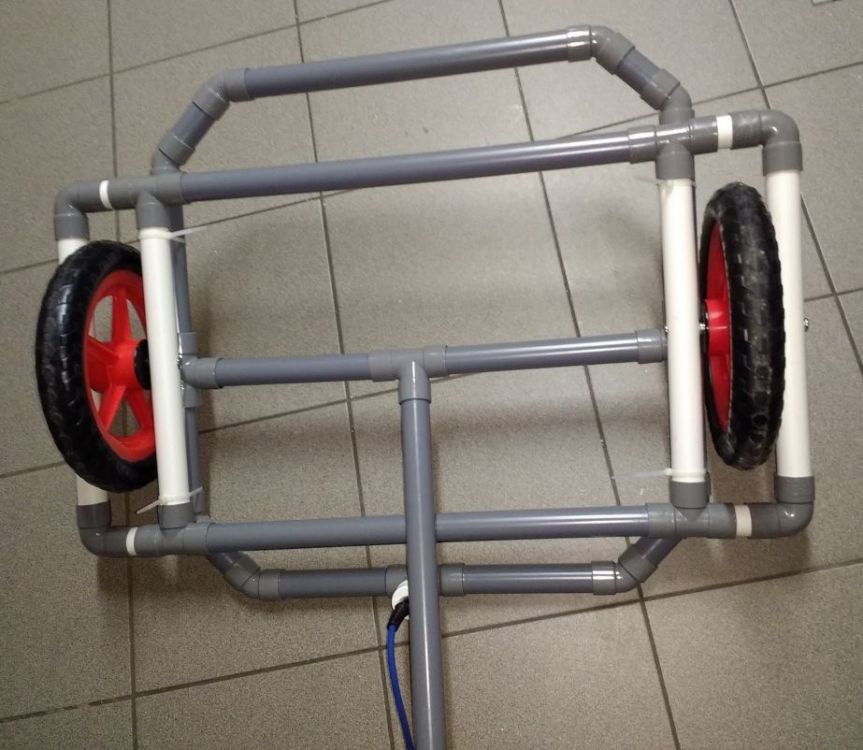

            The only time I increased this to 200 microseconds was for a 1m x 1m square coil to detect WW1 unexploded ordnance here in Flanders Fields.
            These grenades are typically 30-50 cm long and 10-20 cm diameter iron shell that can easily be detected well over 1 m in depth, resulting in a lot of digging. Well... I detect and mark suspicious targets and other people do the digging. There are still thousands - nobody knows exactly how many - of these things buried here.
            Increasing the pulse width to 200 microseconds instead of 100 also doubles the current consumption.
            Here is the square coil setup - on plastic wheels from a small child bicycle - and some "treasures" retrieved with it ...

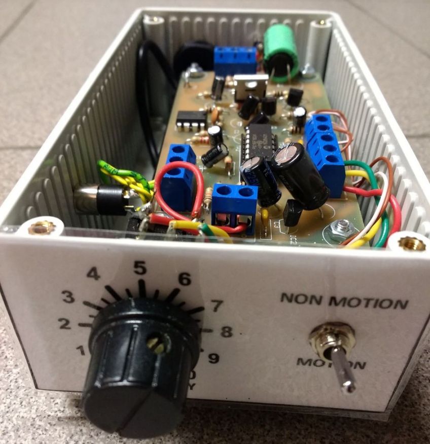

            Control box - hip mounted with 12V Li Ion battery mounted under the PCB:
            The pinpoint pushbutton was replaced by a switch because I needed both hands to pull the cart.

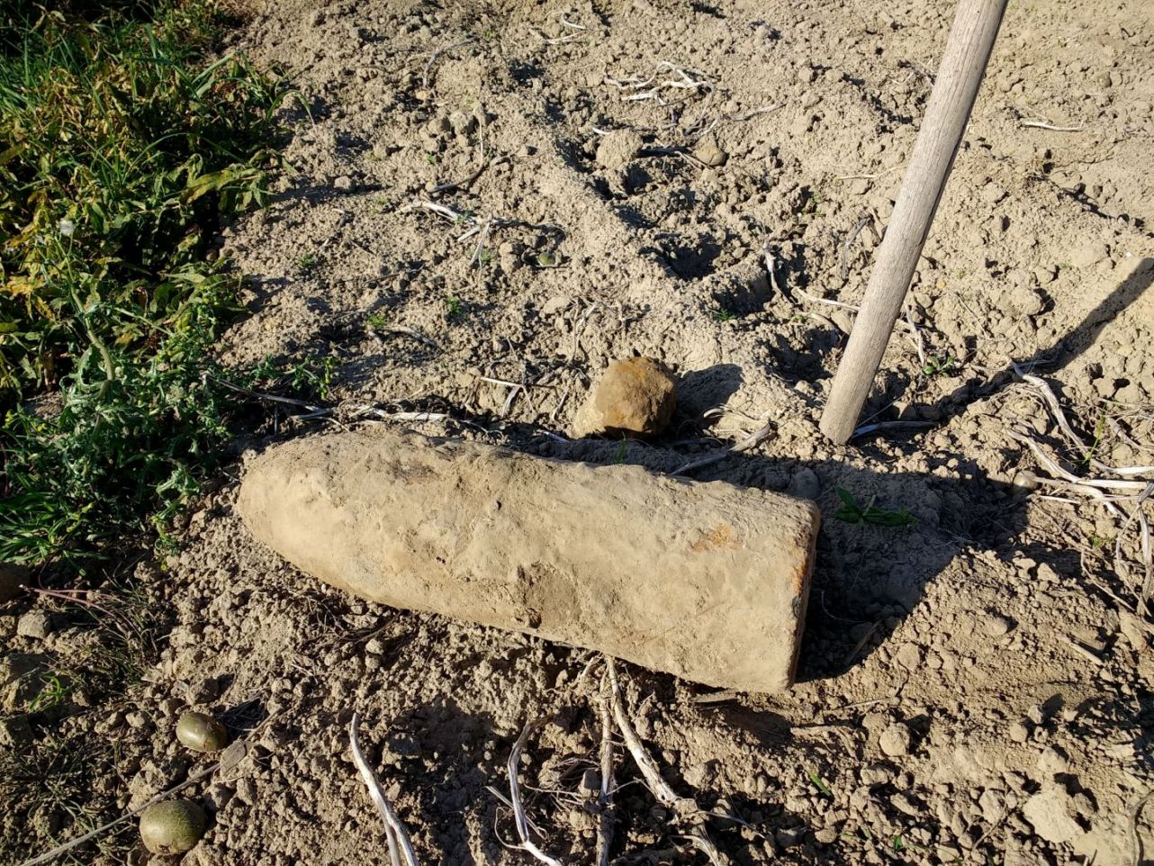

            Some finds - a large grenade + unexploded detonator:

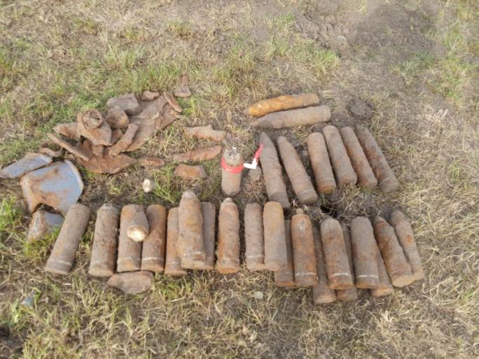

            A nice collection of finds from a piece of farmland that was going to be plowed for the very first time in 100 years.
            It used to be a pasture for cows. As a farmer, you don't want the plow to run over the detonator of one of these :

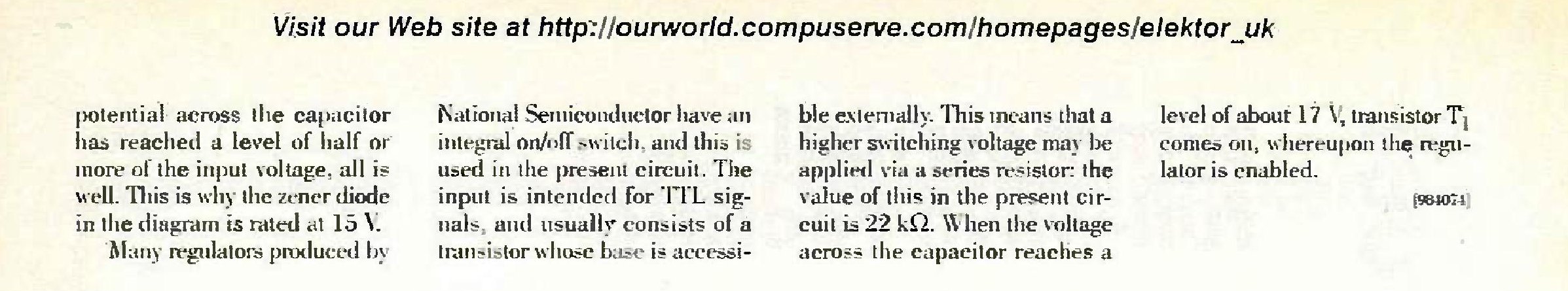

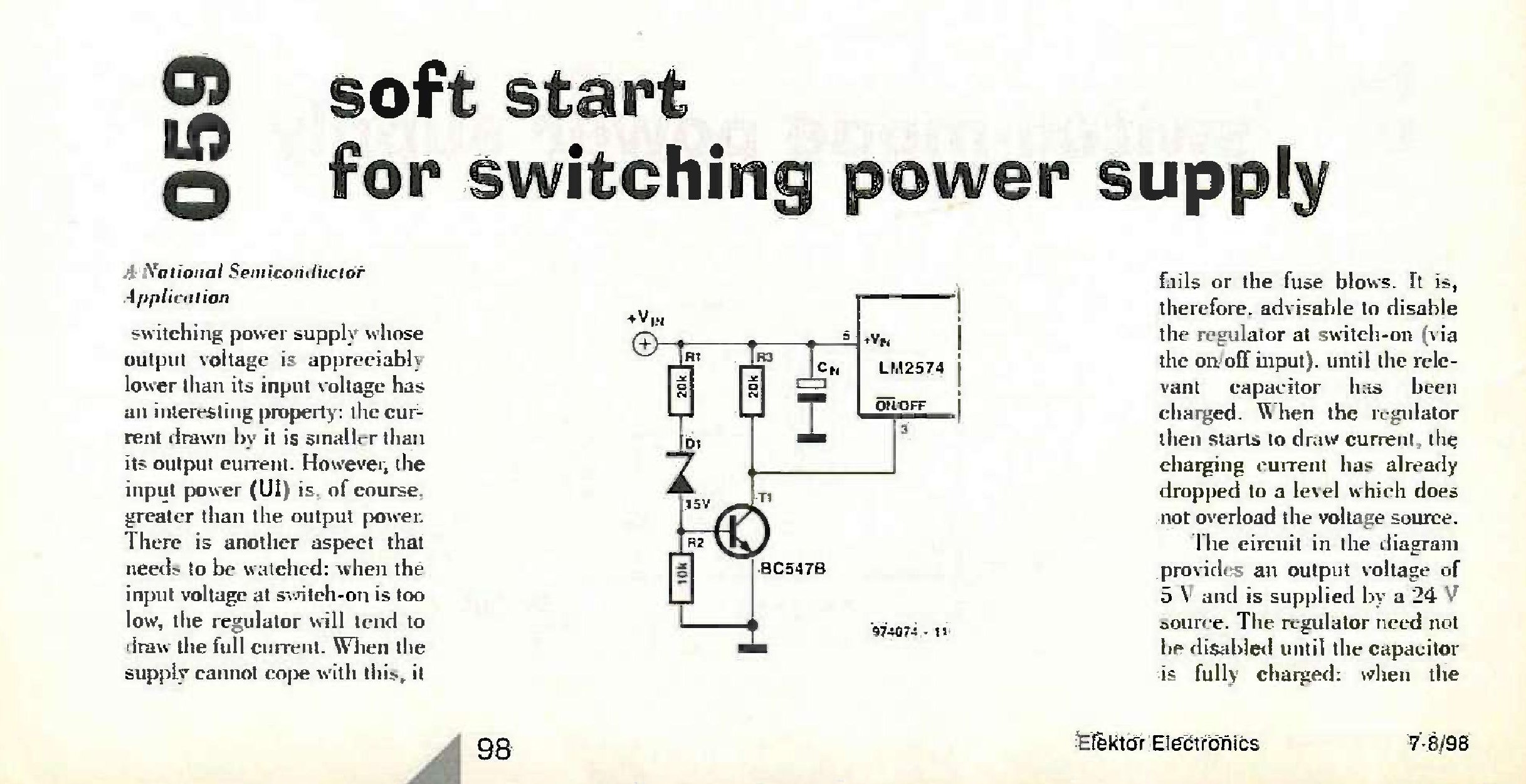

                            There is a little circuit(about 5 components) which provides a soft start upon switch on. Maybe it will be good for use here or for some other circuit. It slowly charges the capacitor thus limiting inrush current. If used in conjunction with regulator....well have a look:
