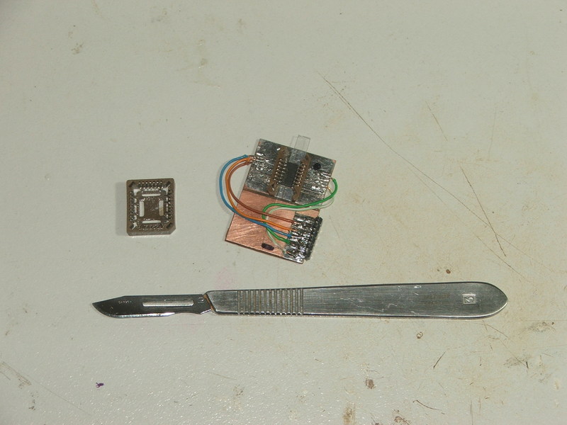

                      Re the smd Pickini project, progress has slowed at the moment waiting for parts but I have made a programming socket to hopefully enable programming of the 14 pin smd Pic 16F1864.
                      It seems to hold the pic securely enough (upside-down!) and make good contact with the pins. The contacts have been cut from a 32 pin PLCC sm socket soldered to pads scribed into a scrap of PC board using the back of a scalpel blade. I had to fit a strip of plastic into the bottom of the socket to pack up the chip so its legs make more secure contact with the sprung socket contacts. I can't test it until the 16F1864s arrive - It just has a 'dummy' chip in it at the moment.
                      I think off board programming may be a better proposition as in-circuit programming may require isolating too much of the other circuitry to make it effective.

                                That should work and an inventive solution.
                                However, an ICSP header is really the way to go and circuit can easily be designed to isolate other circuits without impairing their function.
                                First is a diode & 10k pull-up from +5V to MCLR/Vpp and a Schottky diode from +5V to PIC's Vcc to prevent powering +5V from the programmer.
                                Series resistors between the PIC's PGD & PGC pins to other circuit if used. I try not using these two pins so that I can use them for In Circuit debugging.
