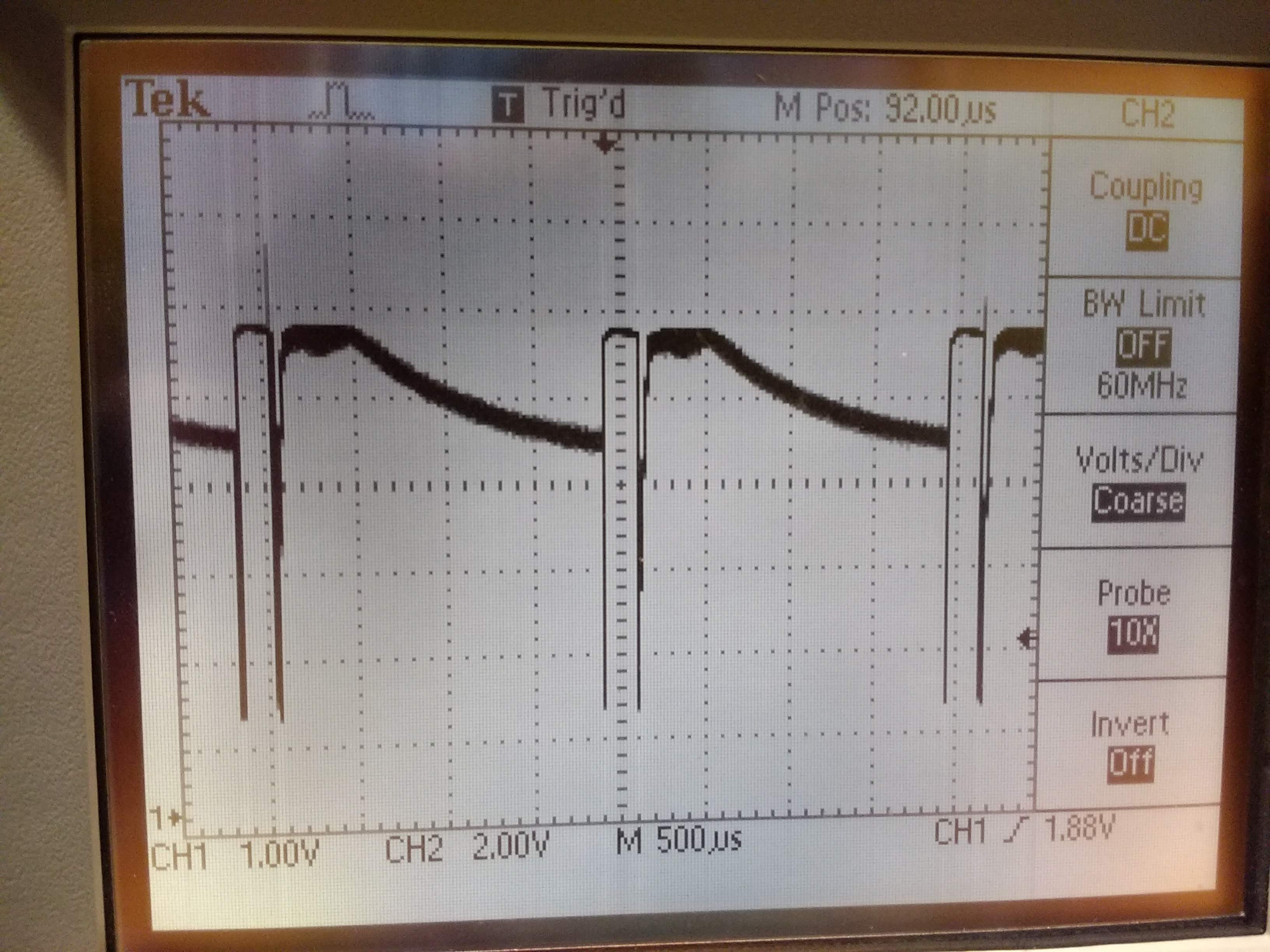

      My gut feeling still tells me that there is something wrong with your automatic DC offset adjustment of the opamp after startup: the circuit around Q3.
      This should be reflected in your waveform. When you measure it at pin 8/9 of the PIC (TP2 in the schematic), it should look something like this:
      [ATTACH]49117[/ATTACH]
      The noise on this signal is mainly coming from the scope backlight converter ( together with other EMI sources in my garage... ).
      The signal in this picture will give a valid sensitivity setting between 1.5 and about 4.5 V. ( = comparator slicing level to measure the flyback pulse width ).
      Below and above these tresholds, you will hear the error tone ( no flyback detected at the comparator output ) - with firmware version 4.2
      With firmware version 4.1, the slicing level is fixed at about 0.5V below the max flyback voltage.
      When the offset is not properly adjusted, the signal may be clipped to 5V, giving a much smaller slicing level adjustment range and less sensitivity.
      The closer you bring the slicing level to the top of the flyback ( the "widest" part ), the more sensitive the detector will be for small changes.
      Too close => instability.

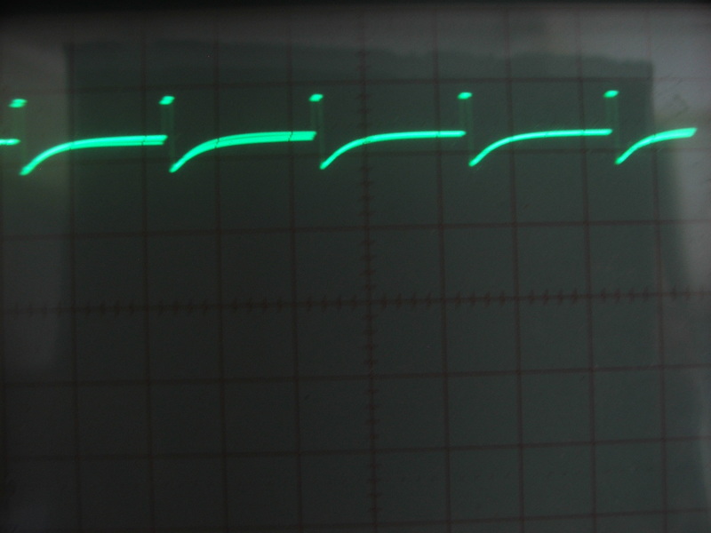

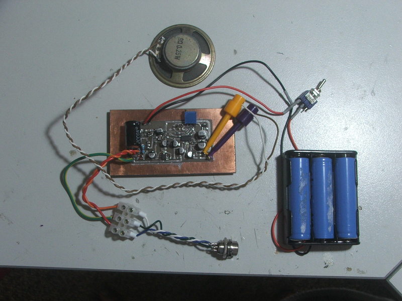

      Hi Bernard
      Sorry about the long time in replying but in the meantime I have completely remade the smd version on a new PCB with mostly new components (except pic). I also re-programmed another pic with V4.0 & tried it on the original pcb – all produced the same problem.
      I have measured voltages and waveforms on the new board and sketched them on the attached pdf along with the scope waveform at TP2 – analogue scope set set to 2v/div vert & 1mS/div horizontal. The black voltages & waveforms are without the coil attached, the red with the coil.
      I would appreciate if you could have a look at them and perhaps suggest what to try next. My feeling is that leakage in the electrolytics could be contributing but have yet to try swapping them for tantalum's. I also found that R2 (470R) had a tendency to overheat and go o/c so I replaced it with a normal 1/4W TH type

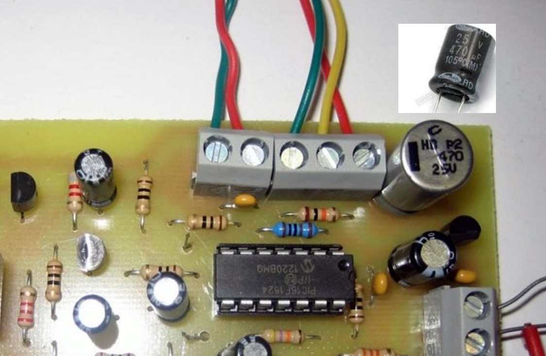

      • Hi Bernard I have watched your store I liked your offer at a reasonable price I want to buy the set But I want a favor from you Is it possible to replace irf740 + pc549 And put Instead of them Potmeter with on/off switch + The aluminum capacitor is not found in my country like themClick image for larger version
ID:	356651Click image for larger version
ID:	356652 And I will be grateful for your generosity
        • No problem. I will get back to you on Tuesday, as I am on holiday till then.
          • Originally posted by Hammerhead View Post

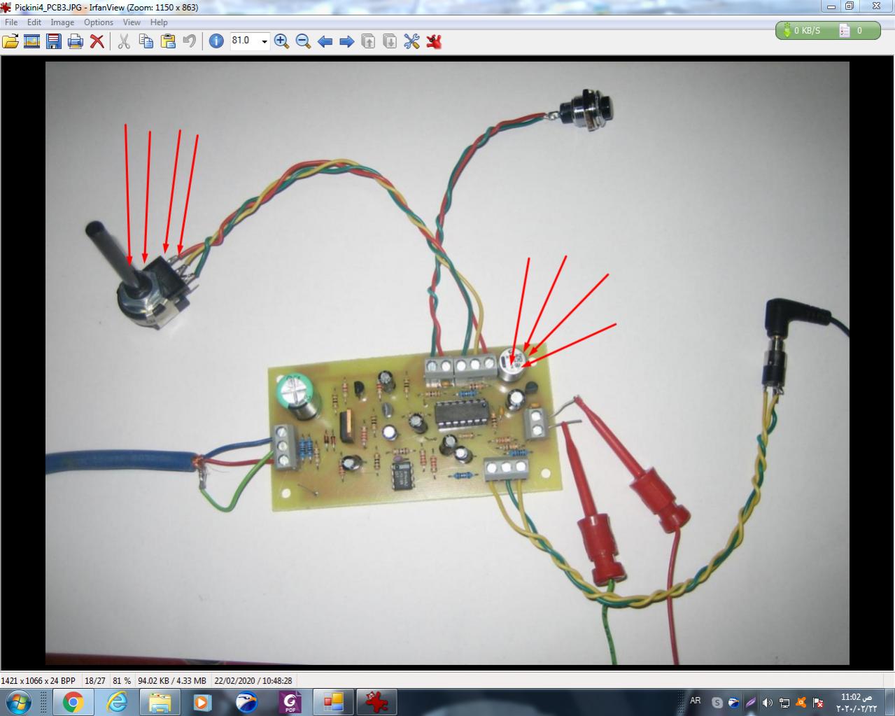

            Hi Bernard I have watched your store I liked your offer at a reasonable price I want to buy the set But I want a favor from you Is it possible to replace irf740 + pc549 And put Instead of them Potmeter with on/off switch + The aluminum capacitor is not found in my country like them[ATTACH]49561[/ATTACH][ATTACH]49562[/ATTACH] And I will be grateful for your generosity
            • @Hammerhead : as Arionas illustrated: the 470 microFarad electrolytic capacitor does not need to be an aluminum housing.
              @Goaty --- SMD build
              Your waveform looks way too "slow" - too much damped - not high frequent enough, it should be a sharp flyback pulse.
              The timebase on your scope is probably 1ms / division, - and vertically 5V / div ?
              Something like this: Click image for larger version
              - it could be a very slow coil ? ( unlikely )
              - C10 over the opamp = 4.7 picoFarad ( NOT nanoFarad) ? You can safely remove this capacitor.
              - Damping resistor = 2 x 1K in parallel ?
              • Hi Bernard
                Thanks for your response with some suggestions.
                In answer to your comments -
                “- it could be a very slow coil ? ( unlikely )”
                This coil has worked OK with 3 or 4 other Pickinis
                “- C10 over the opamp = 4.7 picoFarad ( NOT nanoFarad) ? You can safely remove this capacitor.”
                I removed C10 and it made no difference. It was in fact a 5pF smd cap as I could not find my 4.7’s.
                “- Damping resistor = 2 x 1K in parallel ? “
                These are definitely correct.
                My analogue scope was set set to 2v/div vert & 1mS/div horizontal. “0 V” was the centre horizontal axis shown in the photo. With your scope photos I am not sure where the “0V” X axis is as I am not familiar with digital scopes.
                At this stage I have run out of ideas so I think I will put it aside for a while and concentrate on putting one of the other working full size boards into the new waterproof housing I have been building. If I wait too long the sea water will start to get too cold for diving. Today I took the empty housing to one of the local jettys and lowered it into about 2-3m of water for 20 min. It came up completely dry so all good so far – now to put some ‘works’ in it!
                Thanks again for your help.
                • @Goaty:
                  The waveform should be between 0V and 5V as this is the input range of the analog comparator in the microcontroller.
                  The waveform is taken on pin 8/9 of the microcontroller.
                  In my pictures: 0V is at the bottom and 1V / div.
                  Your waveform looks too low-frequent. It should be a sharp spike, not a slope that takes about 500 microseconds to reach steady state again.
                  It should also have more amplitude. That is the reason why your sensitivity control is so limited.
                  Not much ideas left. Coupling capacitor C9 ?
                  Or disconnect the analog input of the microcontroller - remove R6 = 2K2 and measure the opamp output with the scope.
                  Opamp = LM318 ?
