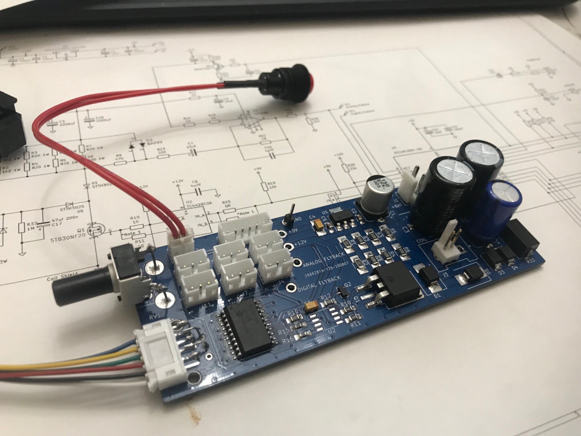

                  • Originally posted by SaltyDog View Post
                    Thanks Bernard,
                    I will try MPLAB-X, will let you know when I have completed the port to the new/different compiler ..
                    Cheers
                    @Saltydog,
                    The port will be minimal, a few bit defines and PWM routine changes. Just write direct to the registers for timers or PWM.
                    MikroC uses a complete definition of register and bit
                    for instance ADCON0.ADON = 1; // ADC on
                    In XC8 it would be ADON=1;
                    So for the timer setup it would be something like this;
                    // Timer0 timebase - for sound generation
                    PS0 = 1;
                    PS1 = 1;
                    PS2 = 0; //prescaler / 16
                    PSA = 0;
                    TMR0CS = 0; // FOSC / 4 --> 8 MHz
                    TMR0IE = 1; // timer0 interrupt enable
                    I did port the Pickini 4 project to XC8 some time ago and had it working on a PIC18F1829 no worries.
                    Thought I would be smart and use the MCC setup which also worked...but then when making some changes one day, a software update occured and it crashed and the MCC file became corrupt, lost that part although the main C code was fine.
                    Will share the code when I get back to tidying it up but I have paying work and a lot of other projects lined up so might be a while.
                    Can send it via private mail if you like as a reference but for general sharing here it would add confusion and I would much rather wait and have it completed and share it as a complete project as my take on the Pickini design.

                    • That was meant to read PIC16F1829....
                      • @MdToday,
                        Nice work
                        Glad to see that somebody picks up the source code and starts modifying it. Otherwise there would be no point in publishing it.
                        Nice board too ! What are all these 3-way connectors for ?
                        Are you going to publish your modifications ? Both schematic and software ?
                        Best regards,
                        - Bernard

                          Thanks F117 and thanks for your original work!. I did this one quite a while ago and will revisit.
                          I had the intention of making a pin pointer based on the Pickini 4 but a long list of projects pushed it back.
                          Yes, I fully intend to publish this version of course, as a complete project and modified firmware.
                          I used the PIC16F1829 as it is a very close relative of the PIC16F1824 and I have plenty of them.
                          On the connectors, one is audio output, the extra connectors are spare analog /digital port pins with Power,Port,GND, also paralleled those same ports plus PWR,GND in one connector.
                          So options for experimenting. I always bring out unused port pins during prototyping rather than soldering-desoldering wires.
                          JST connectors are a few cents each, also makes life easier during initial testing.
                          Final design will be a pin pointer and have less connectors but include 18650 single LIon cell holder and boost regulator on a longer narrower board.
                          The single cell 3.6 - 12v boost design has been tested with this circuit and there are no issues with noise affecting sensitivity or stability of the detector.
                          I have some immediate projects to complete so as I get time over the next few months I'll try put it all together.
                          Cheers
                          Mdtoday
