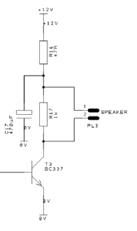

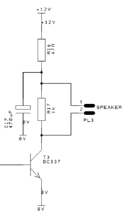

                    can i use a felezjoo pi schematic for speaker?
                    Pin 11 direct to base of transistor
Name:	Screenshot 2024-09-26 155245.png
                    • can i use a felezjoo pi schematic for speaker?
                      Pin 11 direct to base of transistor​
                      Yes, and leave the 1K resistor between the microcontroller audio output pin and the base of the BC337 transistor.
