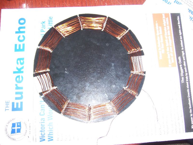

              geocash this is what I would call a spider coil. There is an article here somewhere regarding Mike Tuggle's "spider"coil. They too have great potential for a fast coil.

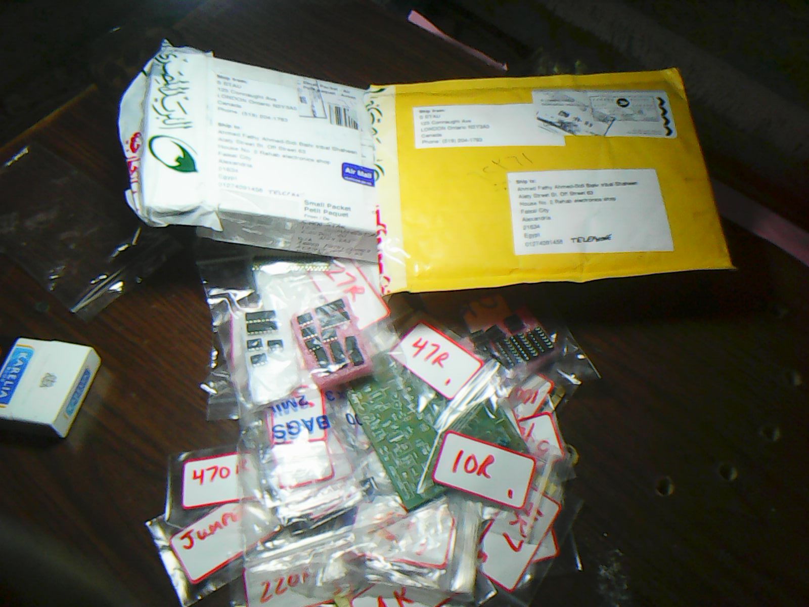

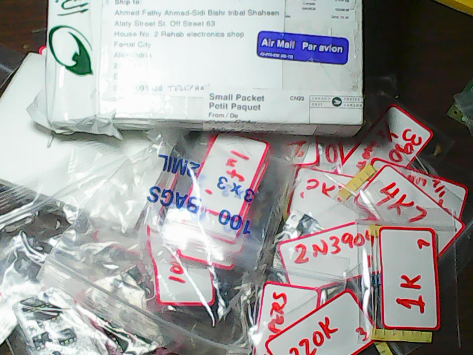

                All thanks and appreciation to Mr. Seven received today electronic components and successfully plan my friend now detector Mirage in Alexandria Click image for larger version

                  God to hear everything has arrived!!
                    I can recommend Sven´s Mirage Pi.
                    With first Version i was able to detect an 1€ coin at 30cm in air with 20cm monocoil.
                    It is also able to detect small pieces of metal like nuggets.

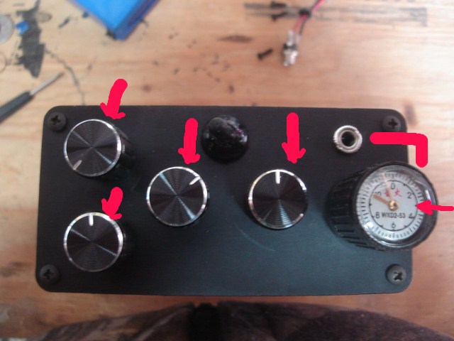

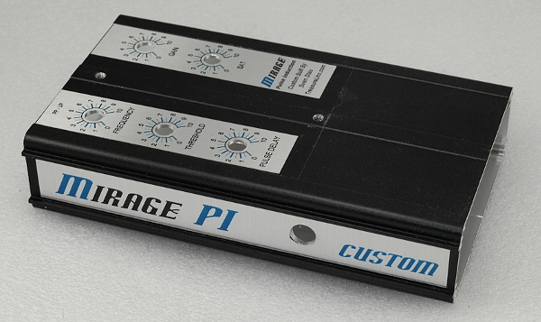

                        Please Seven What are the dimensions of Control BoxClick image for larger version
ID:	347253 And I did not find in the shipment box on this resistance variable keysClick image for larger version
Name:	panel layout 3.JPG
                          That control box and others I use are extremely tight. Almost not enough room. They can be a challenge for most to assemble. Careful consideration regarding control placement and assembly order is needed.
                          I would advise against using simlar small size boxes.
                          The best box where everything fits nicely including a 8 cell AA battery holder are these which I also use, I buy off ebay from this seller: http://www.ebay.com/itm/131876087763?_trksid=p2057872.m2749.l2649&ssPageNa me=STRK%3AMEBIDX%3AIT
                            Rack case can be also used from old external hdd, i have this one for example:
                            http://17c4dcd7f91259d8cc66-f5932f6d...21-752x493.jpg
                              I have used a couple different cases for the mirage ( see pics below).. the best fit so far has been the one below in the ebay link or "mirage 1" build and it is relatively cheap compared to other cases. its a nice case for the price too. Just spend some time on your layout before drilling and you'll be fine.
