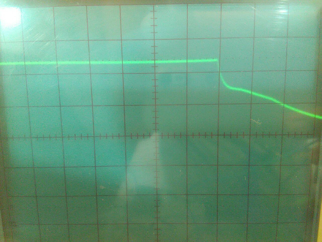

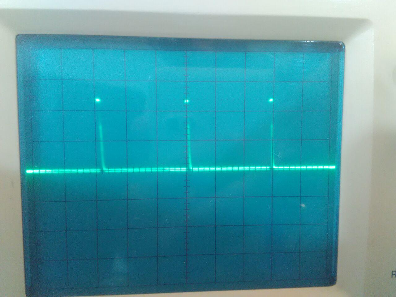

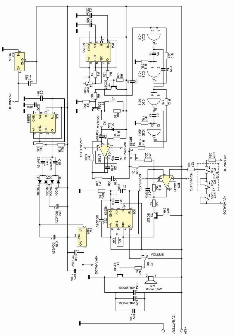

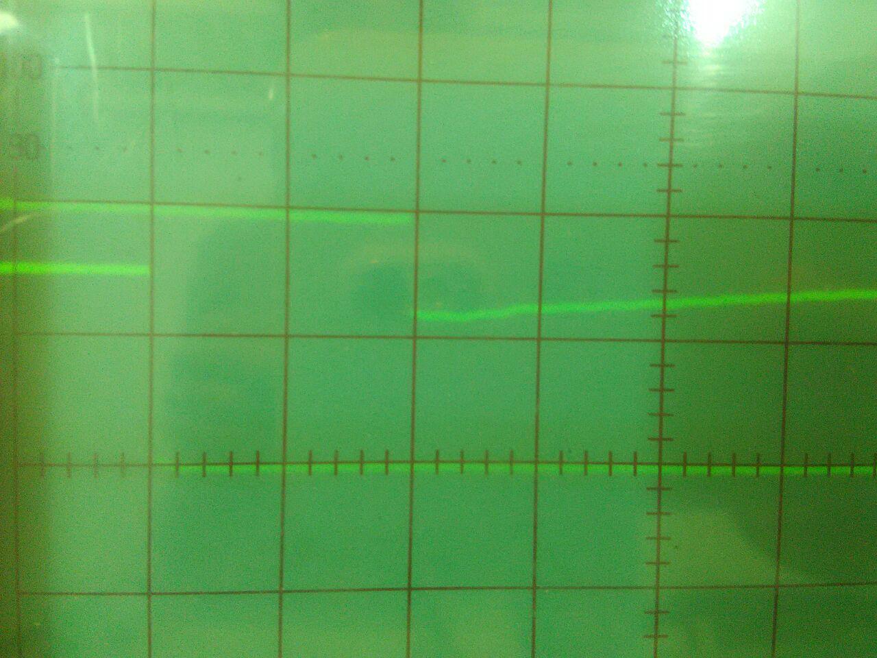

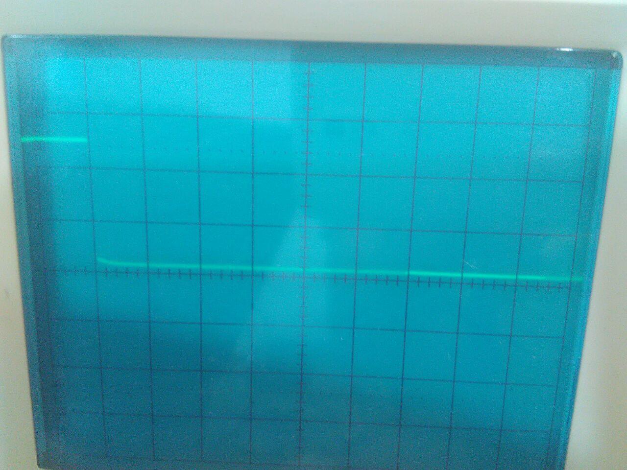

                • hi I tried to measure my Delay time(Polones) with a dual channel oscilloscope but i'm not sure if i did it right or not
                  here are some pictures:
                  polones schematic just for comparison
Name:	Modified Sandbanks(polones) - from Ivconic.jpg
                  V/dev = 5v/dev Time/dev = 1mS
                  gate of drive transistor, have not connected yet
Name:	Gate_of_transistor_(not connected).jpg
                  pin 10 of 4011, sampling(gate of BF245)
                  V/dev = 5v/dev Time/dev = 20uS
                  Falling edge of drive transistor gate signal
                  Falling edge of pin 10 of 4011, sampling
                  look at last two pics it seems they have 120us delay!
                  or my measuring method is wrong?
                  I just wanted to know how to measure the delay time and also how to calculate it's value based on those capacitors and resistors around 4011 IC

                    You should put channel one on pin 6 of the LF357 and channel two on pin 10 of the 4011, trigger off of channel two. Set your scope for 5volts and 50uS that should give you a good idea as to what your delay looks like
                    • Originally posted by surfdetector View Post
                      Thank you man
                      these little hints teaches me alot, very helpful for learning electronics

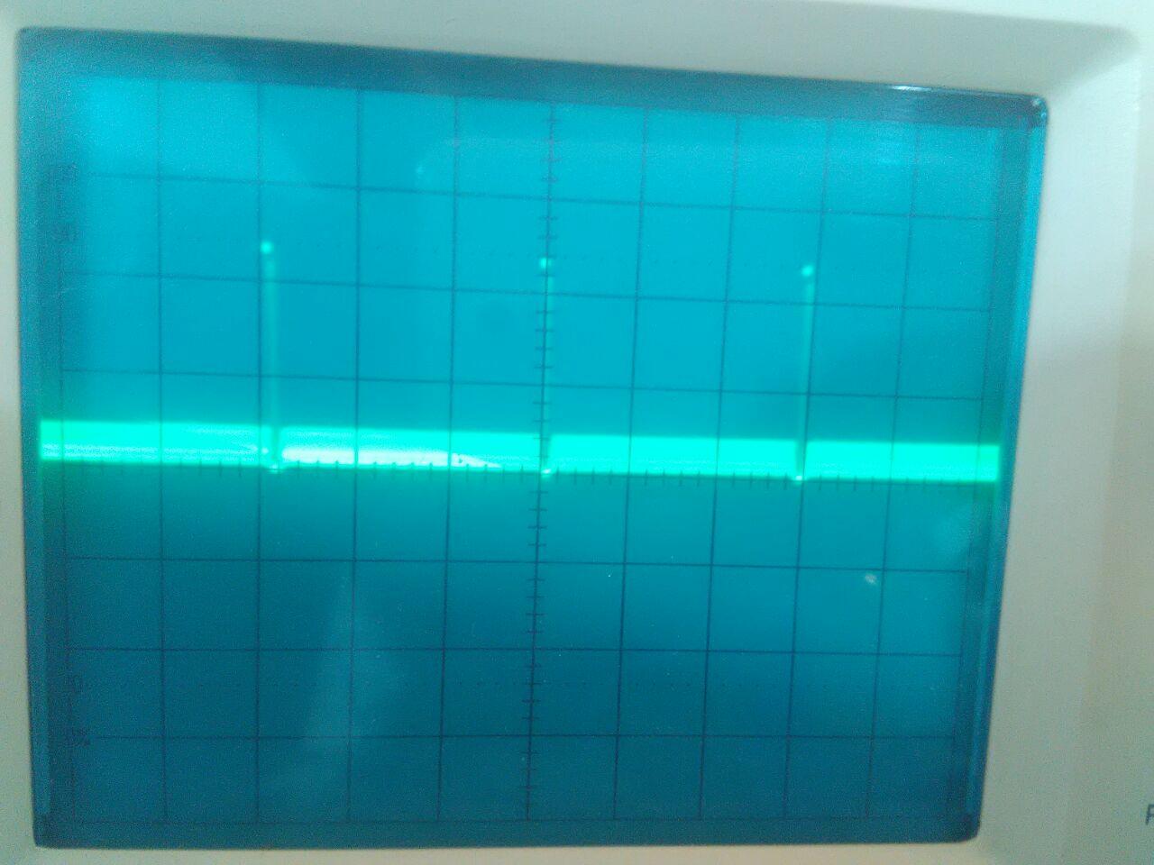

                                I did it
                                now it seems to me my delay time is 100uS!
                                channel X on pin 6 of LF357(TL071 in my case)
                                channel Y on pin 10 of 4011
                                the top waveform is LF357 and bottom is 4011
                                volt/div = 10v time/div = 50uS
                                i played with trigger and trigger source but couldn't make it smaller
                                what should i do now? reduce the two 33k resistors?
