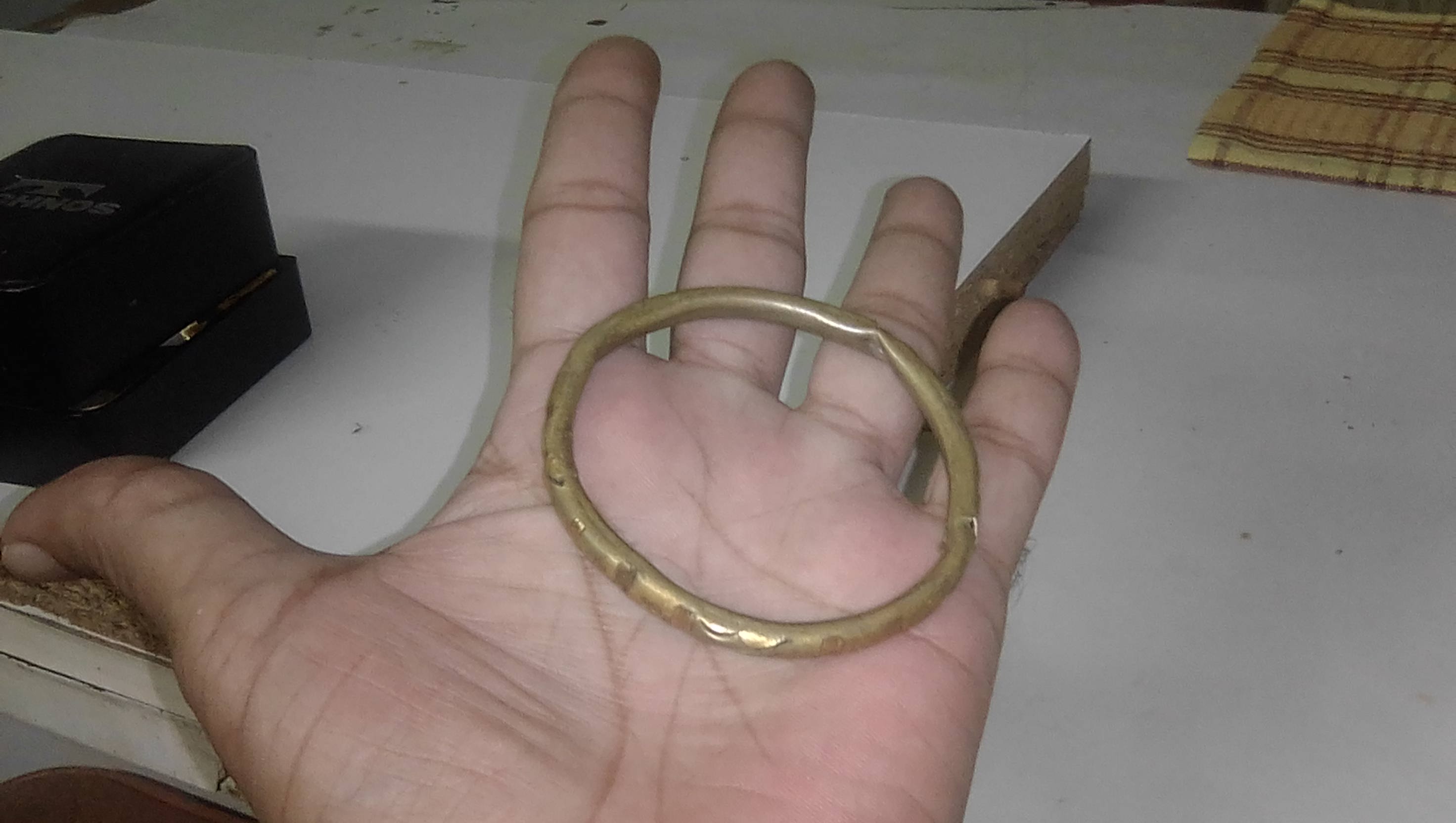

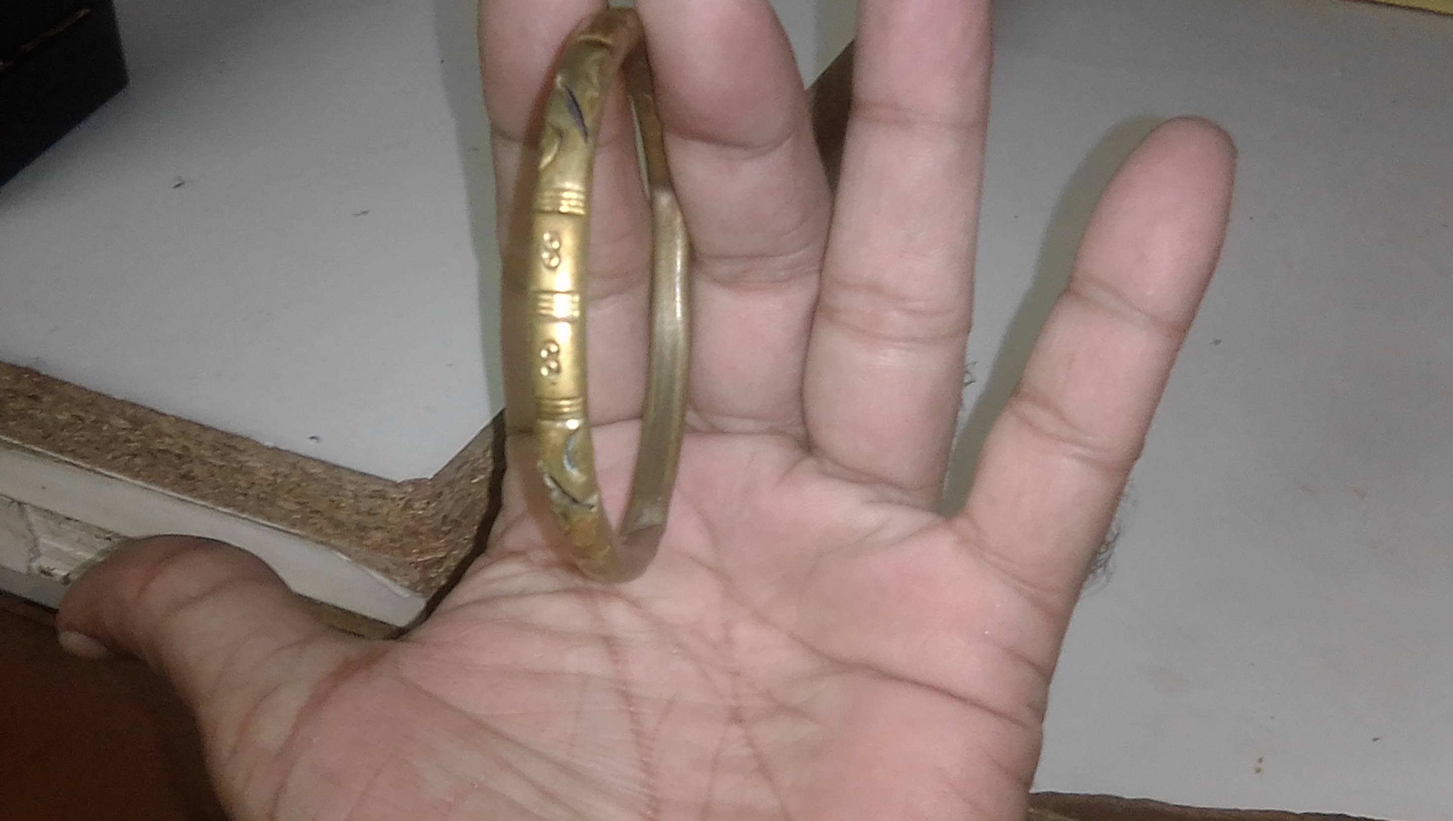

          I posted photos of the bracelet in my previous post. Had to dig it out of old collection.
          And just in case someone is curious to know just what the hell a "Chinese chopper" is, well here's a pic of the beast. Believe it or not, it works good as a makeshift digging tool, kinda like a flat shovel, and a good weapon on those lonely night digs.

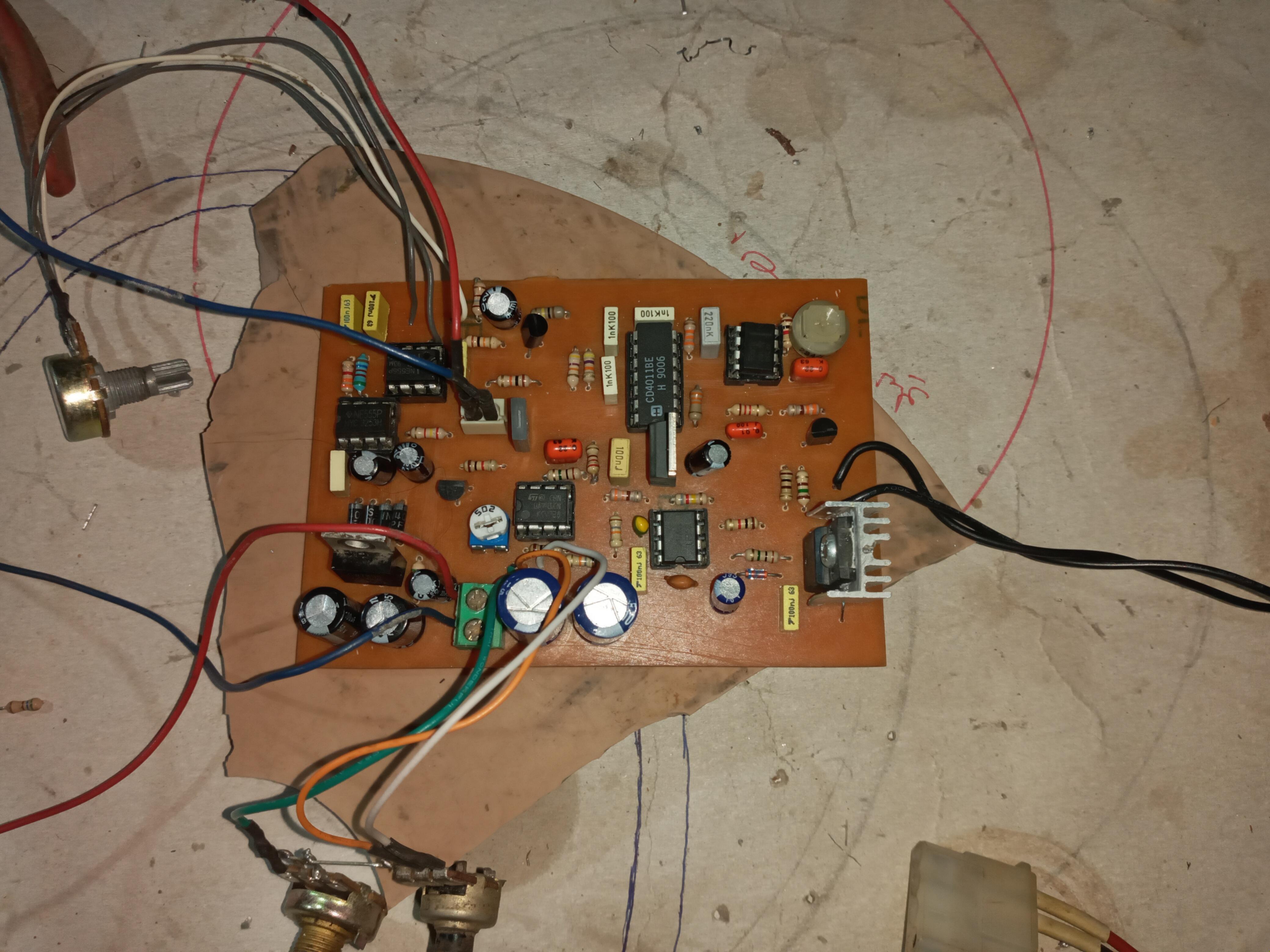

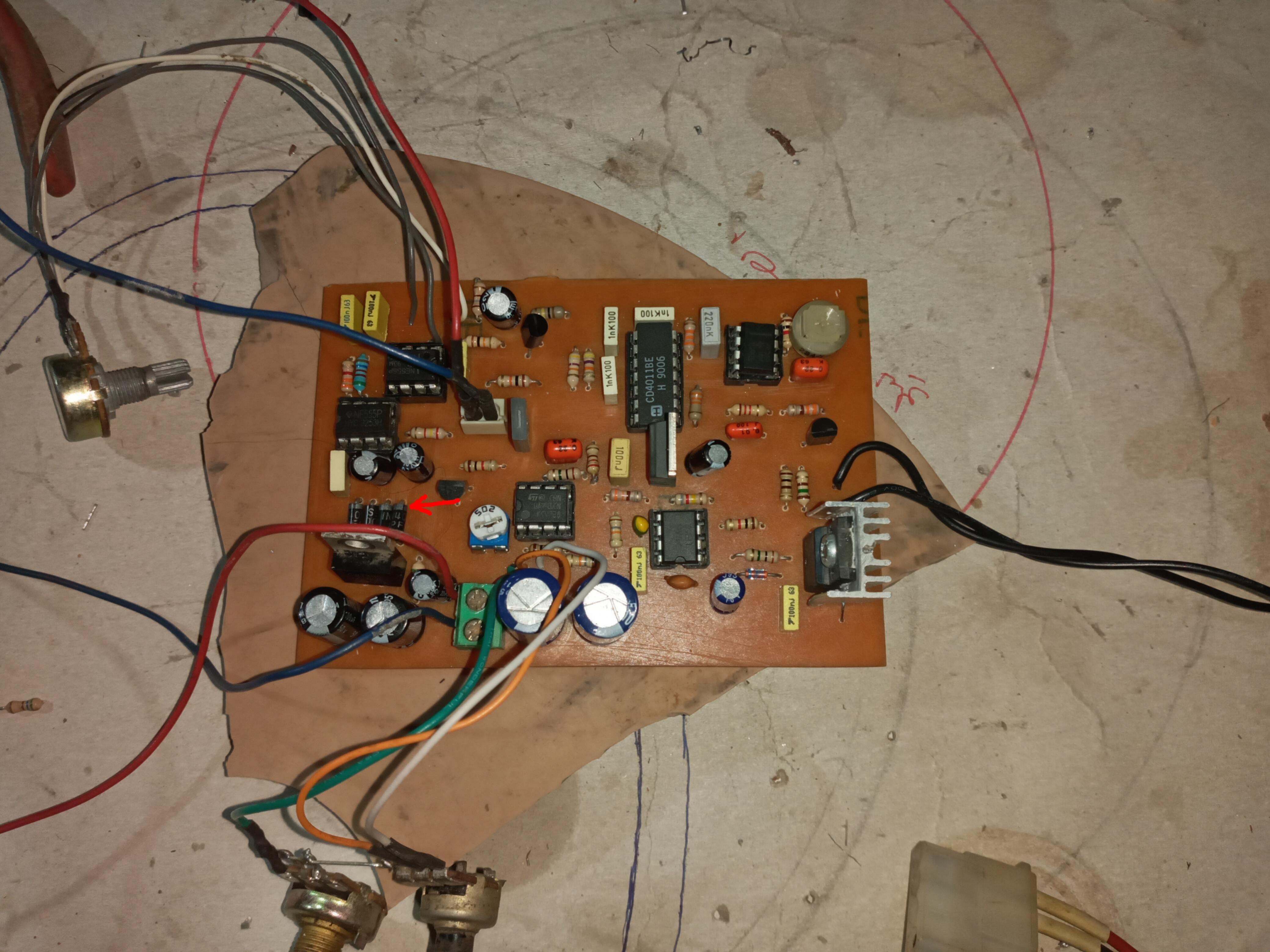

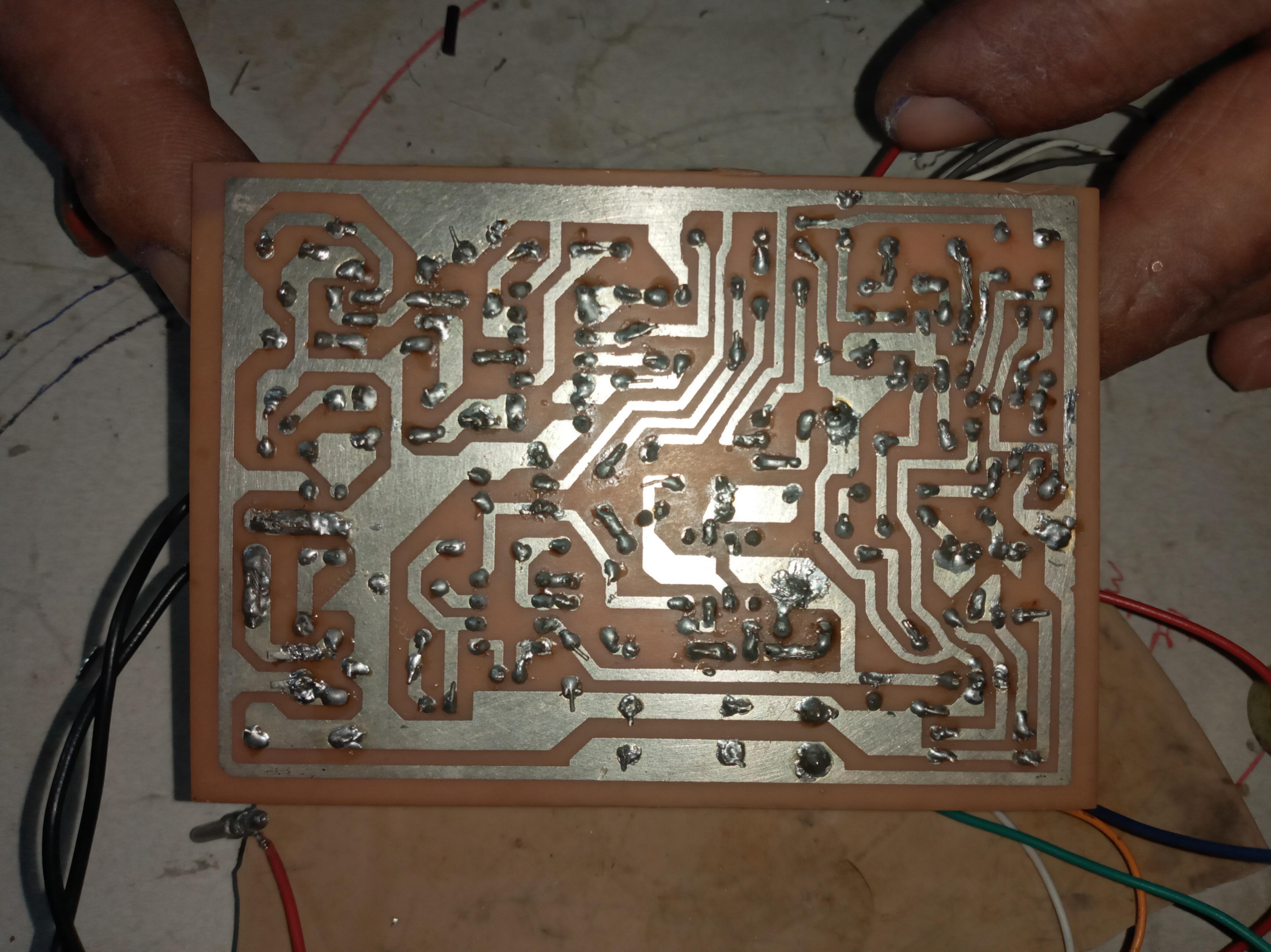

            Hello all This detector ominous Built from it Three copies do not work Only the crackling sound And Alkwyl are not sensitive to I don’t know where the problem isClick image for larger version
ID:	356853anythingClick image for larger version
            • #66
              Hammerhead, please check out the four diodes in the charge pump circuit. Make sure they are correct orientation.
              I point to the diode which I think needs to be reversed.

                • #68
                  Originally posted by Hammerhead View Post
                  Hello all This detector ominous Built from it Three copies do not work Only the crackling sound And Alkwyl are not sensitive to I don?t know where the problem is[ATTACH]49783[/ATTACH]anything[ATTACH]49782[/ATTACH]
                  Dear Hammerhead

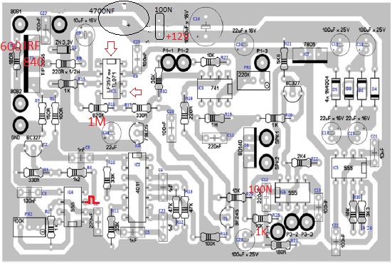

                  The resistance of 1M that is just above the zener if I am not mistaken is 220R
                  The 18k resistors above the 1000uf capacitors do not correspond either
                  There is indeed an error in the diodes
                  Can you post the board you are using?
                  • #69
                    Thank you, my friend I replaced it Diode+
                    TransistorThe problem is still

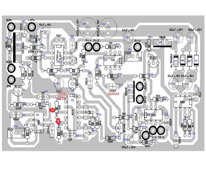

                      type de pls ici quel diam?tre de fil et combien de tours (ou microHenry)
                      quelle valeur est votre r?sistance d'amortissement
                      certains poeple ont 180R (comme moi) , d'autres utilisations 470R ou 390R

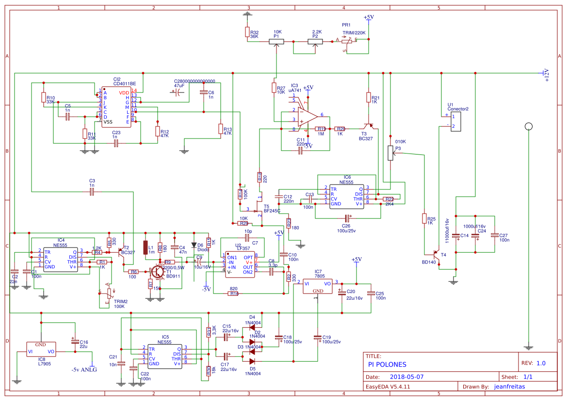

                      avez-vous r?gl? correctement la r?sistance d'amortissement pour chacune de vos
                      distances de bobine jusqu'? pr?sent est tr?s bonne, je pense que vous ne pouvez pas obtenir plus d'un tel d?tecteur pi simple que
                      je construis 3 unit?s par moi-m?me, fonctionne tr?s bien d?s le d?but [/ CITATION]
                      J'ai utilis? cat5. 16 tours d'un diam?tre de 65 cm. 410uh. La meilleure inductance pour les grosses bobines est de 320 uh comme une bobine de 1 m. La r?sistance d'amortissement est de 1k. Dans une bobine de 1m 1,5k. . Je l'utilise actuellement dans une bobine de 32 * 37 cm et 1m. fils d'?paisseur 0,6 mm et 0,72 mm avec une inductance entre 300 ? 400uh. Fr?quence de marche de 240 Hz. ce d?tecteur est stable presque sur tous types de sols, il fonctionne avec une grande efficacit? dans ce type de sols min?ralis?s rouges ou humides. Le sol ?tait presque difficile pour de nombreux appareils tels que felezjoo pi .pim2.delta pulse1 .. mais cet appareil fonctionne en toute stabilit?. J'installe la r?sistance variable 220k dans la boite directement pour faciliter le r?glage ? chaque fois.
                      https://www.youtube.com/watch?v=dxh5A61Idc0
                      https://www.youtube.com/watch?v=MXsVHzvGV0c
                      J'ai apport? quelques modifications
                      [ATTACH] 49790 [/ ATTACH]
                      De plus, d'autres modifications peuvent ?tre apport?es r?alis? selon une copie de bancs de sable ... comme r?duire le temps du premier ?chantillon ? moins de 50us en augmentant la valeur des r?sistances de 33k. pour am?liorer sa sensibilit? ? l'or et ?galement augmenter la vitesse de r?ponse de l'appareil en r?duisant la valeur du condensateur 220n ? 100 ou 47n comme indiqu? sur cette photo. J'ai essay? ces modifications mais je ne les ai pas encore utilis?es sur mon appareil.
                      [ATTACH] 49791 [/ ATTACH]
                      autre test
                      https://www.youtube.com/watch?v=P37QlRU4g50
                      https://www.youtube.com/watch?v=mnx6k1-ZVEU
                      mod
                      https://www.youtube.com/watch?v=ZQScP5pC0rU

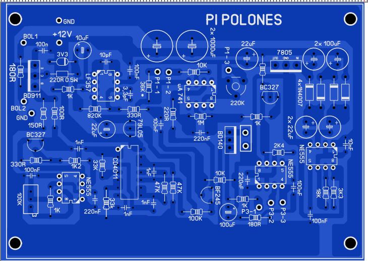

Name:	PI Polones 2019 Schematic.png
ID:	356862Click image for larger version
                            Originally posted by Chiringo View Post
                            Dear Hammerhead
                            Hello, I built this circuit

                              To all who built this circuit, I say to you, please read the follow up article on the sandbanks metal detector for the mods. This will give you guidance on how to get the circuit working optimum. It refers to mods to reduce the sample delay and mods to increase the response from the VCO to super fast.
                              Also, I used the NE5534 opamp on the front end. I did only small changes to the circuit for this chip. Which I think is more readily available than the lf357, which are usually problematic to have original chip. Many fake chips out there.
                              Reducing C12 from 220nF to say 47nF to 100nF makes the VCO response excellent. Really fast.
