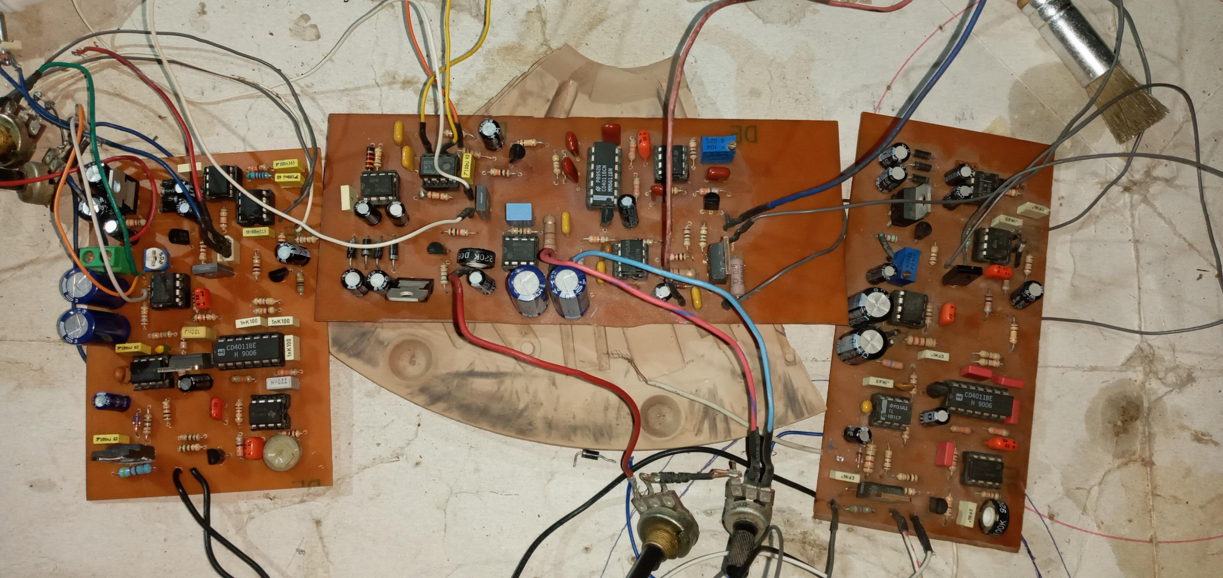

                Originally posted by Chiringo View Post
                Dear Hammerhead
                The resistance of 1M that is just above the zener if I am not mistaken is 220R
                The 18k resistors above the 1000uf capacitors do not correspond either
                There is indeed an error in the diodes
                Can you post the board you are using?
                https://youtu.be/8oYblCz8YhkClick image for larger version
                • #83
                  Hammerhead, please check out the four diodes in the charge pump circuit. Make sure they are correct orientation.
                  I point to the diode which I think needs to be reversed.
                  I do not know where the wrong This is another version Please help
