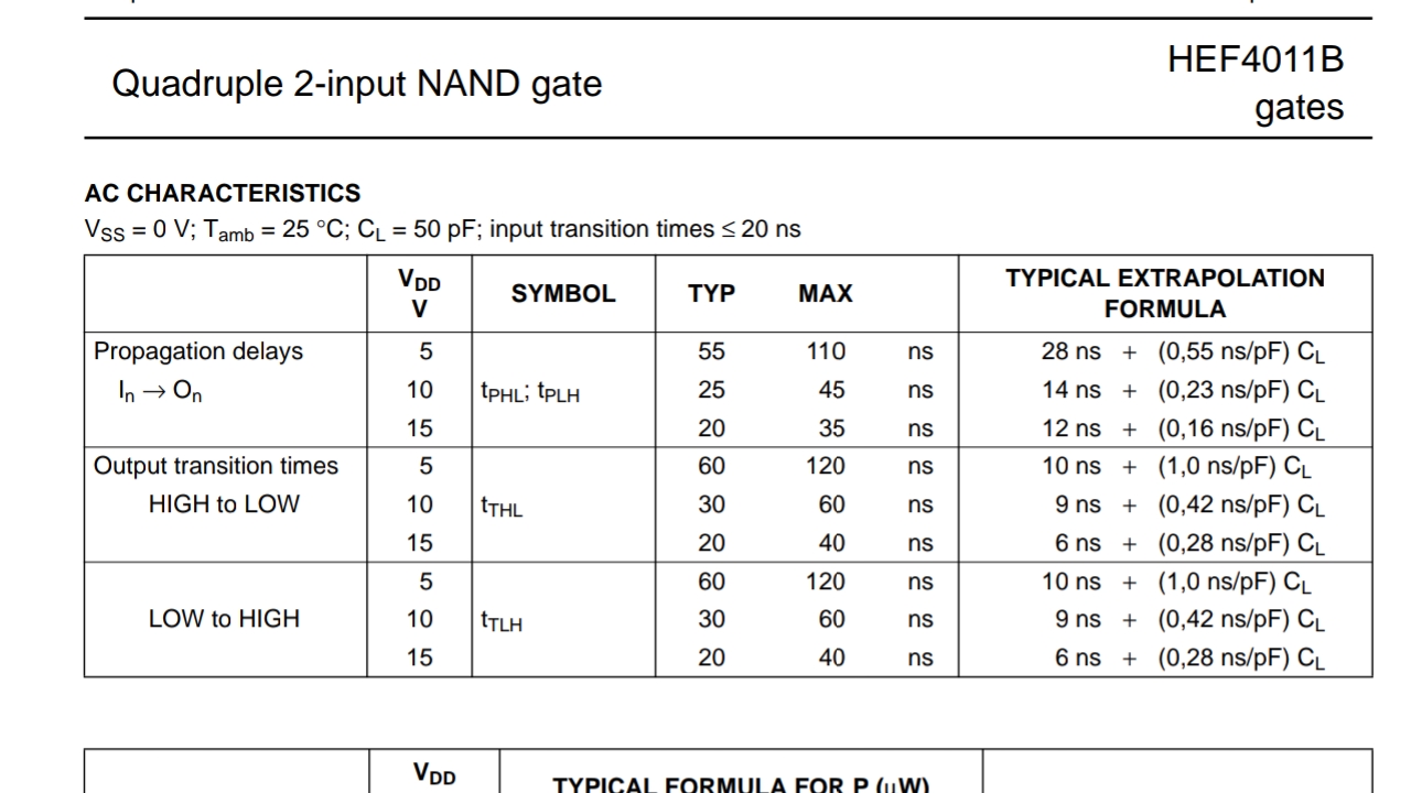

                  • I found in the HFE4011 a relationship between the power supply and the output transition times. In one of mi polish pi i had to add a 11 vols regulator to the 4011 and then works much better.Click image for larger version
                    • Originally posted by Rodelio View Post
                      I found in the HFE4011 a relationship between the power supply and the output transition times. In one of mi polish pi i had to add a 11 vols regulator to the 4011 and then works much better.[ATTACH]50933[/ATTACH]
                      Well known formula in electronics
                      V = 5,95 x 10^5 x √U (м/с),
                      V = speed of charged particle, in CMOS case speed of electrons;
                      U = accelerating voltage or velocity of electrons in V;
