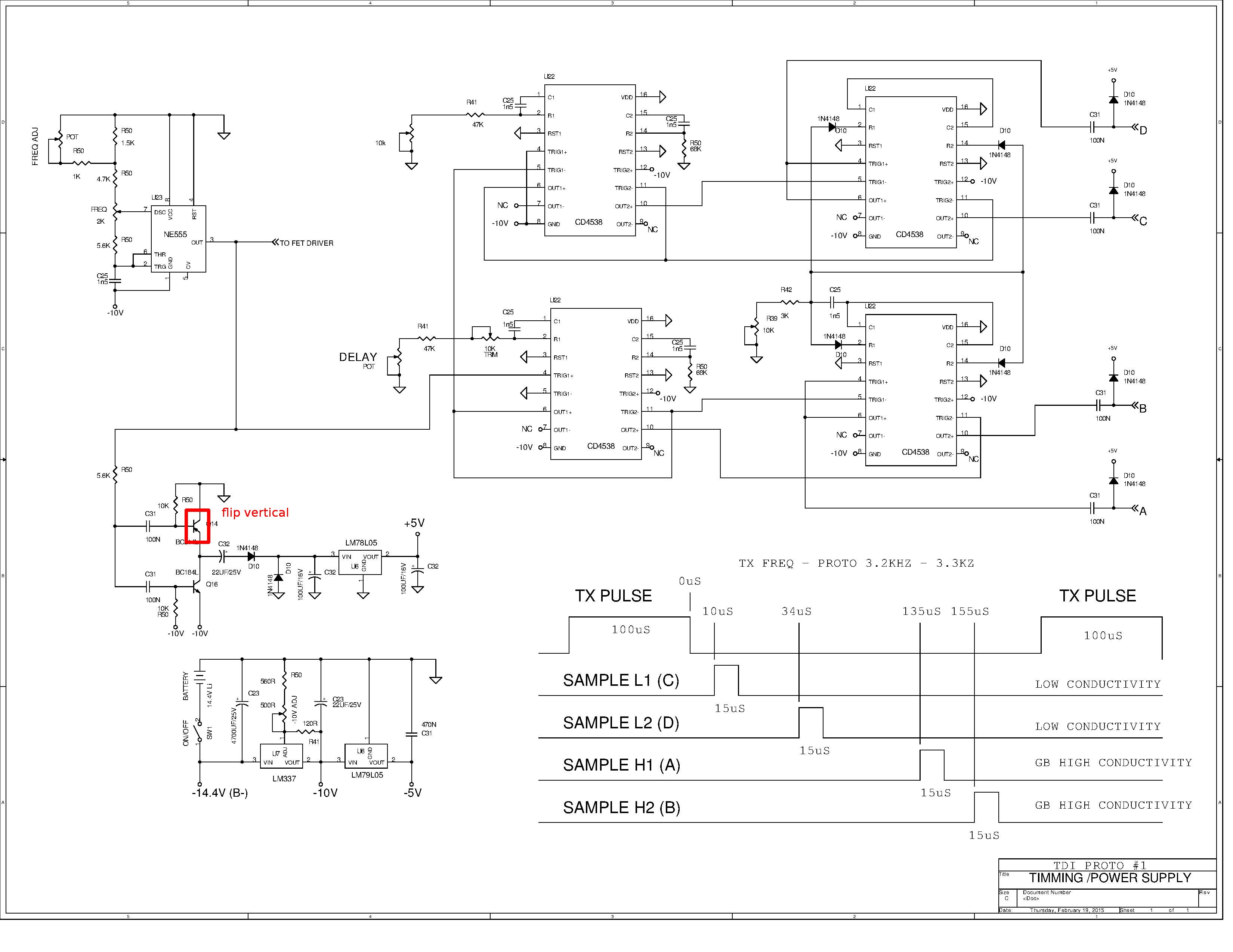

  • The schematic posted by Altra(TDI PRO PROTO) shows 47 ohm resistor between U2A pin 1 and what should be U2B pin 5 (TLC2262). It should be 47K. Also the 100nF capacitor between U2B pin 6 and 7 should be 47nF. The GSX5JB also shows this cap as 47nF. The picture of original Goldscan 5 board shows a 47nF capacitor. That's just my observation.

      Eclipse is correct about the integrator inputs reversed. The integrator is a TL062, the next 4 amps same page are a quad lt1114. The audio gain stage is a LT1112. A quad TL064 is used for the absolute amplifier with one of the amps unused. I drew this for reference not to clone. If people find something they question circle it on the schematic and post. I will try to verify.

        They are slightly different circuits with different pcbs. I posted a photo of the main TDI pcb you will not find a 47nf or a TLC2262. Build Jose's tested GS5 frontend and use the drawings I posted for ideas on the audio.

            The scheme that I published, is for the purpose of observing the corrections I made, because the Turkish scheme had some errors, especially the synchronization of the time base with the integrators, capacitors and resistors of the integrator, the reset circuit, during the ignition of the detector, and other minor details.
            This scheme works well, but it was taken as a basis of the Turkish scheme and some photos of the GS5.
            Also I do not use the current limiter and make other modifications to use it with 12 volts.
            However, the schemes published by Altra, were taken from one of the first TDIs manufactured, and I think we should follow in their footsteps.
            In addition, as Altra said, we can consult you if we have any questions.

                      Sheet demodulator, R31 2.2M , not 2.2m -- only for update.
                      Sheet timing : Delay Pot Value not indicated. (10K ? )
                      Sheet TX Preamp. The TDI uses 3 diodes 1N4148, and 2 are in parallel . It is necessary to have many diodes to avoid risks . With 500V flyback voltage, and 1K, the current surges to 500mA, it is too much for one diode, even during short time. So SS22 is a shottky 2A average, 75 A surge.
                      Sheet demodulator. May be an improvement is to to wire a 1NF on the wipers of the 50K trim ( trim between R12 R13, and Trim between R17 R18 ) This will avoid some noise going from the suplies to OP Amps. This is only to improve noise filtering .
                      Also I think CD4001 system is a Power-on Shut UP. (but I m not sure of the way to call it). Squelch on power-on ?

                            • I noticed this on TDI pro proto schematic. I think maybe wrong?
                                Altra also the first preamp stage should be inverting, so you need to reverse PIN2 and PIN3 (NE5534).
                                Also look at the power supply pins - those are mismatched (PIN4 / PIN7) (NE5534, AD8065)
