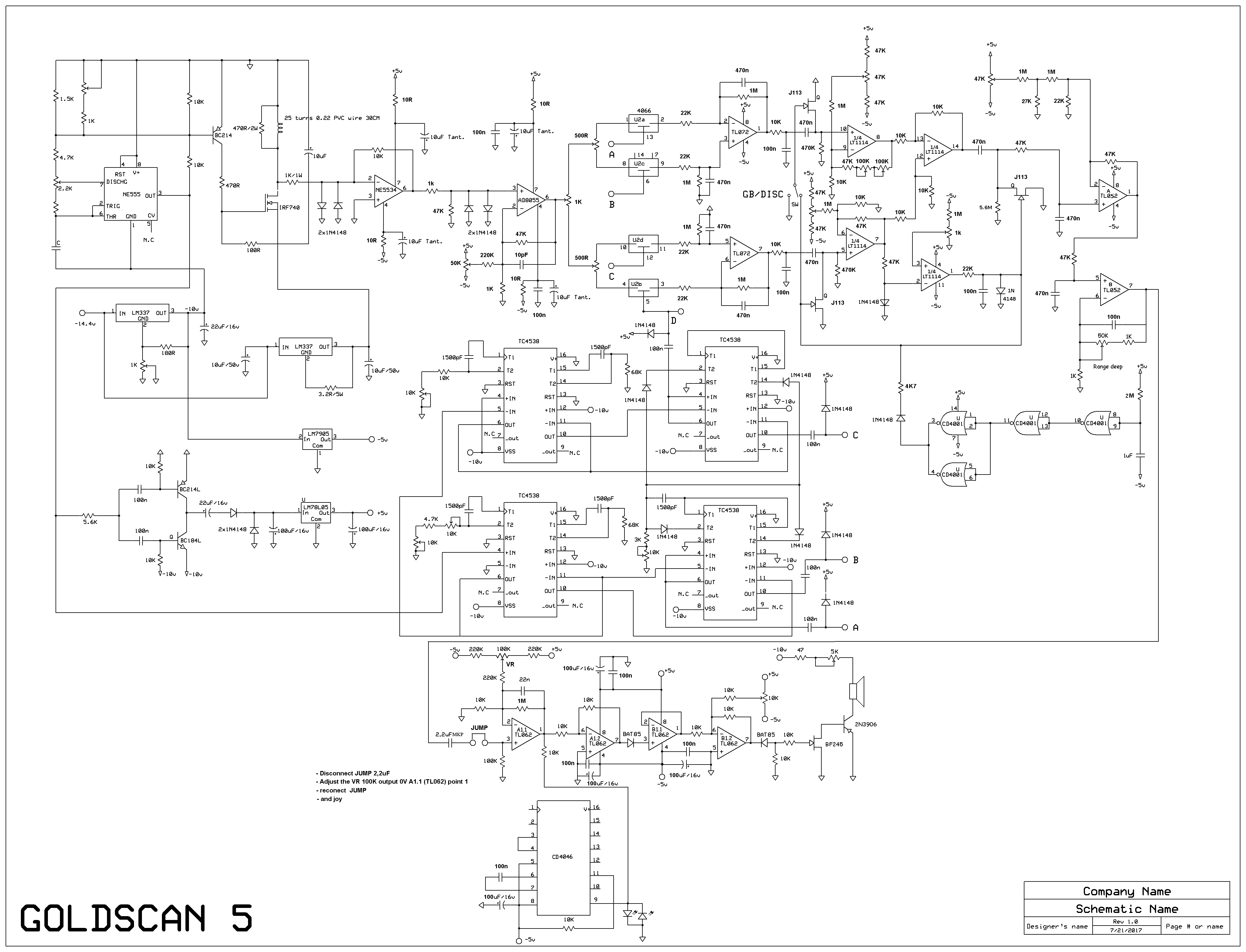

GOLDSCAN 5 SCHEMATIC QUESTION
  • Now that you've mentioned version control...
    I will upload versions of the schematic in github - https://github.com/ex3ek/Goldscan-5

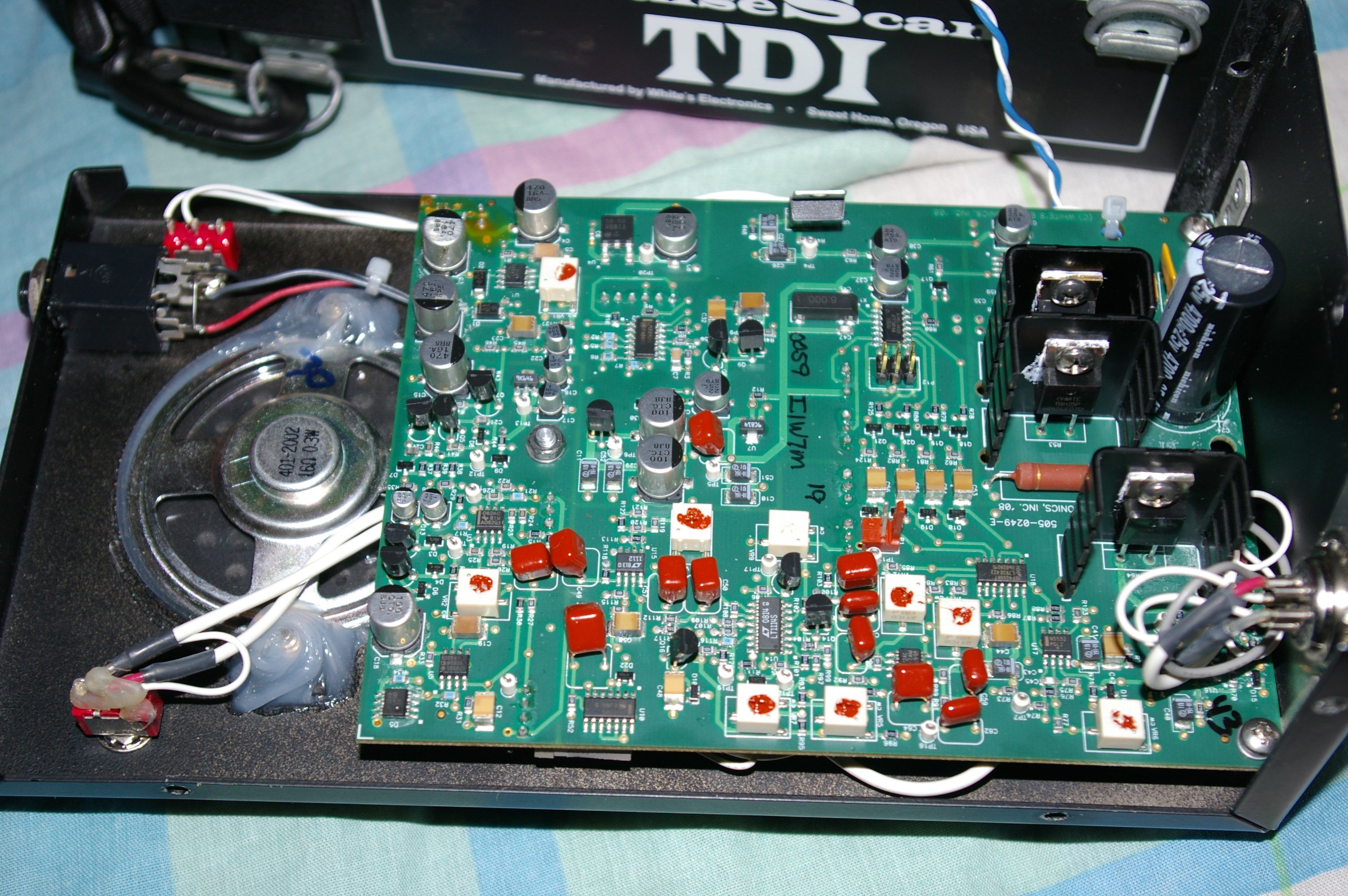

      • [QUOTE = Altra; 236761] Εδώ υπάρχει μια εικόνα TDI με NE5532. Ίσως μια φτηνή αντικατάσταση για τα NE5534 και AD8055; [/ QUOTE]
        Also there is a 5534 near to connector.Click image for larger version

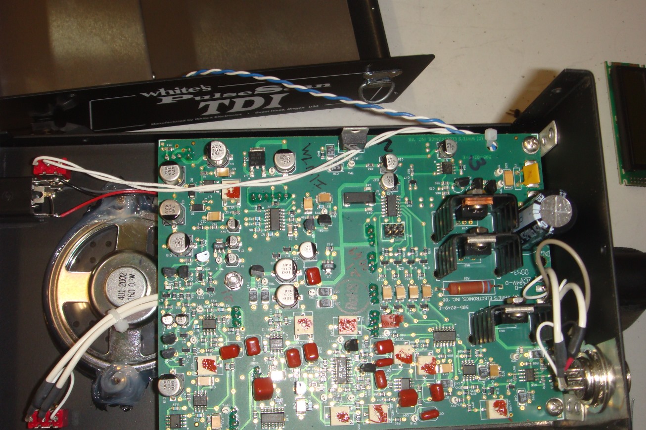

        • Originally posted by Idefix View Post
          Would you post a picture of these part of the board ?
          With a 5532 , there will only have 2 resistors by OPamp, and there will be close to circuit.
          Maybe is a buffer at inverting operation
          • Hi,
            To Geo : the photo is with too low definition to see the value of smd resistor.
            So if you can make a more close picture to the board, it will be better.
            (go outside to have much mor light, it is better for picture sensors )

                    • There is more version ,I'm interested in how much noise there is ,on all metals and how much profit the GEB ??Gabi and Jose can see a video clip ?? If Altra can put the video its TDI proto ?!
                      I noticed that the differential integrator in the GS 4 application generate noise as well as the synchronization cd 4538 ! I think that's the main reason among other things applied by mcu as well as 4053 by TDI SL !
                      https://www.youtube.com/watch?v=dV-3yKez6YY My version 1.0 ]http://tinypic.com/r/2dbm06f/9Click image for larger version
                      • Thanks Orbita, for publishing the scheme.
                        There is little noise with a single channel, the noise increases when connecting the GB channel.
                        The high gain of the GB channel seems to be the main cause of the noise.
                        I do not know how to solve that problem, I was thinking of some type of LP filter as the QED uses, after the integrator, but I have not tested it.
                        Later I will make a video.
                        Jose
