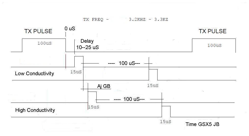

        Now i see timing section AB and CD timings are same and i dont understand who is 1 sample and others because now C ,B is about 10us from TX and DA samples is about 120us from TX
        • The time base that I use in GS5XJB. For the synchronization with the integrators see the scheme, or compare with GS4 Alexismex.Click image for larger version
Name:	Time GSX5 Jose.JPG
          • Thanks my friend

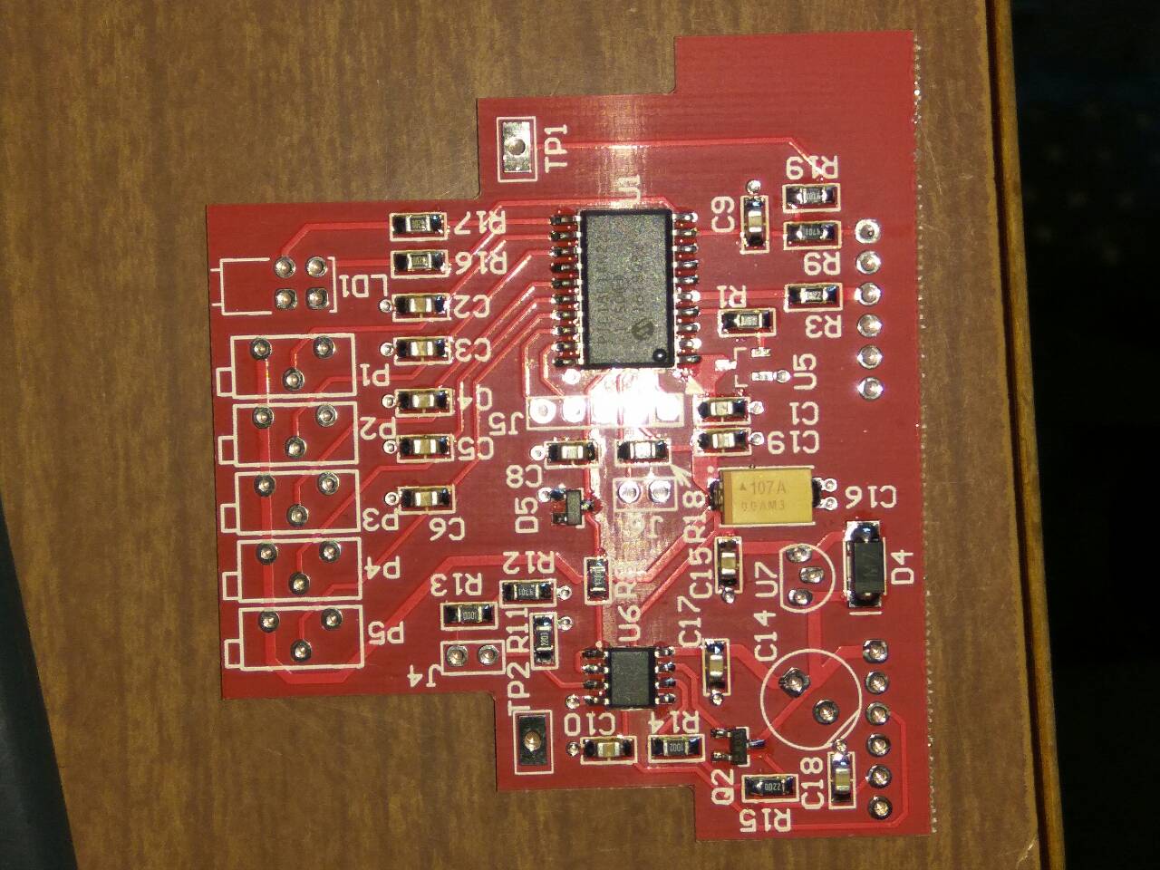

            • Pic for Tdi .Click image for larger version
                Pic for Tdi .[ATTACH]42123[/ATTACH]
                It looks very professional!
                  Thank you, Jose!

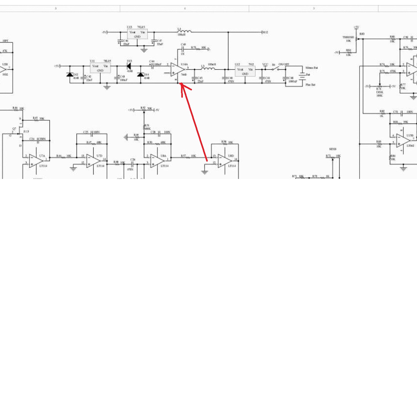

                    • Hi,please someone explain what is chip and how it work?

                        • Can you put whole schematic? It looks like power supply section, but can't see the image is blurry.
                          • Originally posted by saba View Post
                            [ATTACH]43180[/ATTACH]
                            It looks like the power supply section. Put whole schematic, I can't make out, the image is blurry.

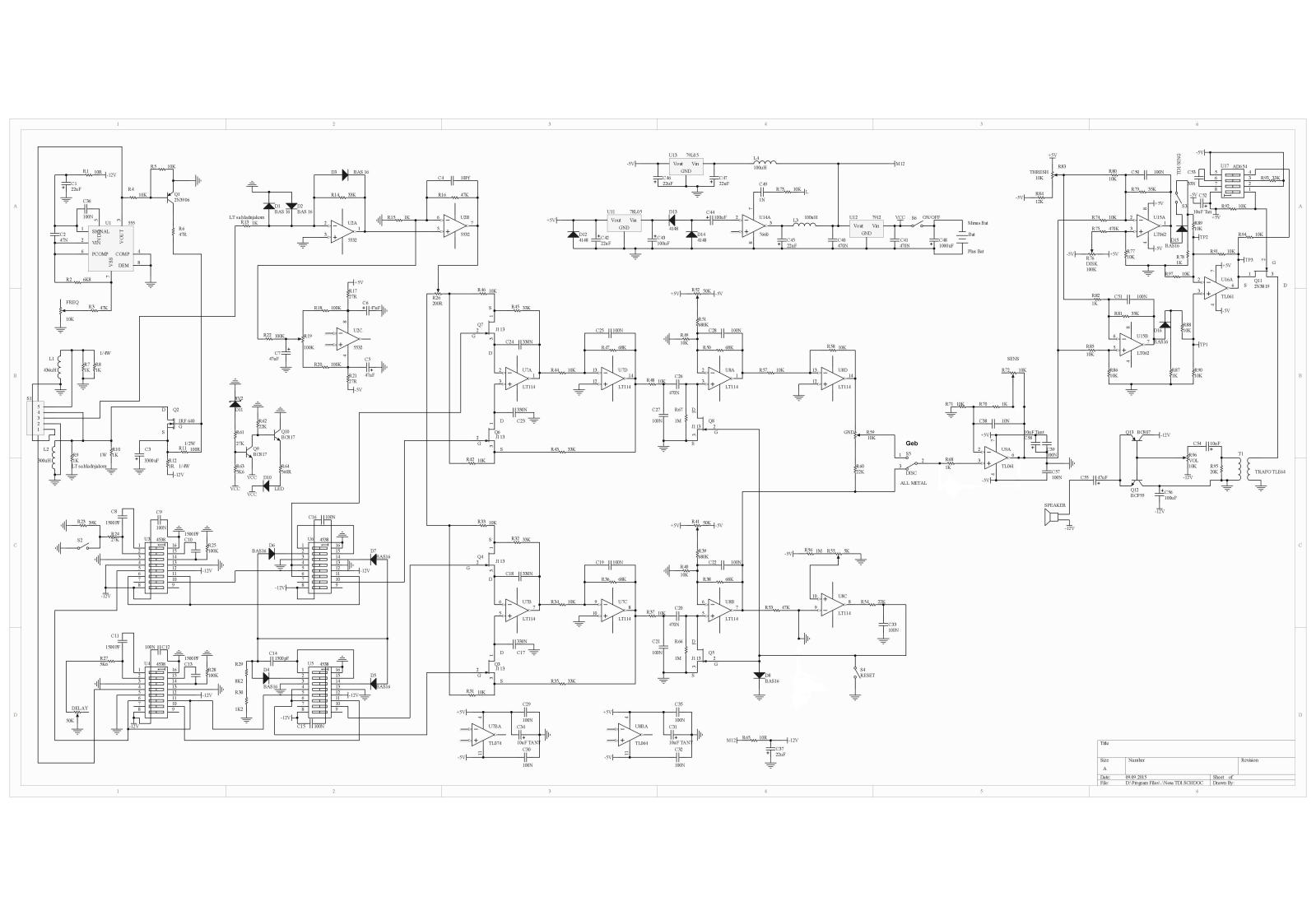

                            • It is Orbit schematic, not so clear
                              • 7660 / LT1054 is used to double the +Bat voltage (0 to 12V from battery becomes 0 to ~24V on the output) then it's regulated down to 12V + 5V = 17V.
                                Look into Minipulse Plus for example it's used there and many other circuits out there. It also can be used to deliver negative voltage. Image is too blurry.
