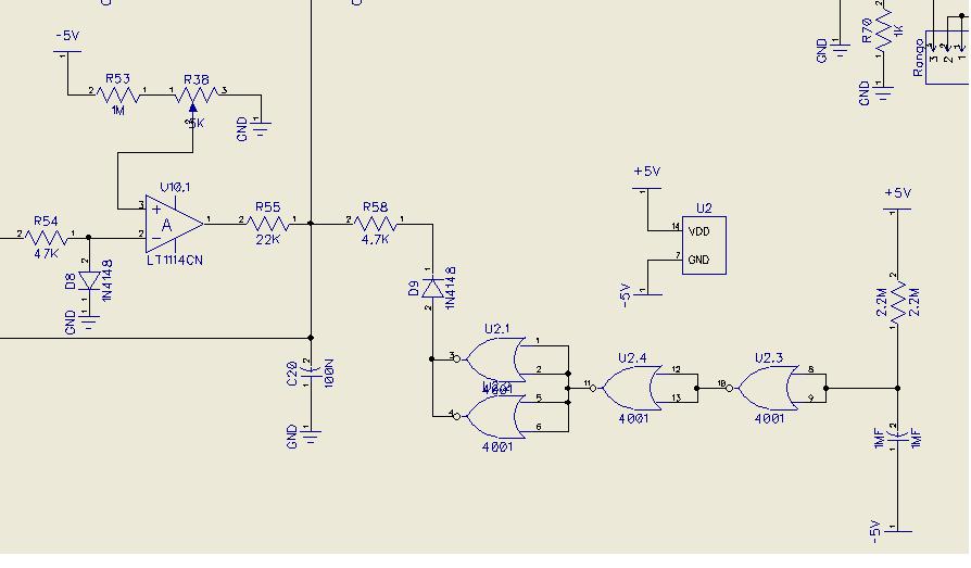

        • #94
          Hello Daverave , in schematic GS5 , i detect an error in my protoboard , see IC2.1 and R25 (1M) you must connect to -5V not to +5V ...just see it and check
          • #95
            You might have a good point there! I bet connecting R25 to -5V is the proper way, as you have discovered.
            • #96
              Yes, -5V it should be.
              Eric.
              • #97
                i think ive found another error on the schematic that was posted on here...if you look at the CD 4001 circuit the output of which go's to D9 then via a resistor to LT 1114...then it should connect to (pin 3) and not to pin 2 as shown in the posted schematic.

                  • #99
                    Dave refer to this schematic - it's R25 which was connected to +5V, now it's connected correctly to -5V. 4001 is removed.
                    GS5-1.1.pdf
                    • Ok Eclipse , now schematic GS5-1.1pdf is correct in these part (R25 to -5V).......... if all the schematic is good , now ?.... i don't not know.... the problem is where 4001 output is connected because i test it and it did not mute completely the first shoot !!!
                      • Originally posted by Alexismex View Post
                        did you see my above post concerning CD 4001
                        • I do not know if this 4001 schema is correct. But it works.
                          JoseClick image for larger version
                            Jose[ATTACH]40109[/ATTACH]
                            • Hi Orbit...its not correct to schematic but if yours works that all that matters.
                                Why should be bothered with the whole 4001 section. Eric confirmed its not an oscillator and i think it wont effect overal performance if you just exclude it. The rest of the design needs more attention maybe there are some more mistakes?
