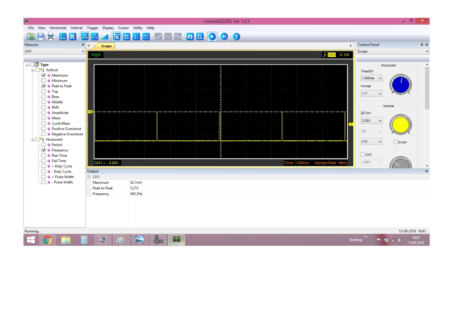

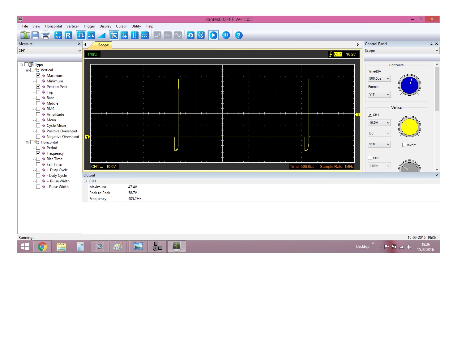

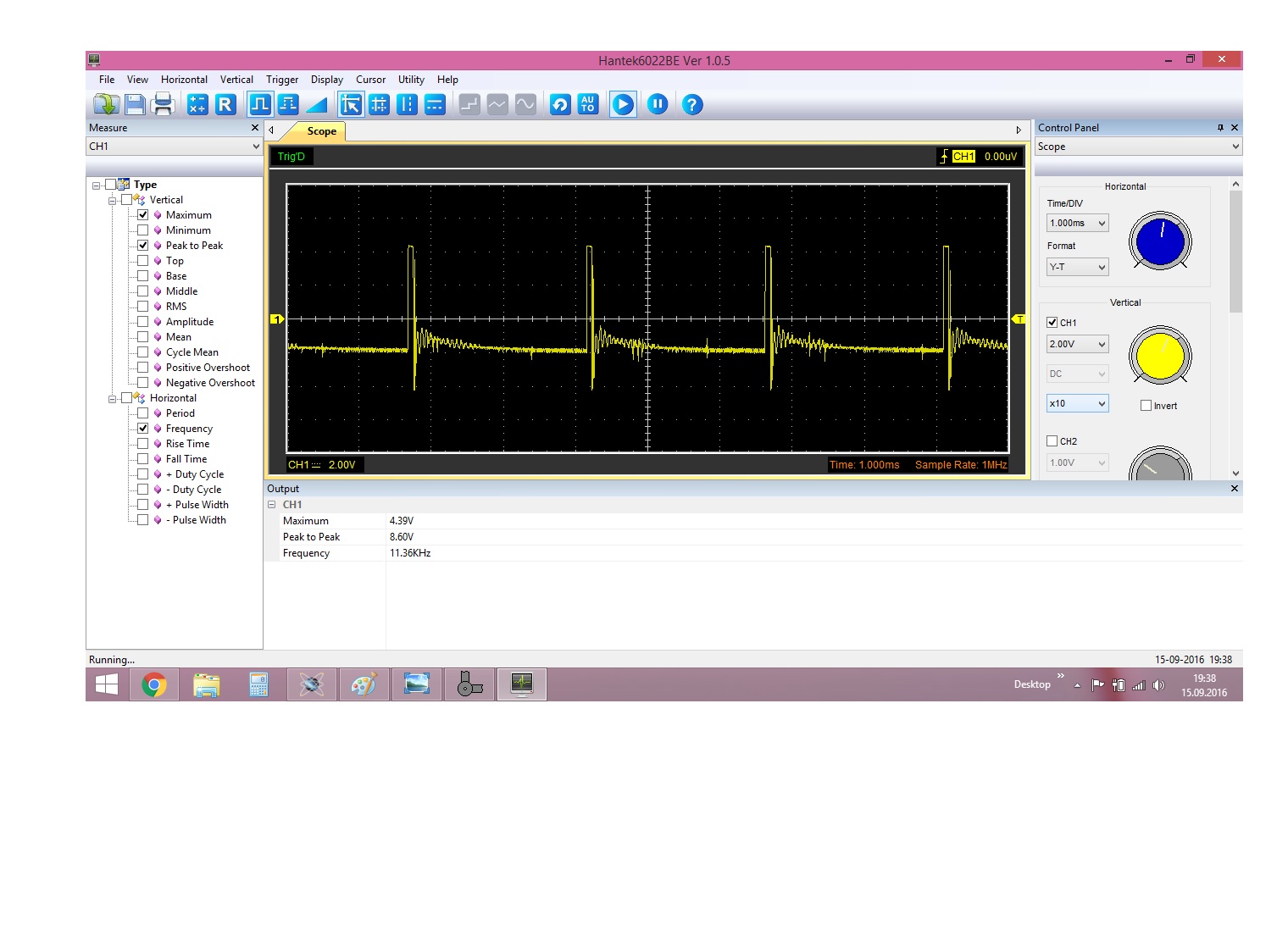

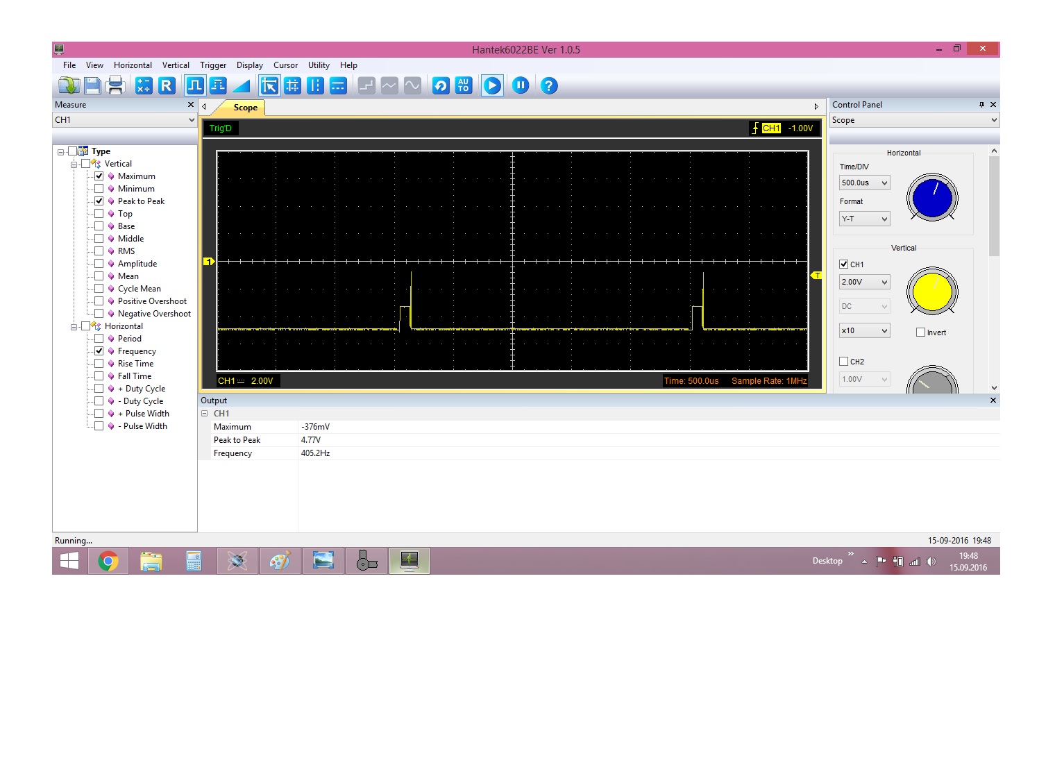

      Maybe I can do this. Yesterday before I closed my box again, I had made some new measurement screenshot.
      Could you please explain what you need and which modification you plan to do!
      • Reptooyep and Blobber,
        thanks for reply. I am thinking about a microprocessing generations of control signals in order to manage it dinamically and thus add more capability in detection.
        A better preamp stage would be another point to develop, with also a new coil drive stage.
        I should like a time diagram (oscilloscope tracing, manual sketch) with time signals durations of the two sampling control signals, in the range: min, max of eliminator pot.
        Ok, I could draw it by himself but if it's already available....

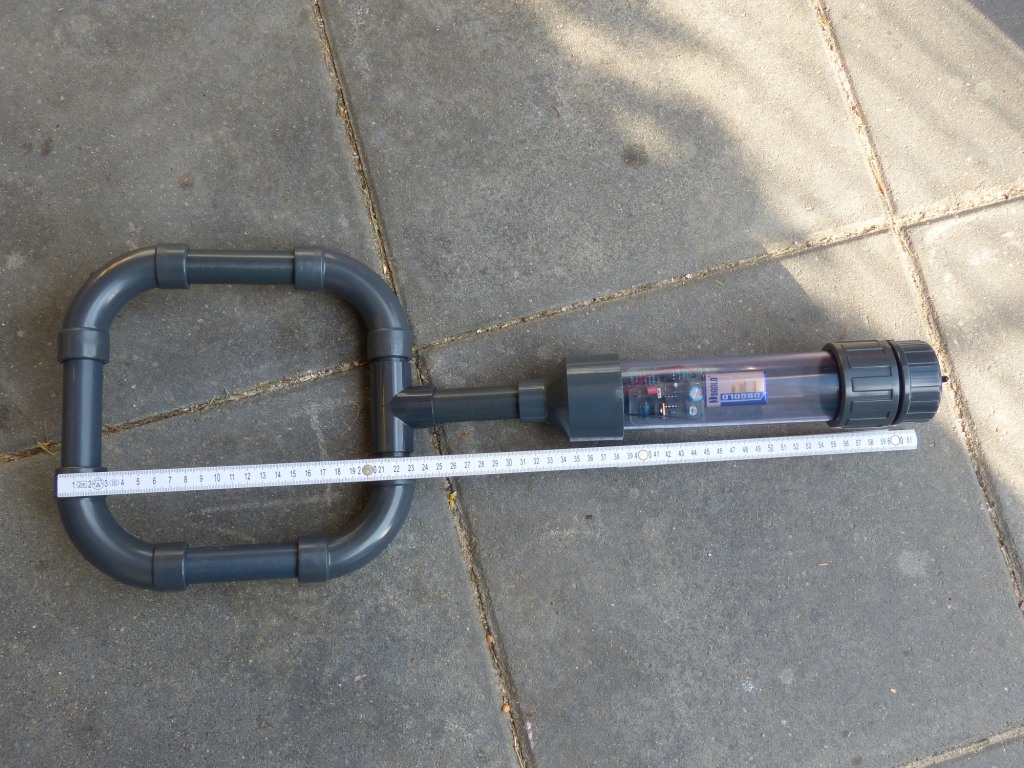

        • hello fred, try this way
          http://www.geotech1.com/forums/attac...6&d=1464802146
          you can buy all parts in Germany from hgt Technik
          just pcb has to be modified or try another Project like pickini pi (just on on off Switch needed, rest is automatic calibration)
          • Nice design bernte_one, but this is made for divers. I like to use my unit, while snorkeling in breast deep water.

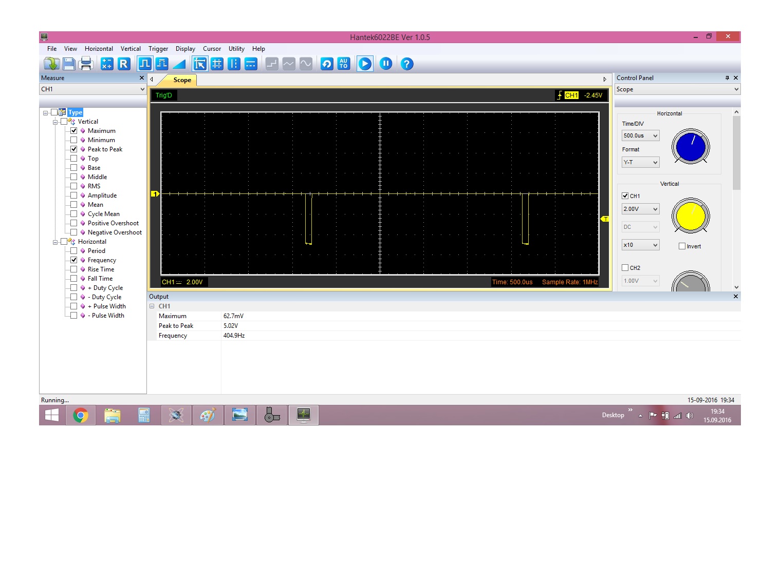

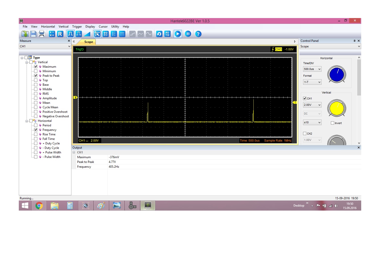

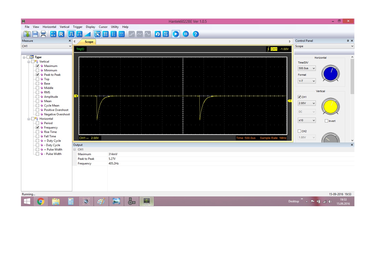

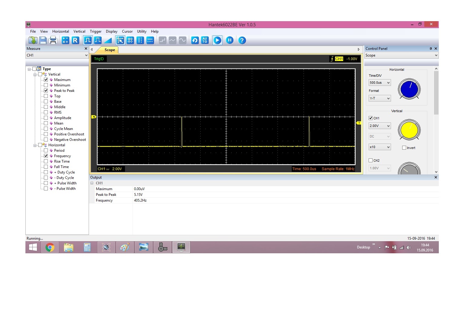

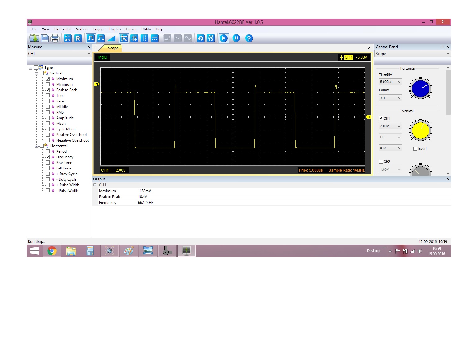

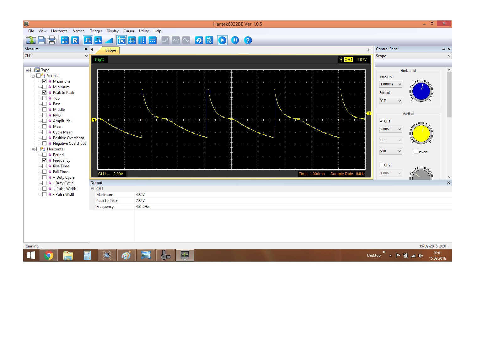

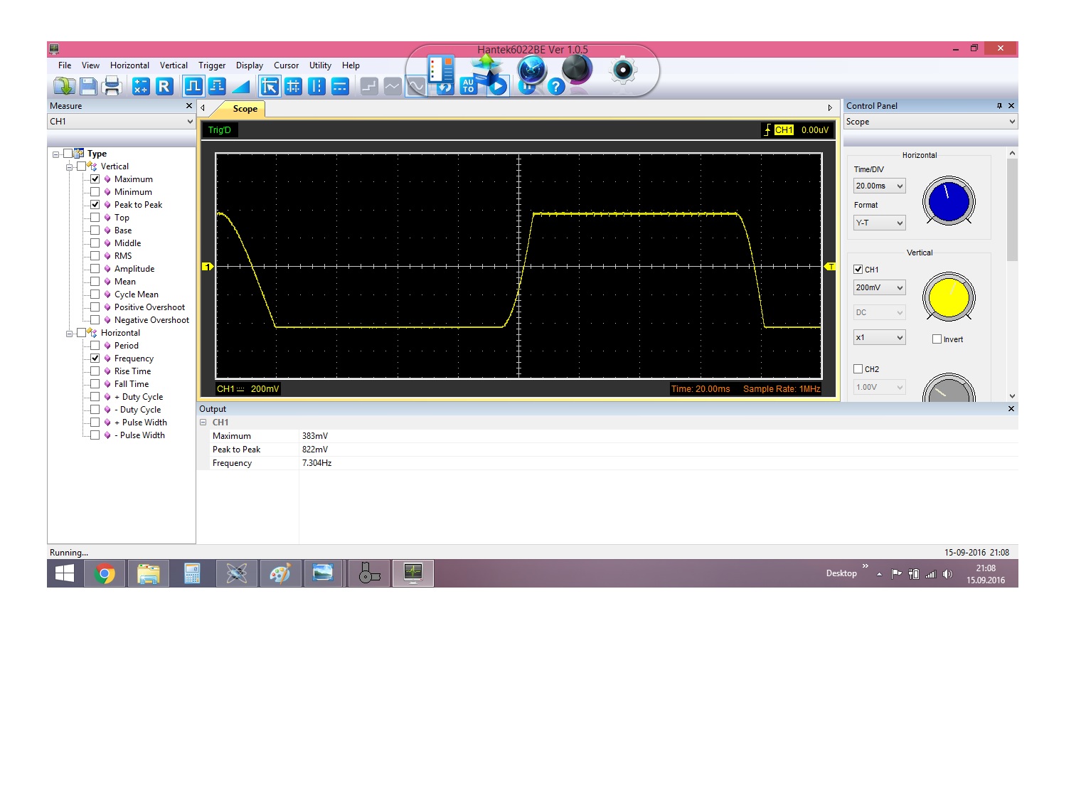

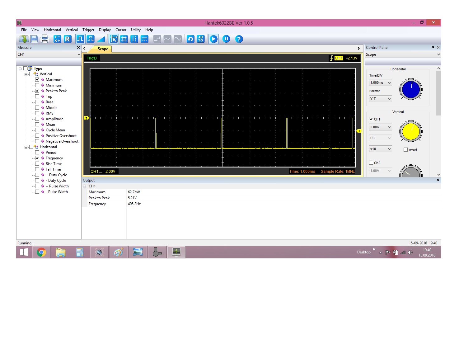

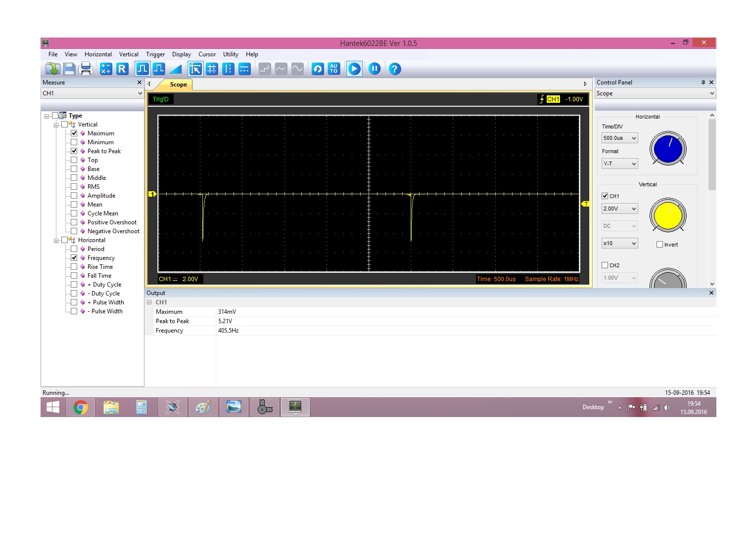

              I hope this pictures, which I had made yesterday, could be what you need. If not so, please let me know!
              What kind of micro processor do you think to use. Is there a possibility to use the ATXMEGA32A4U, like in the IB detector Krot FM2?
              I would be glad, if you are planing an open source project, as you could share your information with this forum here.
              In #29 of this thread, is a version with a PIC18 chip. It seems, that many people are very interested in such detector, but the hex file is unfortunately not included.
Name:	first 4538 pin2, no disc.jpg
Name:	first 4538 pin2, full disc.jpg
Name:	first 4538 pin6, no disc.jpg
Name:	first 4538 pin6, full disc.jpg
Name:	first 4538 pin10, no disc.jpg
Name:	first 4538 pin10, full disc.jpg
Name:	555 pin3 charge pump.jpg
Name:	555 pin3 400Hz.jpg
Name:	collector T 2.jpg
Name:	709 pin 6.jpg
Name:	4066 pin13.jpg
Name:	4066 pin10.jpg
Name:	324 pin14, with moved target.jpg
                • This time, I had made all measurements with plus pole of pcb to ground.
                        the desgin from minelab excalibur would fit
                        pot detector in pipe or if pie doesnt fit for pcb size use water sealed freeze container (tupper box) with rubber sealing
                        so you have nor probelsm to build a enclosure
                        • Progress...
                          Test signal from T2 collector...ok got signal
                          Put 709 (use LM308 )to check small signal...no, but my coil is make sound zzzzzzzztt when metal is close...???
