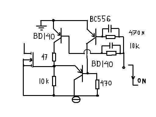

            If you mean the test circuit that i have make Click image for larger version
              Originally posted by Xtrem View Post
              If you mean the test circuit that i have make [ATTACH]54446[/ATTACH]
              Yes , thank you.

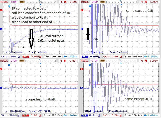

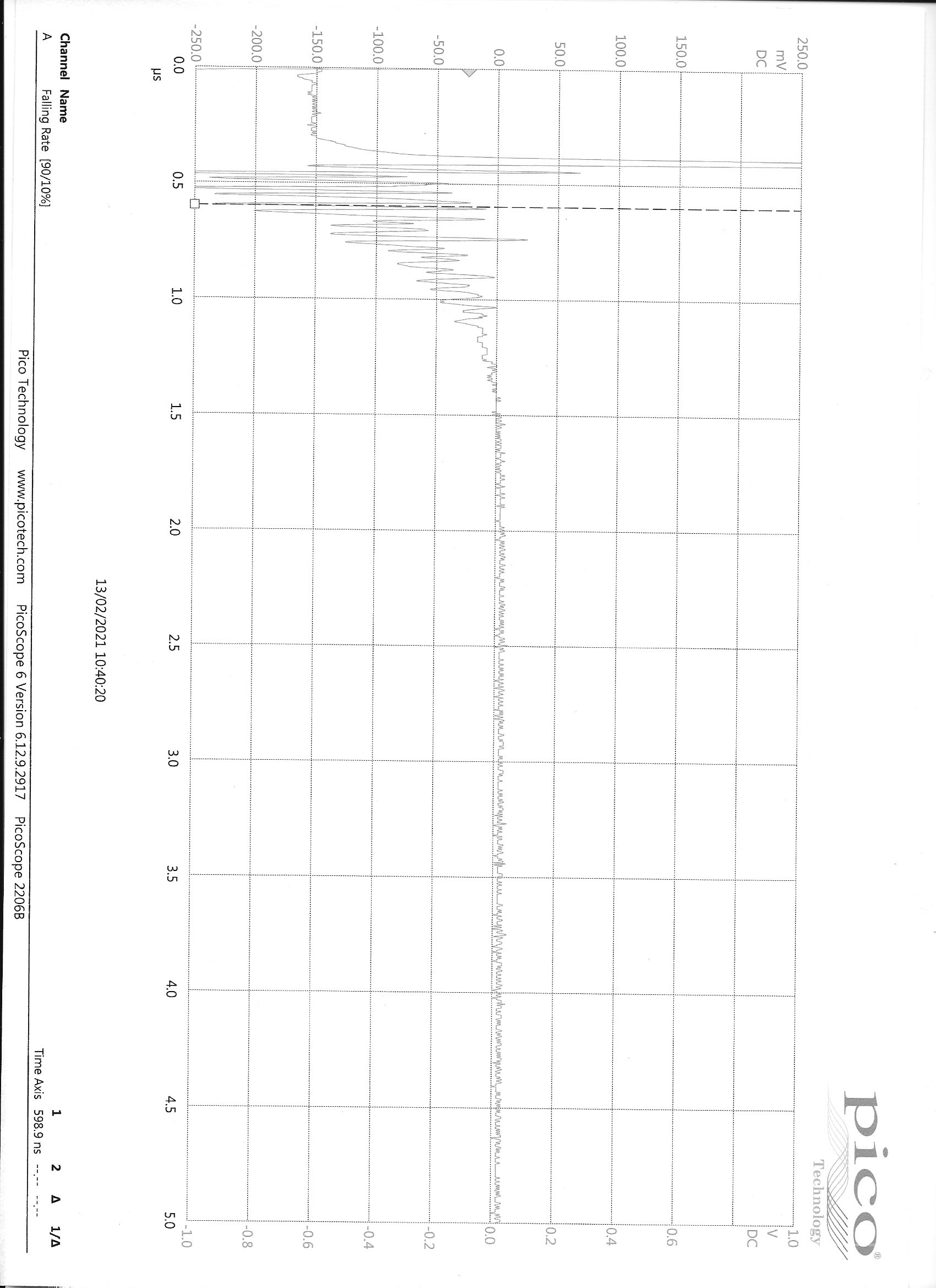

                I look at the turn off by inserting a 0.1ohm resistor in the ground lead from the coil and cable, just between the end of the cable and the circuit board. I use a thick film resistor, which has a tab looks like a TO220 size device, on the basis that it has minimal inductance. Scope is across the twin lead of the resistor. In the attached plot the scope is triggered by the falling edge of the drive pulse and we seen a delay of about 0.3uS before the Mosfet switchoff starts. The current pulse has a final peak of 1.5A, which develops the -150mV across the 0.1ohm resistor. The small turn on delay is of no importance in the light of the relatively slow build up of current due to the coil inductance.
                In this case I am using the A.C. coupling as per 6 on pages 36 - 38 of the Texas paper, but without the zener. The diode gives just one diode's worth of negative swing to assist discharge of the gate/source capacitance. The Mosfet I am using is Infineon 17N80C3. Rgs is 100K and Cc is 0.47uF. Additionally there is a 10ohm resistor right where the gate leg is. For about 1uS the switchoff looks a mess, but from from 1.5uS onward it is clean without further ringing. Ignoring the initial noise the switchoff is fast enough for my present requirements. I am also using a series diode, HER208, to isolate the coil from the Coss of the Mosfet
                It is hard to know what causes the ringing. Changing the scope probe from x1 to x10 and changing the scope sensitivity to match, gives a similar result but it is more symmetrical about the 0V line. Next thing to try is to disconnect the Rx and then replace the coil with an equivalent thick film resistor.
                With my preamp setup using OPA1611 and OPA1612 with a total gain of 470x; a 10" 330uH fast coil and 1.2m of 75ohm coax, the earliest I can sample is 5.5uS. The limitation seems not to be in the Tx but in the receiver front end in terms of bandwidth and recovery time. The OPA1612 stage appear to need a faster device as there is no improvement even when the OPA1611 is replaced with a very fast AD8055.

                Eric.

                  Been wondering about gate drive. Need a gate resistor, what value? I have been driving the gate with op amp output in a control loop. I purchased some UCC27518 and UCC27519 drivers awhile back. Used them when I made bipolar Tx. Seemed to work ok. Replaced control loop with UCC27518 driver for my unipolar Tx. Some pictures with unipolar Tx. Wondering if they should look different. Don't have a .1R, tried a 1R and .01R. Oscillation at turn off. Same oscillation with scope lead connected to +batt(scope common lead). Thinking no oscillation?
                  Think my resistor is connected same location as yours.
                    I kept everything in place, including the cable, and substituted the coil with 6.6ohms of thick film resistor so that the pulse current is of the same order. The result is that most of that ringing hash is absent. Just one much smaller ring of a couple of cycles disappearing within 1.5uS. My coil is wound with 1/0.1 PTFE insulated wire with metallised fabric shield. Coil plus 1.2m Belden coax gives a total resistance of 6ohms. Resonant frequency with cable is about 1MHz.
                    Maybe my method of shielding causes high frequency ringing?

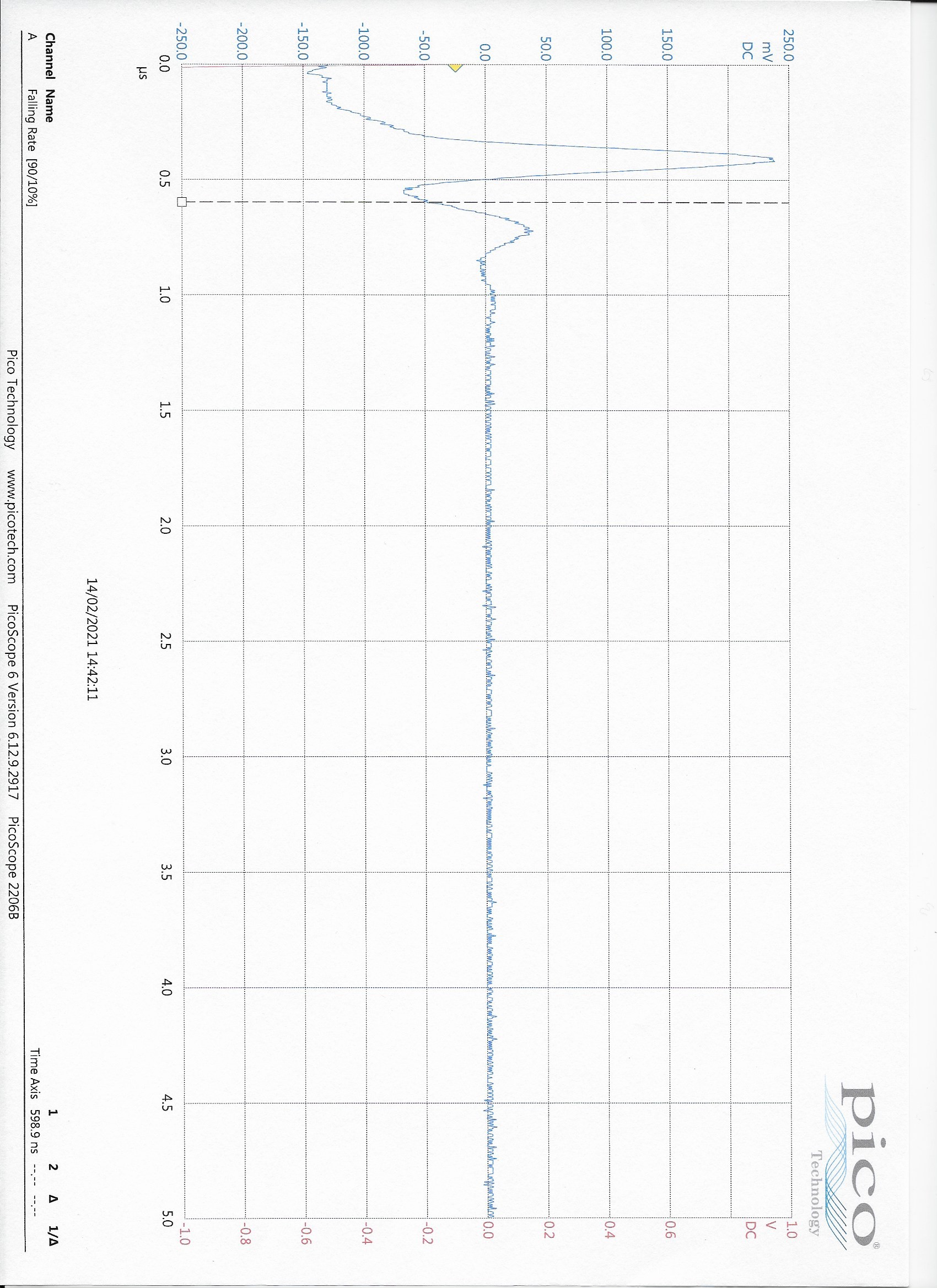

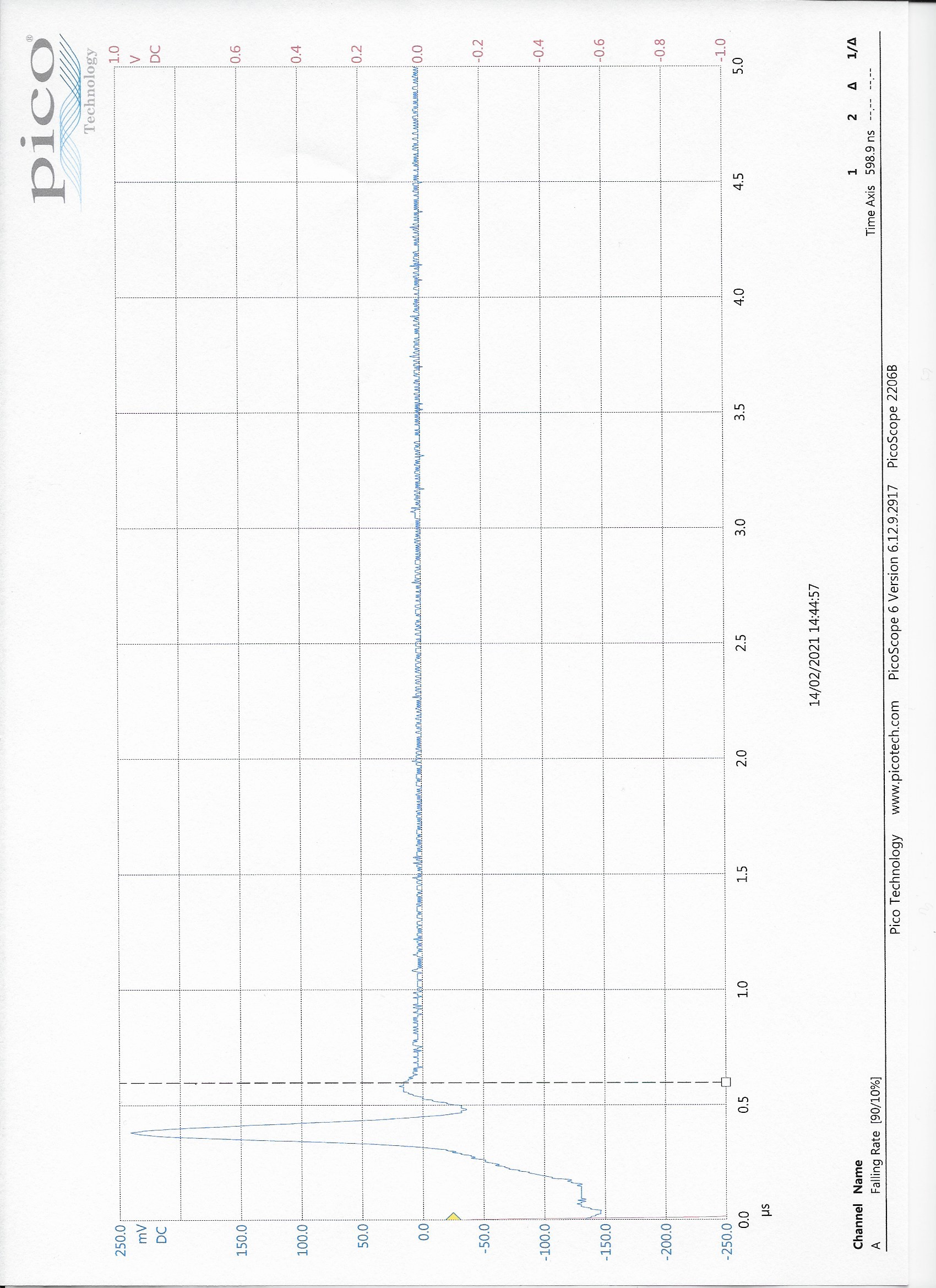

                              Still looking at the current waveform by scoping a 0.1ohm resistor in the ground return from the coil, except that the coil is replaced by a 6.6 ohm resistor (3x 2R2), with the coax still in circuit. All the hash has disappeared and we have a clean couple of cycles of decaying ringing. Next is for the resistor to be straight on the board i.e. no coax. Still a ring but all decayed before 1uS. I measured the coax with the resistor termination and it gives a reading of 0.475uH which together with a capacitance of about 80pF may account for the extended ringing in the first plot. Perhaps my wrap around shielding contributes some additional ringing frequency that explains the additional 'noise' on yesterday's plot.

                              Eric.
