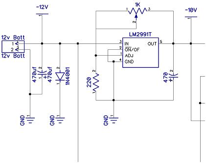

          ive tested the +5v & -5v supplies and are stable when the supply voltage is reduced....the - 14v & -10v supplies change according to lower voltage levels...i may try and increase the -10 v to -12v so if i drop the supply voltage a couple of volts then in theory if that is the problem the threshold should not change.....if not i may have to change the -12v regulator on the audio pcb to a low drop out type....like most of us we are still learning about detectors and cannot know everything that raises its ugly head.

              on the GS 5 there is an adjustment for fine adjustment of the threshold level which has a -5v & +5v on each end of the potentiometer...the -5v & +5v supplies are stable even with the supply voltage down to -10 volts...its the -10v & -14v supplies cha nge according to supply voltage...i would have thought the GS 5 should operate down to maybe 11 volts without any problems but im only guessing.
                I always expect problems when I am under drop voltage of regulator Stable mean you already checked with scope in mV scale?
                  Battery voltage needs to be kept healthy for device to function properly. The regulators need more juice.
                    Try a negative, low-drop regulator.
                    I use LM2991T.Click image for larger version
                      I use LM2991T.[ATTACH]44665[/ATTACH]
                      Hi jose....did you have the same problem with a GS 5 ????
                        I think I saw 79L12 reg. as well for audio stage. You'd have to maybe change it too.
