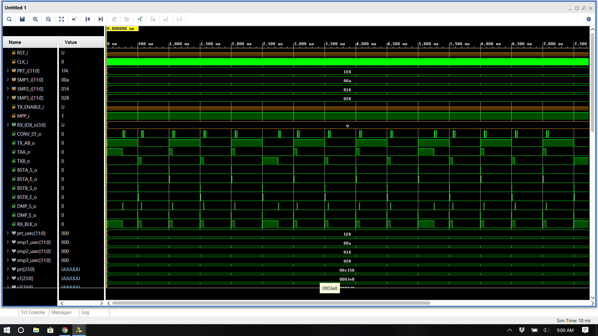

                  New Bipolar_TX version... added MPP
                  ... The Vivado project files are in a zip at this link.
                  https://drive.google.com/file/d/1A0Y...ew?usp=sharing
                  New Bipolar TX version (5-28-2019)... new link: https://drive.google.com/file/d/1Rw6...ew?usp=sharing
                  While visiting the NC coast last week, I had a brainstorm. What about the option to transmit two different pulse widths. So I coded in the capability to transmit one wide TX pulse (one half PRT) pulse followed by 4 bipolar pulses of normal pulse width. This maintains the bipolar nature of the TX. The capability will be controlled by the input MPP_i (Multiple Period Pulse) being held high. In the tested example the PRT is set to 500 usec, S1=10usec, S2=20usec, s3=40usec, MPP=1. This resulted in a positive cycle (TXA) of a 250 usec pulse followed by 4 cycles (starting with a negative (TXB) cycle) of 50 usec pulses which is followed by a negative cycle (TXB) of a 250 usec pulse followed by 4 cycles (starting with a positive (TXA) cycle) of 50 usec pulses. This results in an average duty cycle of 18% with MPP vs. the normal 10% duty cyle.
Name:	Bipolar TX Timing (MPP).png
                  I have updated the link for the zip containing the current Vivado project files and included a text file of the VHDL code for those that cannot view the Vivado project files. Hopefully, I will get the testing/verification of the pulse transformer connections completed this week.

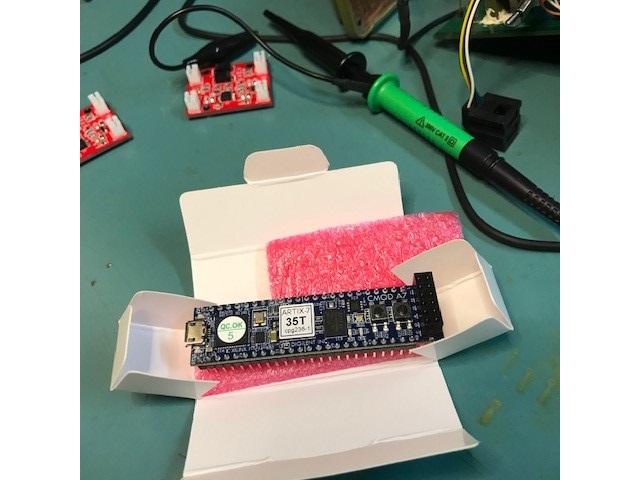

                    Nice work JL, this is looking quite interesting, thanks for sharing.
                    I have just received the Artix 7 module so i can start playing.
                    Haven't had much time to check your TX PCBA again but will do, however last time I checked it looked Ok

                    • #70
                      [ATTACH]46510[/ATTACH]
