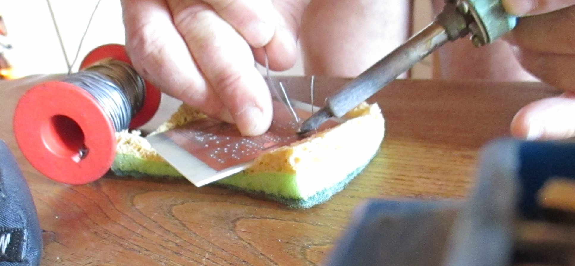

            Hi kt315,
            Correct, total beginner, learning things as I go as I enjoy that.
            I bend the pins on the rear side so that the part stays put while i solder.
            Is there a better way of holding the component in place whilst the board is upside down for applying solder?
            happy to hear any tips for improving my technique.
            Thanks!
            -Jared
              certainly yes. it is your second hand.
              Anatloy
                Just a tip with a sponge.
