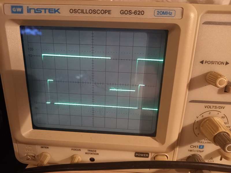

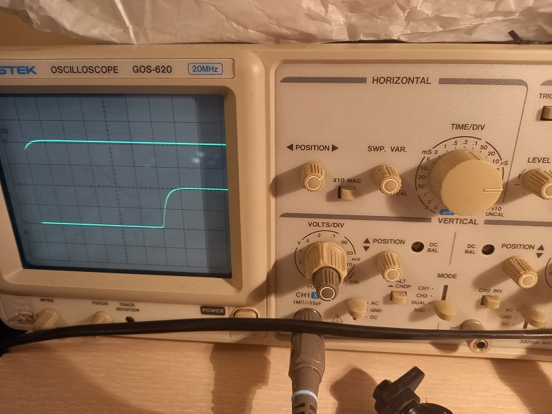

              I measured the TDI SL delay and it's not even 10us, more closely to 11us; The Sierra Pulse Pro (SSP) version is even worse - 12uS
              What signals are you comparing?

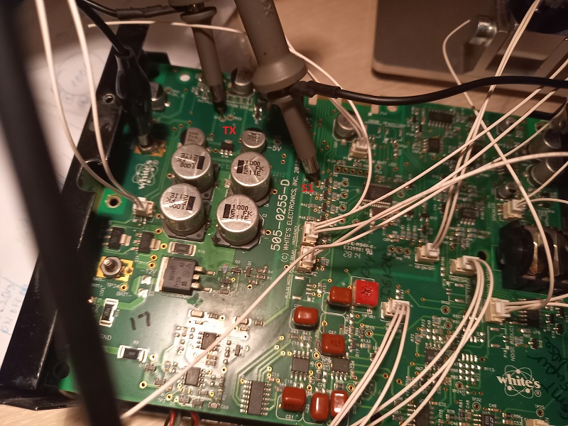

                Here I have a SPP (TDI SL with the only difference - fixed primary delay at 12uS). Scope is 2uS/DIV
                In my book the TX is MCU PIN6, the Sample1 delay is PIN26. The test points I use are (TP1) on the board which is TX, R37 on the board (MCU PIN26) which is Sample1.
                I'm working on a new chip board addon which will take care of the delay problem, probably adding auto min delay depending on coil /starting 8uS/ so the initial delay will be auto-calibrating during search.
                Must be on a new board because the pin out is QFN64 and requires a bit components soldered, and the -5V_D regulator will be replaced with -3.5V regulator. I'm also thinking of giving the TX_WIDTH option some breath, this will adjust the TX width up to 120uS with the frequency ~3Khz and below to stay in the proper range of TX cycle and if the pot is turned >50%, the frequency will go lower(600-800Hz) and pulse width - 120-200uS. This could be used for hoard/relic hunting with large coils etc. In this case also a mod of the 2x470K in the SAT stage will be upgraded with a dual pot 1M+470K so the SAT can be adjusted properly /large coils = slower swing/

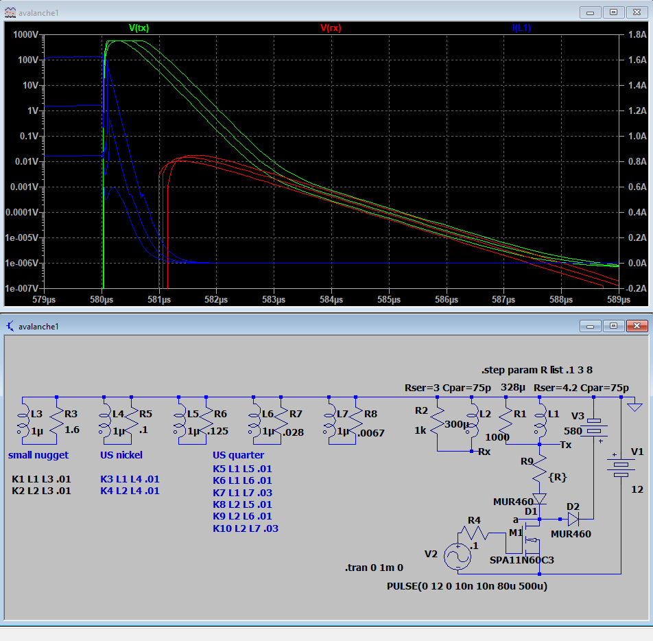

                      What is actual coil turn-off? Picture I posted awhile back, turn-off command at 580us. What time do you consider actual coil turn-off?
                      • #41
                        The start of current shut-down, which would be the 580us mark in the sim.
