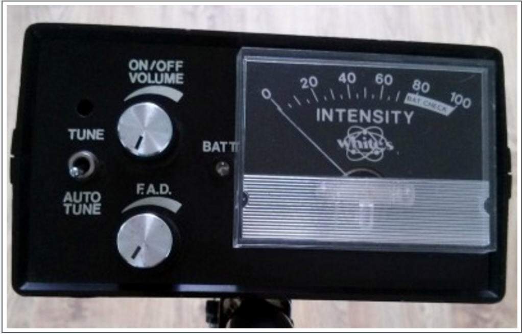

    Having done some more digging and research, I realized that there was also a PI 150 pipe locator which is a totally different circuit(although it does have similarities).
    This was the circuit which was back engineered by Ivconic, and not the AF-108.
    I also found a photo of the PCB of the AF-108 mine detector. Note that the quad AND gate is a 4081 just as waltr had speculated(on the schematic it is mislabeled as CD4069). And also have a look at those lovely BUY92's, with there custom heatsinks. Wow! that's fantastic.

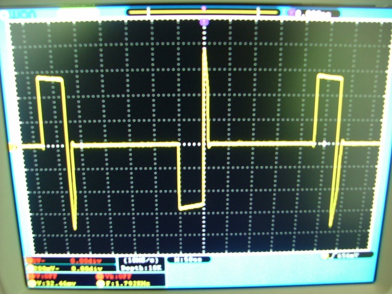

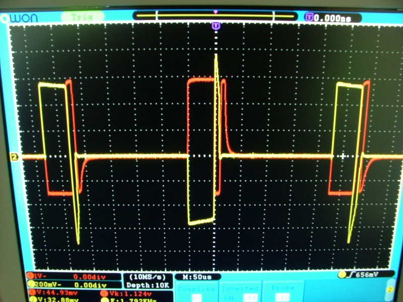

                Can the TX pulse rate and pulse width be determined from these scope shots? It looks to be around 3.8kHz and pulse width of about 50uS. What do you guys think?
                • #83
                  Yes. It shows the scope set to 50uS/div. There are about 5.5 divisions between pulses so 5.5 x 50 = 275us then 1/275us = 3636hz. Pulse width = 50us
                  • #84
                    Great, thanks for verifying this.
