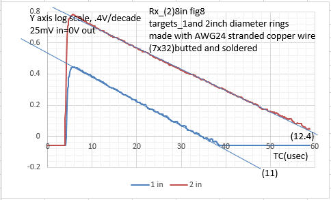

      Tried another test with larger target 2times the smaller. The wire ring time constants are closer than the solid targets. 2in target is 8times higher than the 1in target at about 30us and doesn't vary a lot.
        You are right in that we are not measuring the voltage induced in the target, but the the rate of change of the current with time and the voltage this induces in the now RX coil (assuming a mono). This is explained in a paper I have somewhere, but still packed in a box after last August's move. From memory, two identical solid spheres are described with the only difference being the conductivity. The low conductivity sphere exhibits a high starting voltage as seen as a voltage across a Rx coil, with a fast decay; while the high conductivity sphere starts with a low voltage and a long decay. The area under the curves (energy dissipated) is the same for the two spheres.
        This effect is also exhibited by the coil itself, which becomes its own target at switch off. Suddenly open circuiting the coil causes the voltage across it to rise to several hundred volts as it tries to maintain the magnetic field. This energy is partly dissipated in the damping resistor.

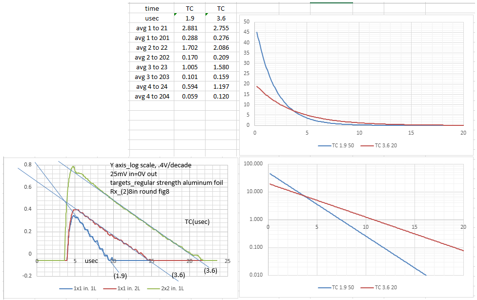

        Don't have two identical spheres different conductivity. Tested a 1inch square and a 2inch square cut from aluminum foil. Wanted to see if area under the decay curve is the same. Extended the curves on the measured chart. Used Excel to make decay curves(similar decay rate that crossed at 3.5us) that I could calculate area under the curve for both targets. Calculated close to same if 1us was the start time. Thinking about doing the nickel and quarter. Quarter doesn't have straight line decay linear X log Y so generating a quarter curve with Excel is slowing me down. Any thoughts appreciated.
        Wrong, compared 1 inch square targets with 1 and 2 layers.

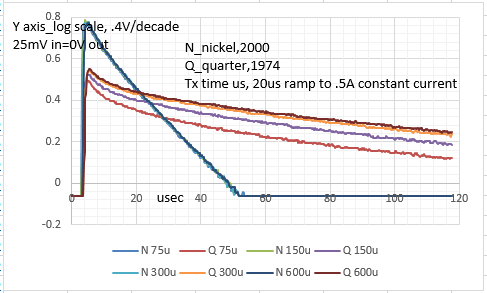

          Following this thread with great interest. Did a simple test with my MPP E Ferrite Pinpointer.
          It does fit in with what you are delving into, green. Normal silver stuff only gets about half the distance of the gold.
          For what its worth:
          PI probe 340uH, 68 Ohm resistor in series. cable/probe/shielding @ 256pF.
          PPS 2370Hz, Pulse width 31us, sample width 17us.
          Distances for solid detection:
          Sample delays: 10.5,11,12,15,20,36us
          Nickel: 9,9,8,8,7,5cm
          Quarter: 6,6,6,6,5,5cm
          3.1g Au 9ct.: 9,9,8,8,7,6cm
            Thanks for the replies. Think some of the statements are missing something.
            Why is the decay start signal for the nickel greater than the quarter or the Ike dollar? The nickel is smaller, I could guess but then it would be a guess. reply #7
            The area under the curves (energy dissipated) is the same for the two spheres. reply #18. Think for targets having the same diameter, area under the decay curve is the same. If target time constants are the same, slope and amplitude will be the same. If time constants are different the lower time constant target will have a higher starting voltage.
            Signal amplitude is proportional to the cube of the diameter reply #26. Think average signal amplitude is proportional to cube of diameter. If larger target is twice the diameter the smaller, the average decay signal for the larger target will be 8 times the smaller. If decay slopes are different, the larger target will be 8 times the smaller at one sample time only.

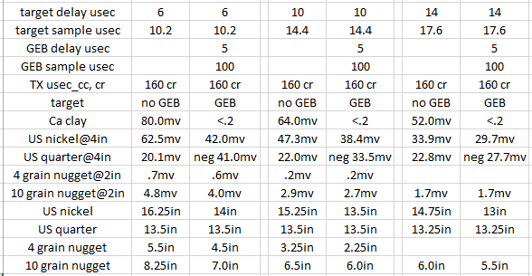

                Funny you posted this. For the last couple of weeks I've been optimizing the timing on a new rev of the Fisher pinpointer. It uses bipolar pulsing and with a short (20us) sample width has the obvious problem of detecting nickels well but quarters not so well. I decided to stretch the sample width out to get the quarters better and expected the nickel response to either degrade or get noisier -- it did not. Quarters got better, nickels stayed exactly the same. This uses a sampling integrator which may explain why. Had I used a SHA-type demod then I think the nickel would have been weaker due to averaging. I did not stretch the sample width all the way to the next TX pulse but will try that.
                  Chart I posted awhile back when my bench circuit was working. Integrator out readings, first sample(target sample) and second sample(ground sample + target sample). Ground sample=second sample-first sample.
                  First two columns for the nickel(first delay, 6us). First sample(10.2us, 62.5mV). Second sample(100us, 42mV). Ground sample -20.5mV. If first sample was 110us with no GB(83mV). 1.33 times signal increase
                  First two columns for the quarter(first delay, 6us) First sample(10.2us, 20.5mV). Second sample(100us, -41mV). Ground sample -61.5mV. If first sample was 110us with no GB(82mV). 4 times signal increase
                  Can't do GB if first sample is over 100us?
                  Hope it makes sense, was getting confused typing it.

                        110us sample gives 1.33 times the signal as a 10us sample for the nickel. 110us sample gives 4 times the signal as a 10us sample for the quarter. A longer sample might help for the quarter not the nickel. Probably can't do ground balance with a 110us target sample.
                        • #42
                          For the application I am working on GB is not required, but better range on higher conductivity coins is needed. With lower conductivity items, the fact that the range is little better than with a short sample pulse, is fine. I am also going to look into the integrator time constants as these may not now be optimum with the long samples.
