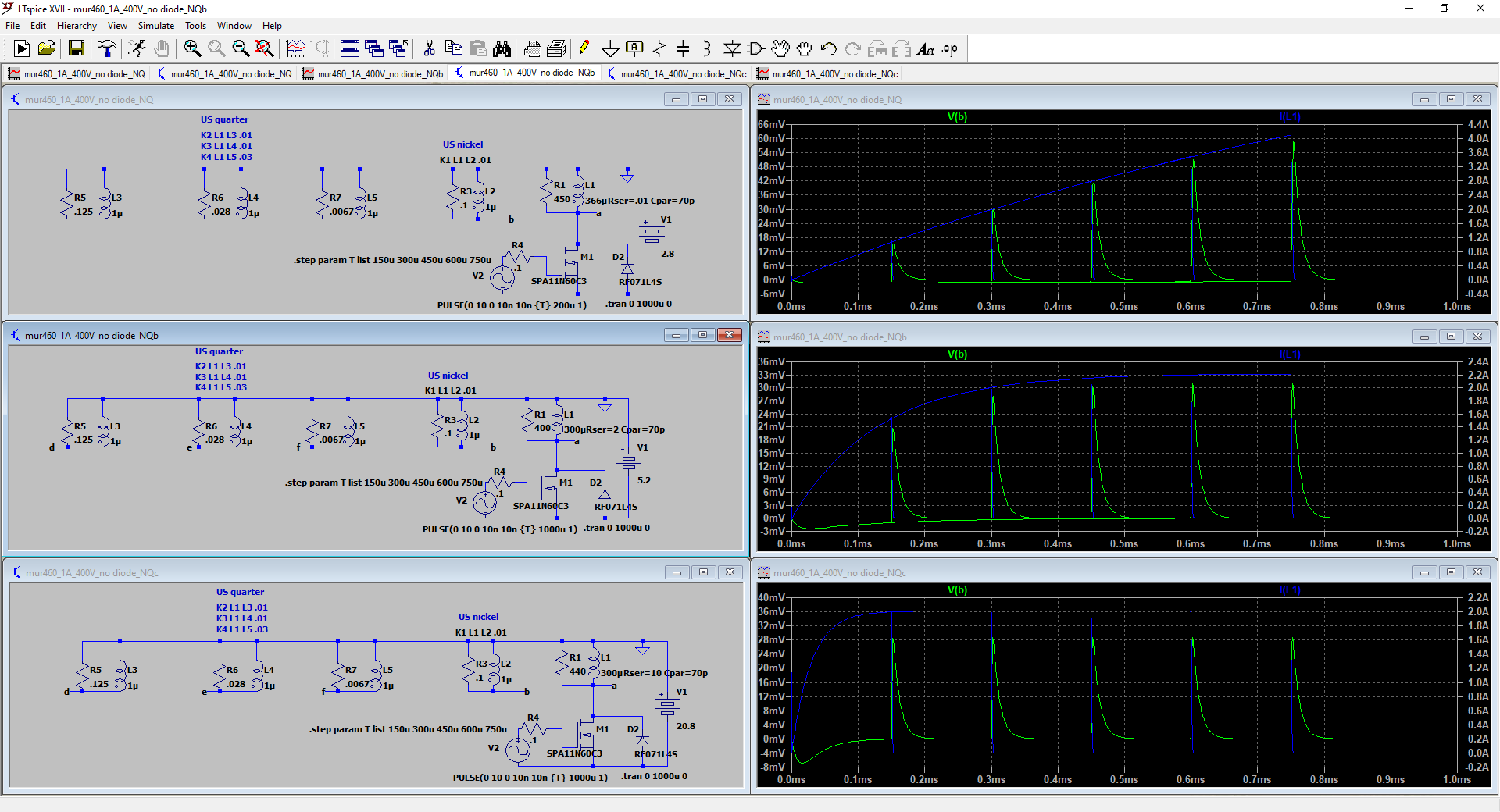

                    Not clear what you are suggesting. I would think target saturation might mean an increase in peak Tx current at Tx off wouldn't increase the target or Rx signal. What is your meaning of target saturation?
                    Including a spice simulation(coil current and target signal) with different coil resistance, close to constant rate, charge TC=150us and charge TC=30us. Power supply volts adjusted for 2amps at 300us Tx on time.
                    Does the simulation make sense? Are there changes to the simulation that would make it better? Is there a way to simulate target saturation?

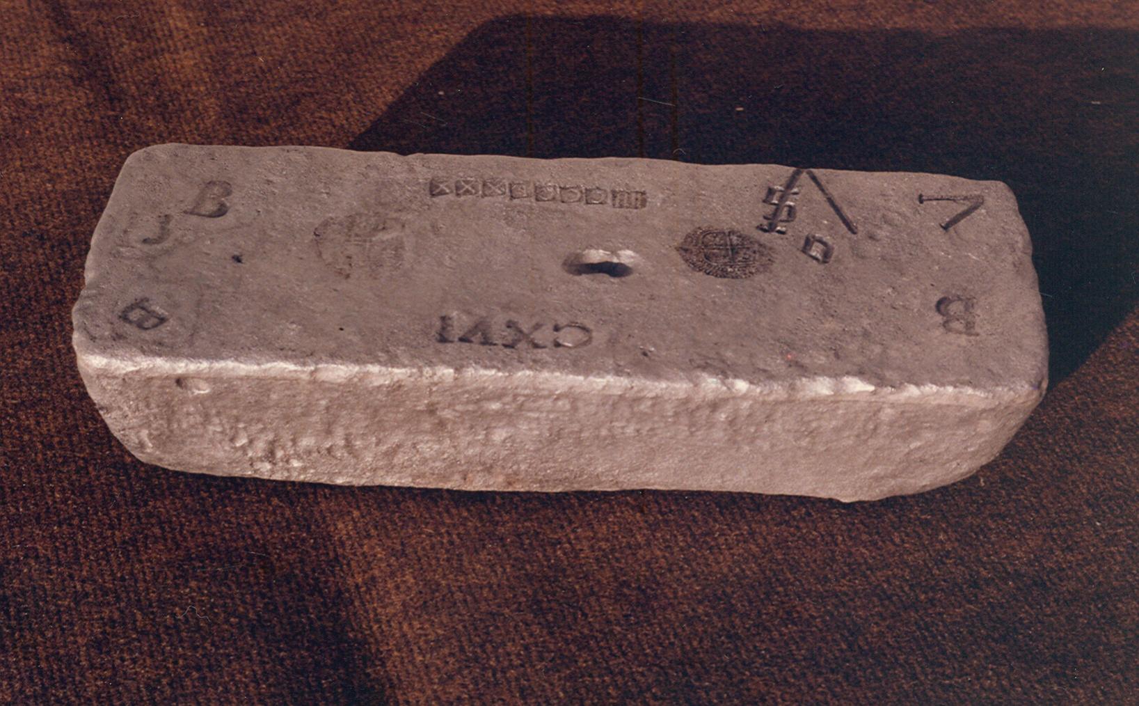

                      Atocha silver bar
                      Yes, yes, and yes.
                      Most PI designs do not attempt to flat-top the current, but it's nice to have an understanding of what's going on if, for example, you want to detect Atocha bars.
                      An Atocha silver bar of about 90 pounds.
                          Aha! So!
                          It becomes clear to me now what you did there so many years!
                          Where there is any silver in ore veins; there is a gold too.
                          And once you take it; what is the best place to keep&hide it.... CH of course!
                            Interesting Spice simulation that does show Target response verse series resistance with coil.
                            The first sim, with coil R = 10mOhm, it takes a long time for the current to peak (flat top) and the target response is greatest with largest coil current.
                            The last sim, with coil R =10 Ohm, the current peaks (flat tops) much sooner so TX pulse time can be shorter to obtain the same response.
                            These sims were with a short TC target (US nickle) and as I have stated in above posts a short TX pulse works.
                            I would like to see these same sims done with a longer TC target, US Quarter.
                            Also, why are the coil inductance and damping R different in the three sims? They should all be the same then ONLY change the Series Resistance.
                            To throw in another factor: A larger series R gets the current to peak sooner. This allows shorter TX pulse times. This then allows high pulse rate (pps) which is known to improve over all detector sensitivity IF the integrator stage has the optional values of C & R. Read posts by Eric Foster about this.
